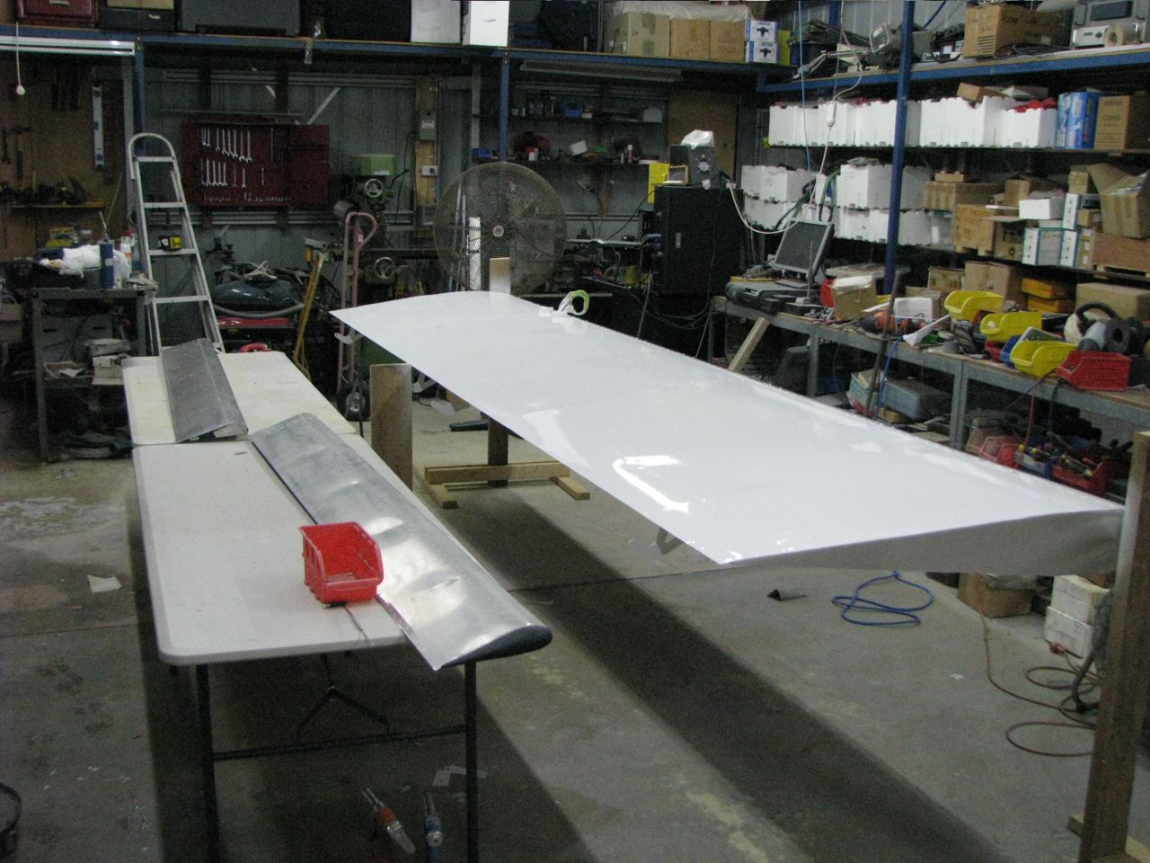

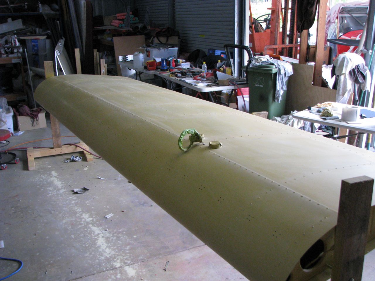

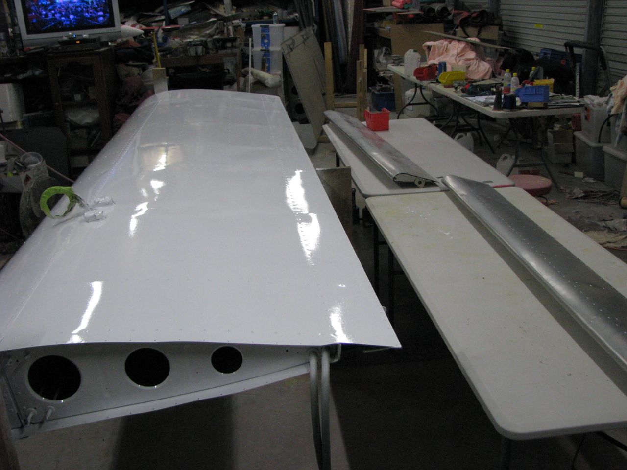

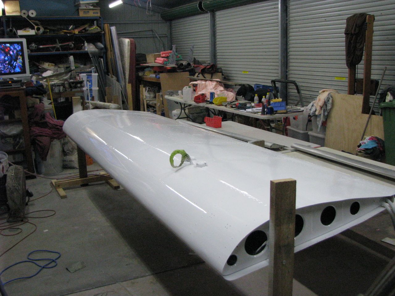

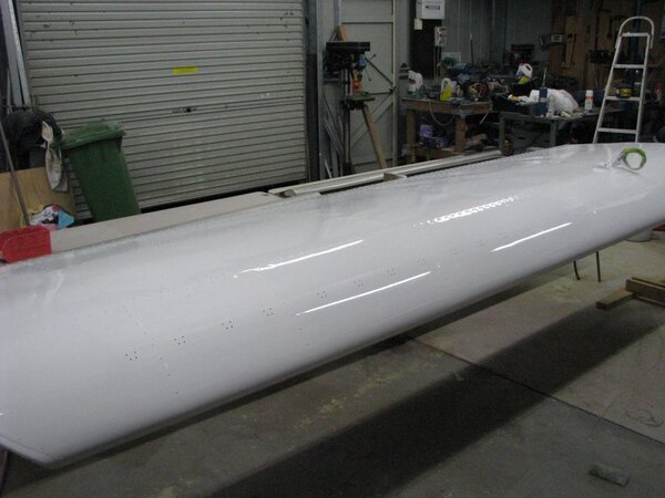

Well what a week its been. Got the right wing undercoated man this 2 pack stuff is really hard. Spent most of the week sanding the undercoat I am over this sanding because its all done by hand. The orbital sander isn't any good because the skins are light and they bend really easily so you can't get the sander to sand evenly so it was sanded with normal paper then all done again with wet and dry. The wing has an enormous surface area especially when you con side the top AND the bottom. Anyway got the white painted on this morning and its pretty reasonable have to wait a day or two now before I mask off the 2 red sunburst stripes that will be on the top. While waiting to so this the flaperons are now being worked on the tips going in and the small brackets at either end. I took the tip ribs out that face each other that join the 2 flaperons together and cut a fitted a small strengthening piece into the ends as recommended by Reg. That is all done now so its back into them with the scotchbrite and then etch then undercoat and paint all over again. then of course its the left wing and start the same process all over again. I was hoping to have the plane assembled by the end of the month but somehow I don't think so...just hope we don't have too much more rain and the days and nights are a bit cooler...been sweating my backside off this past week in the shed doing all this hand sanding.
Mark

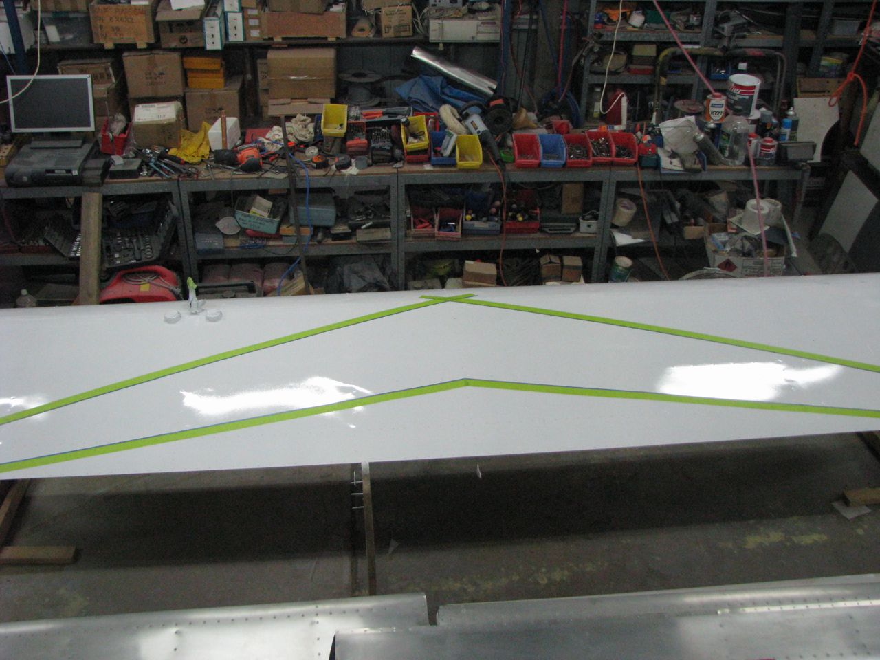

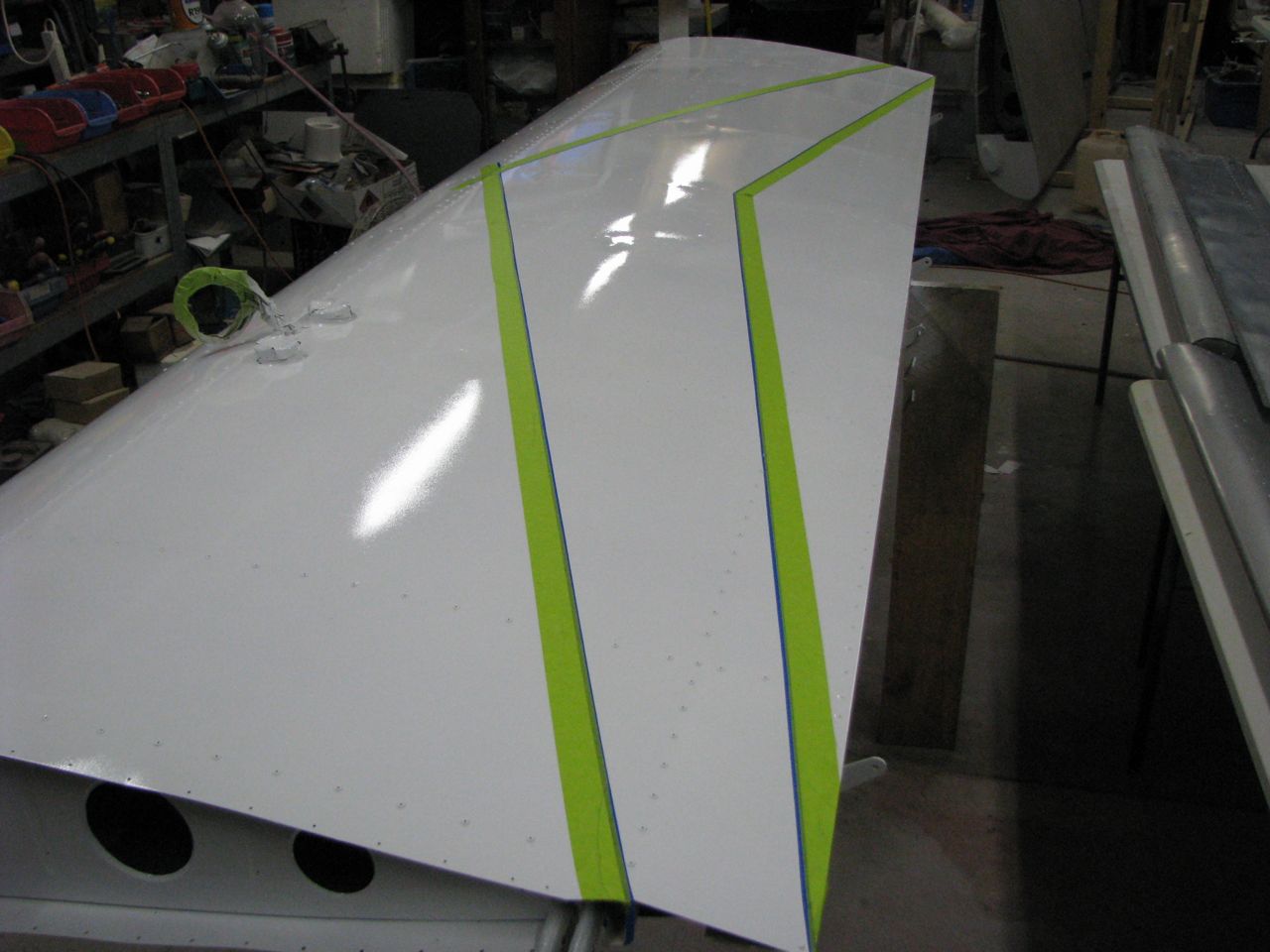

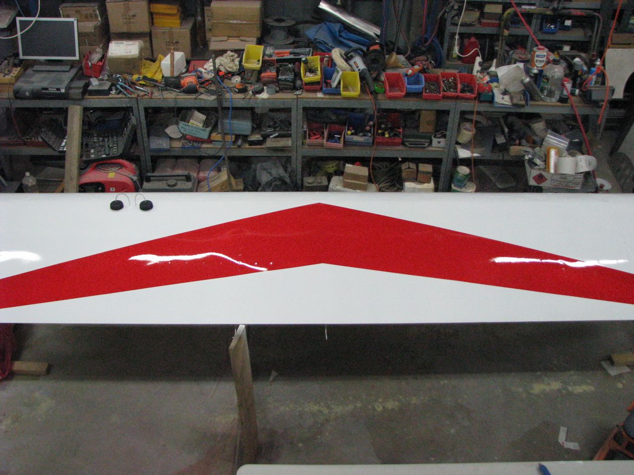

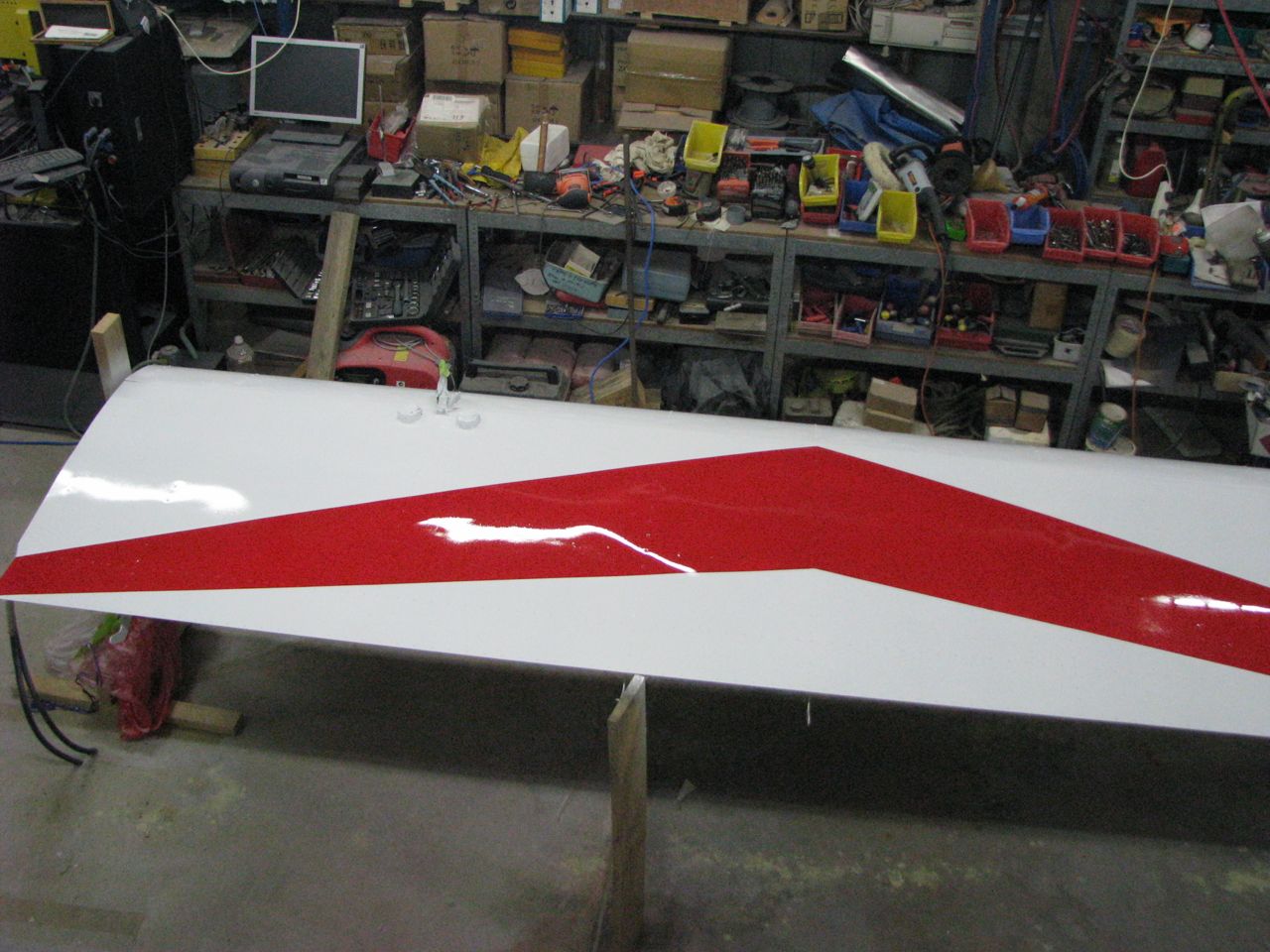

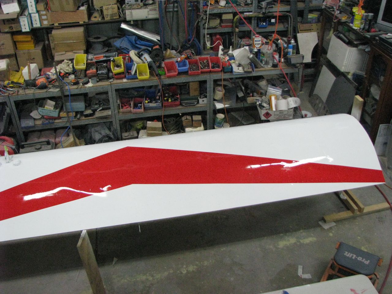

Got some more painting done this week. I was going to do a sunburst of red on the top of the wing but I decided it was going to be a fair drama so I thought about what would be easier but still have the desired effect which is to be hi-vis when turning or looking from above. So I came up with a sort of symmetrical tick which doesn't go over the flaperons so less masking and painting. It should look like a stick figure of a bird or a big M (for mark) or a W depending on your direction I suppose. I wanted to break up all the white so I am pretty happy with it but won't know until the wings go on. Still working on the flaperons have both tips installed now and have been scotchbriting them ready for some etch prime
Mark
