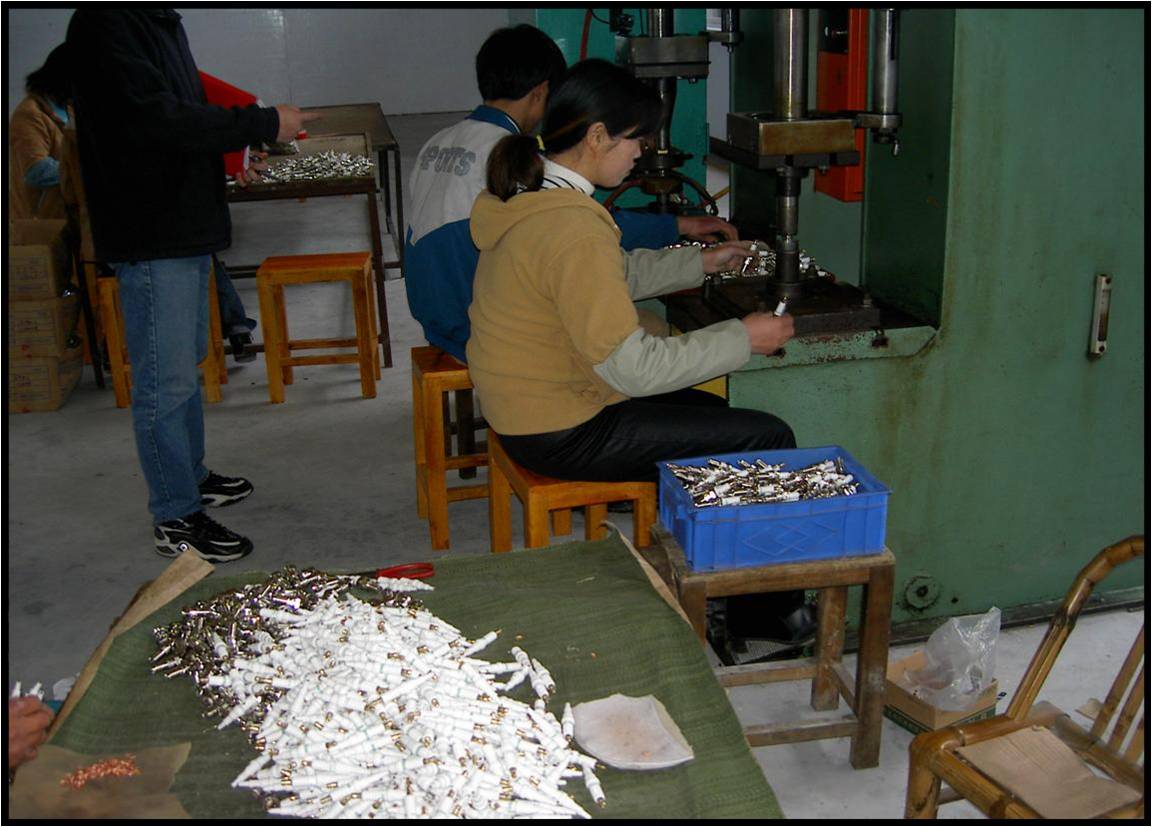

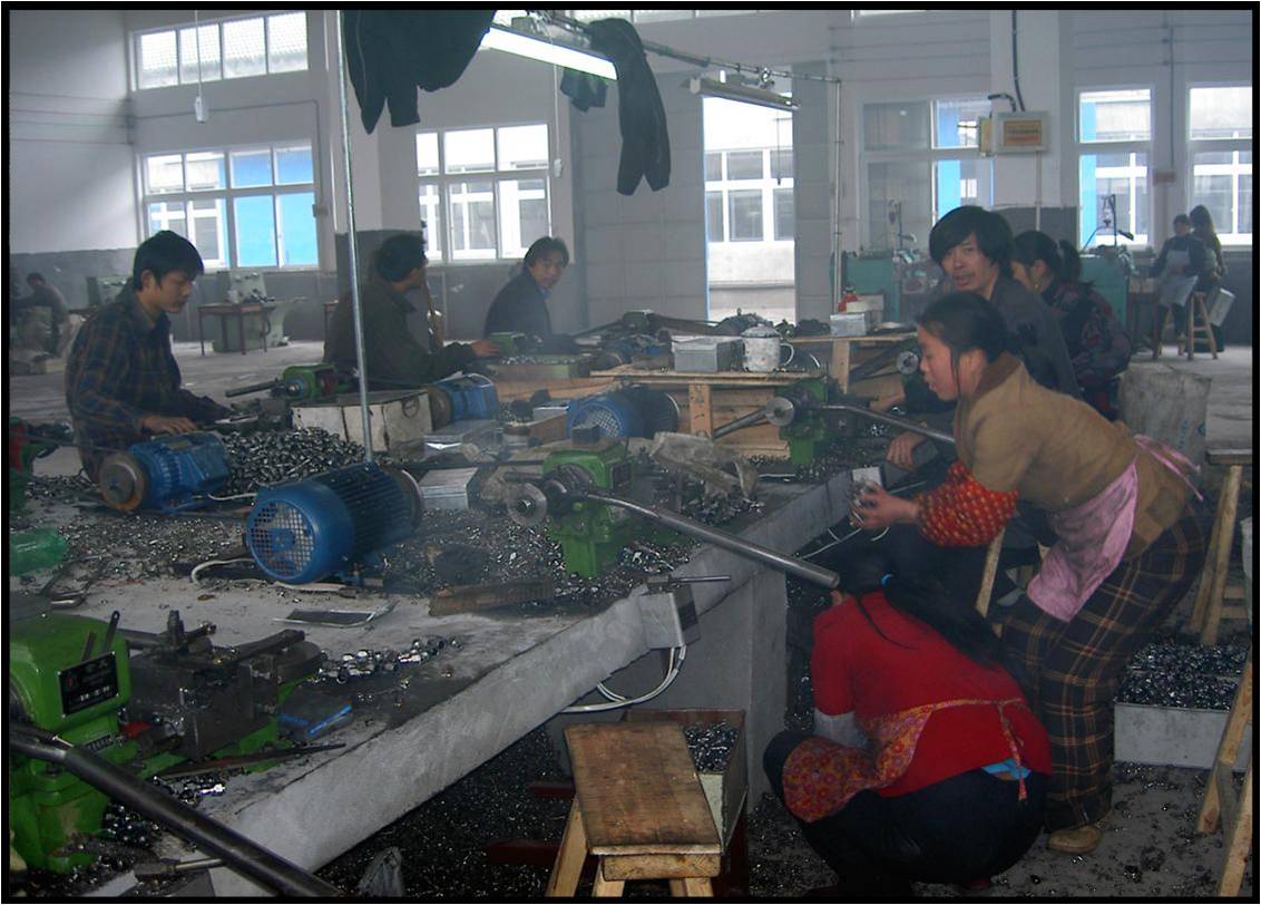

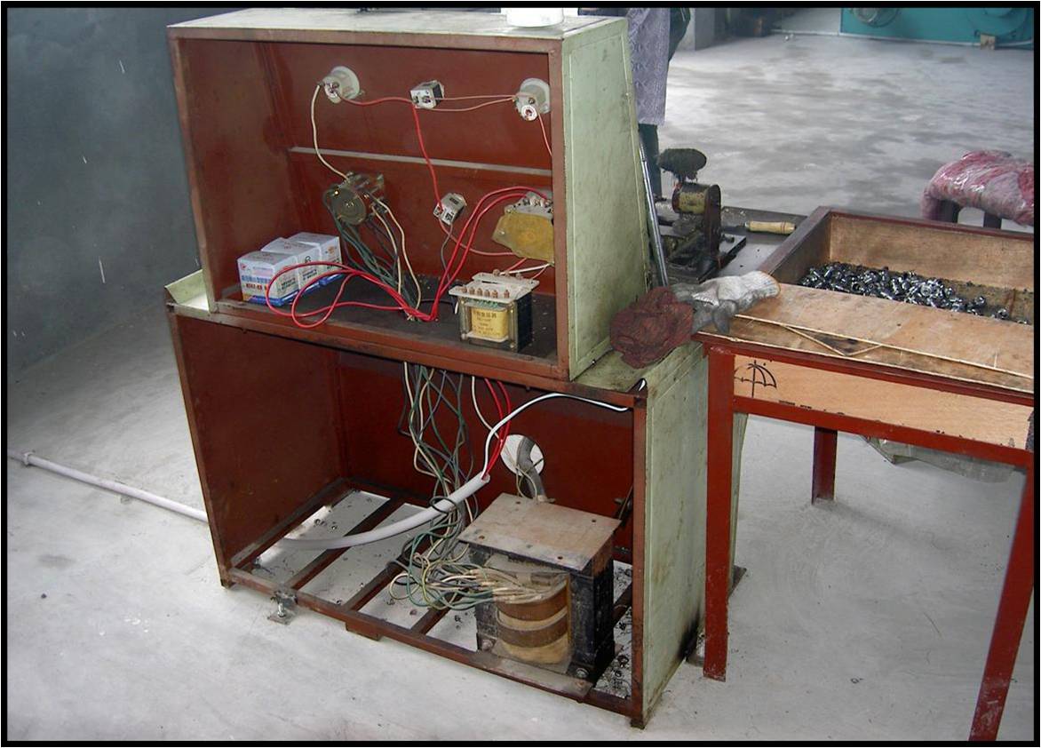

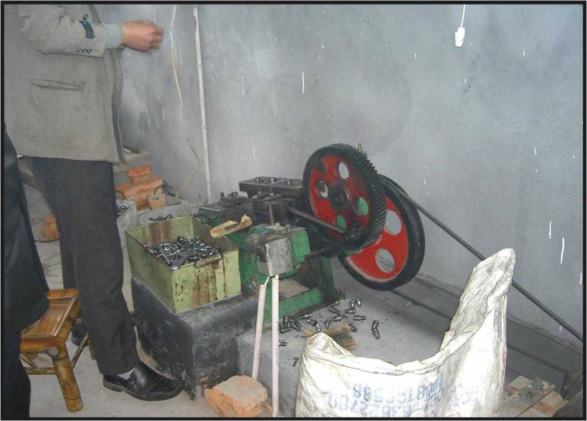

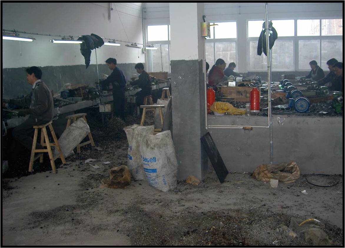

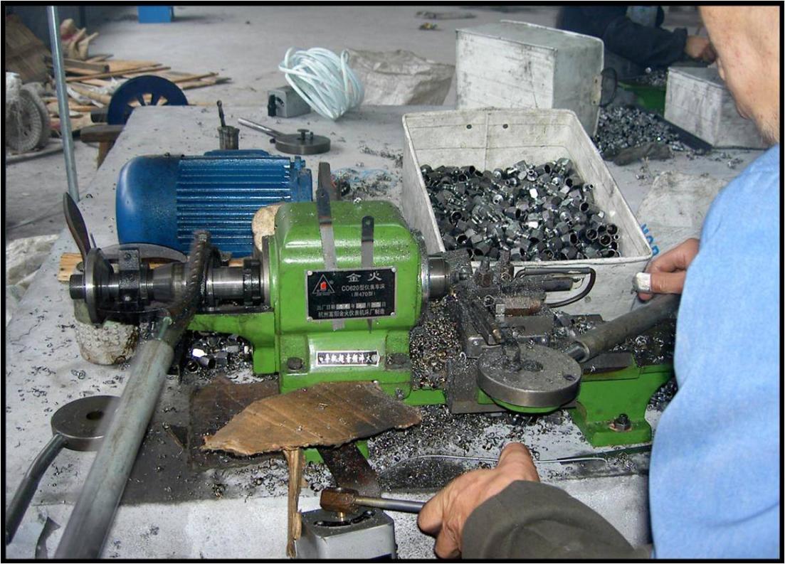

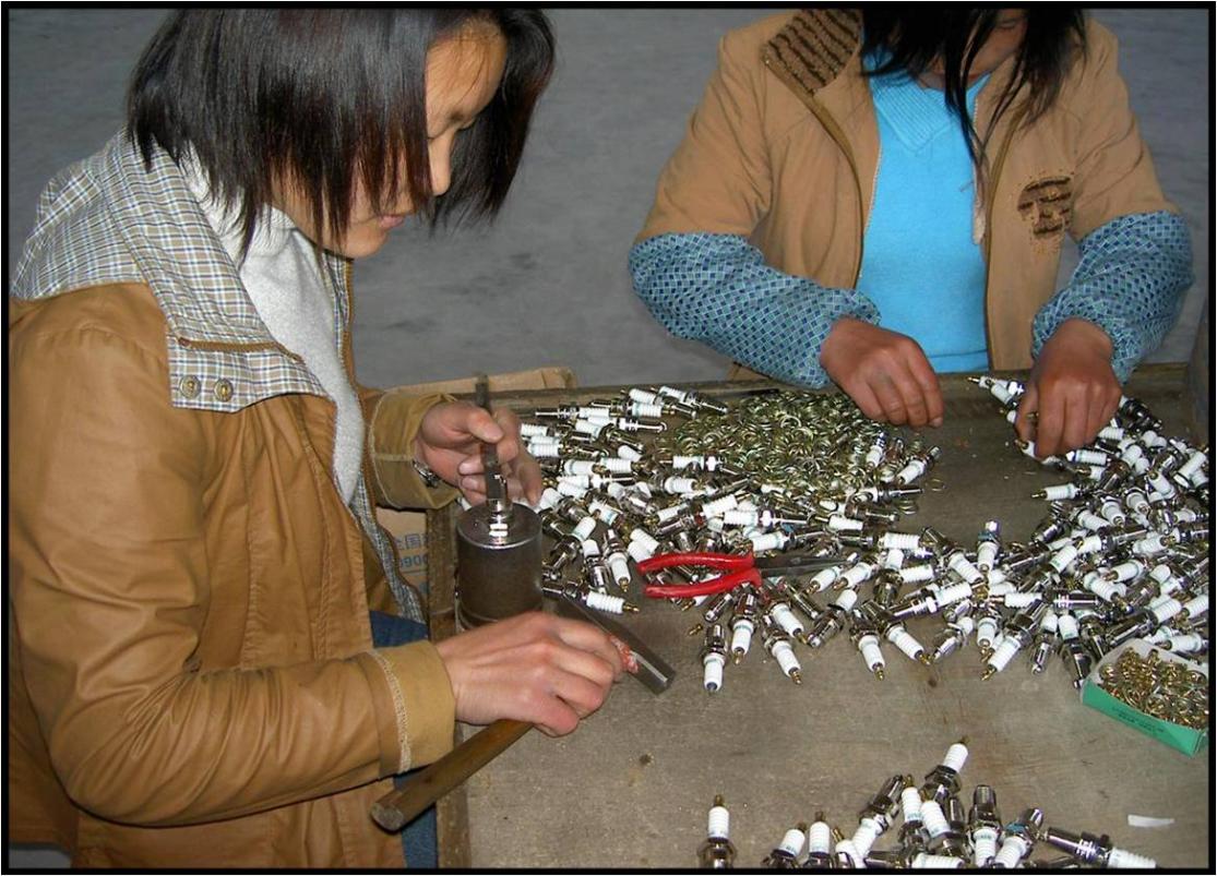

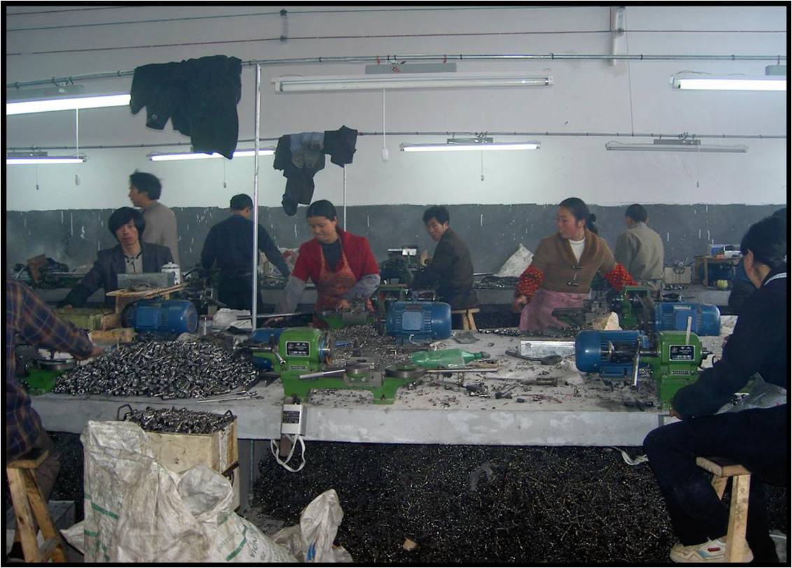

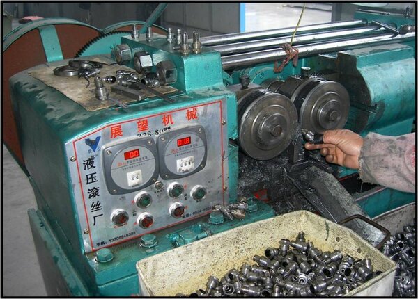

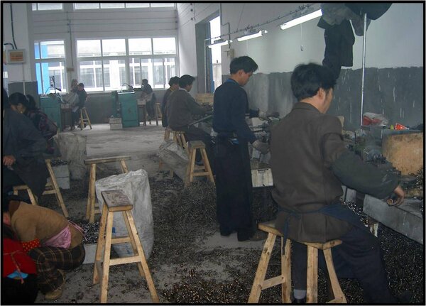

Captain Posted January 28, 2010 Posted January 28, 2010 I don"t know what you are all worried about. Once you do the research to see how Spark Plugs are made, you'll never be concerned again. See below, so you can all relax .................. Hope you find this helpful Regards Geoff [ATTACH]9788.vB[/ATTACH] [ATTACH]9789.vB[/ATTACH] [ATTACH]9790.vB[/ATTACH] [ATTACH]9791.vB[/ATTACH] [ATTACH]9792.vB[/ATTACH] [ATTACH]9793.vB[/ATTACH] [ATTACH]9794.vB[/ATTACH] [ATTACH]9795.vB[/ATTACH] [ATTACH]9796.vB[/ATTACH] [ATTACH]9797.vB[/ATTACH]           Â
Tomo Posted January 29, 2010 Posted January 29, 2010 ... :ah_oh: ... A fair bit of swarf about...!:rolleyes1: Â
Yenn Posted January 29, 2010 Posted January 29, 2010 You missed the one where they drive the insulator into the sleeve with a 4lb hammer, that used to be done by the girl with the big bandage on her thumb. Â
Guest Des Funslow Posted January 30, 2010 Posted January 30, 2010 A picture is worth a thousand words' I wonder what brand they end up as. Â
