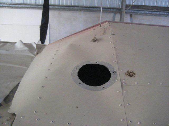

Hi Geoff yes has wing tanks they have a round inspection hole on top of wing cabin side of last full rib any help to you? cheers Phil
Hi Phil thanks for the pic, l will have to put the whole on the other side of the rib different tank hose comes out the rear of the tank.

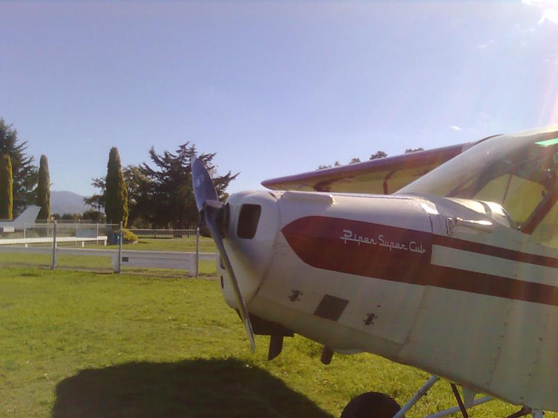

Hi EK sorry for the late respose. Thanks for your woulds of encouragement:thumb up: .Do you fly ifso what kind?
Hi Phil,
I'm really a beginner in flying: I'm doing my PPL flight training in a Piper Super Cub. But, I am seriously looking at getting a Pilot Certificate instead (because of the cost).
