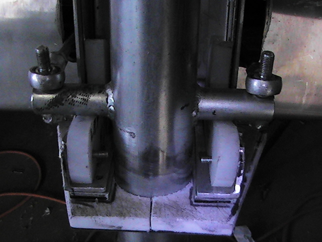

Hi Phil l got the VGs from zenair it has taken me nearly a month to completely rebuild my front end l have modified it, it will be strong now l have made it out of stainless steel, l have a 750 nose leg l have braced it up to give it strength and have nylon bushing top and bottom and on the steering rods slides.

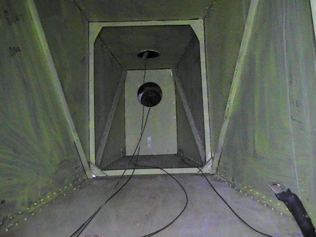

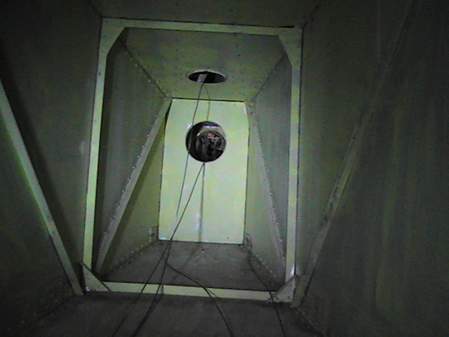

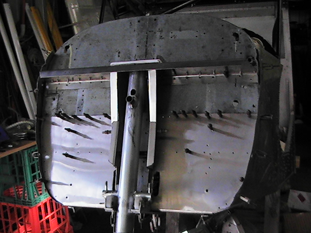

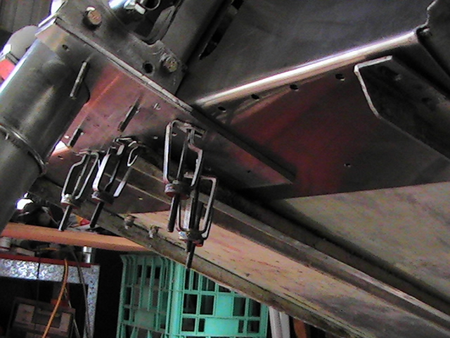

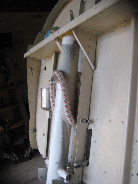

Hi Phil l got a new bungee from zenair it is small than the one that was on it l was the same couldn't get enough tension so l made a new center section move the pin with the new bungee l had to use a breaker bar to lever it on should be plenty of tension now just hope its not to much here are some pics so far not quiet finished yet still some cleaning and filing to do but nearly there.
PIC_0036.JPG.e80d28dd1fd83cd4a007c59f3163f495.JPGcheers Geoff.

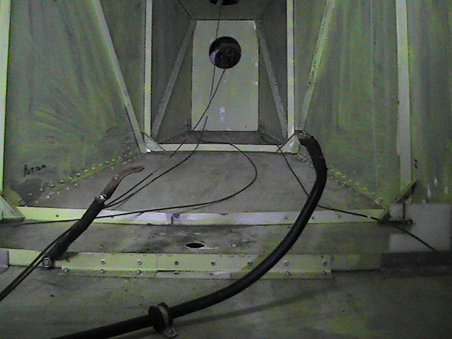

Hi Phil thank also for the pics l have some from in side the fus for you they are different how people construct of the plans

Geoff , is the bottom of the fuse bent down in your 701, the doublers where it looks like a carry through look odd?Met
Hi Mat are you taking about where the hole is, that's where they put the battery it was 8.5 kg had no extra support it has bent the doubles

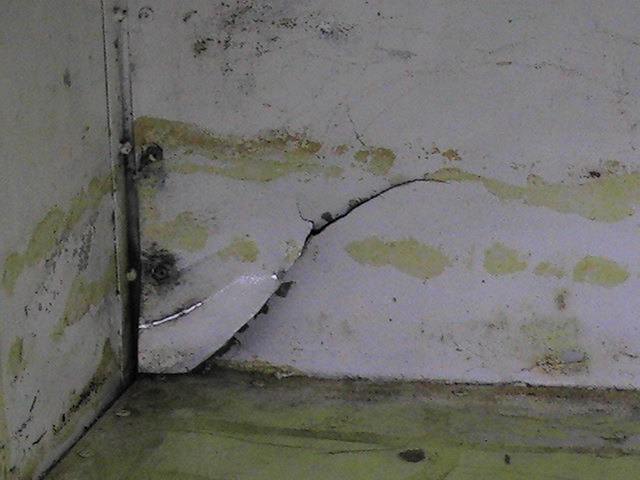

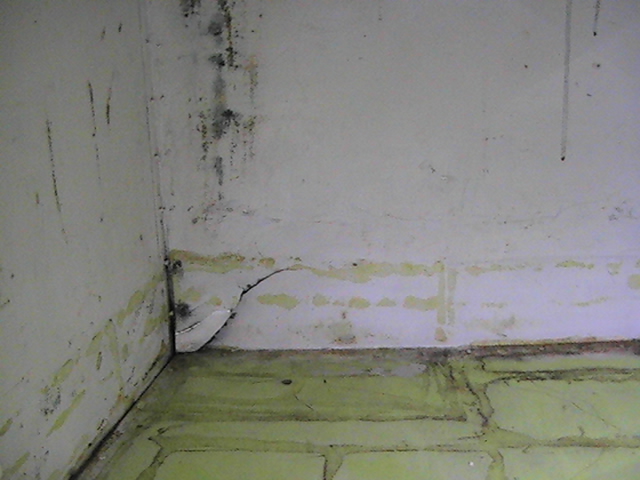

l am going to replace them l am in the process of straightening the fus it is not square the whole aircraft has been out of square some sections have been loaded up the rear of the cargo area has split, it was in tension it must have been flexing on the ground and in flight causing the tear it was hidden by the carpet .
cheers Geoff.

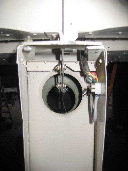

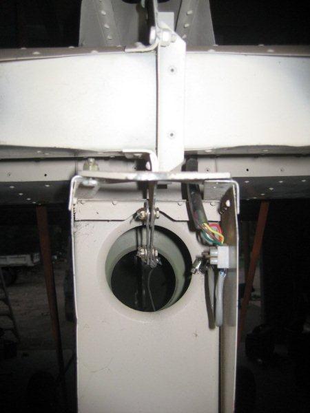

Hi Geoff how is your 701 going? I have been too busy to touch mine, might get a chance today. Took some photos of the rear fuselarge which is 3 to4 mil lower on the right hand side which made the rudder lean to the right, have put in a shim which has helped, what do you think ? Also a pic of the crimping on a cable your opinion would be appreciated.021.JPG.9b7ac38f195ce0529f044dcf4dd35cfe.JPG

Have you put a shim under the rudder hing bracket ,did you measure the rear of the fus or is it the bracket on the rudder itself it maybe on an angle.
Is the thimble on the cable hard up against the swag on the bottom looks like it in the pic needs to have movement, are they gal or stainless cables l am replacing all of mine l make them up myself l like to use stainless cable .
the swag looks alright like to swag the center of the swag to make sure l have the best grip we took some swages a few years ago to Morrabin airport for testing on there machine the cable broke and my sway stay perfect so l have done them the same way ever since.

Hi Phil l have finished make all the parts for my fire wall and nose gear and have started to rivet it all back together , will send pics when that part is done .

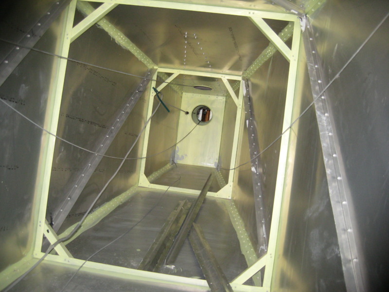

Hi Geoff have you the latest planes and cd from Zenith? On the cd the progresive photos of the fella building his 701 it shows how he has gone all around the L angles with a crimping tool and put tension in the rear fus good or bad idea do you think?
