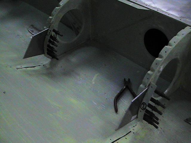

Hi Geoff have you the latest planes and cd from Zenith? On the cd the progresive photos of the fella building his 701 it shows how he has gone all around the L angles with a crimping tool and put tension in the rear fus good or bad idea do you think?
Hi Phil l don't have the CD l don't know why they would do that not sure of the benefits l know l put crimps on the radius not on flat surface.

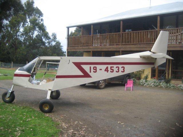

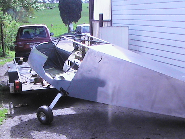

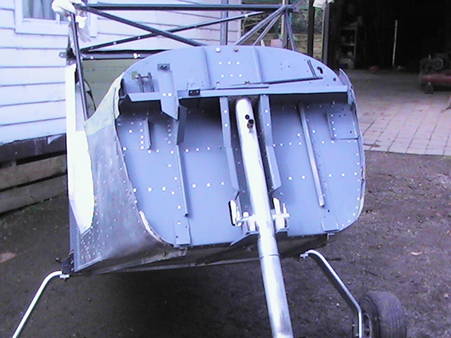

Hi Phil some pics so far fire wall is back on and new main springPIC_0152.JPG.2494befbf3382dcb5f81f6b9d97b4212.JPG
You have got some work ahead of you,picks are handy for me to look at, if I could copy the cd I will send you one theres a lot of info on it. I should have orderd a set of plans when I purchased the plane, it had the very early plans but there has been alot of upgrades since then.Going to order new cabels this week, do you get your gear from aircraft spruce or Zenith? Cheers Phil

Hi Geoff I have the latest and the early plans with the fuel tank on your lap will tray to make a copy fo the CD tonight, did you have alook at the Photo of the rear of the fus what do think?
Hi Phil the right side of the fus looks bent out and there is no stiffner at the rear l have doublers in that area.

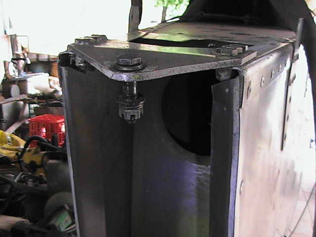

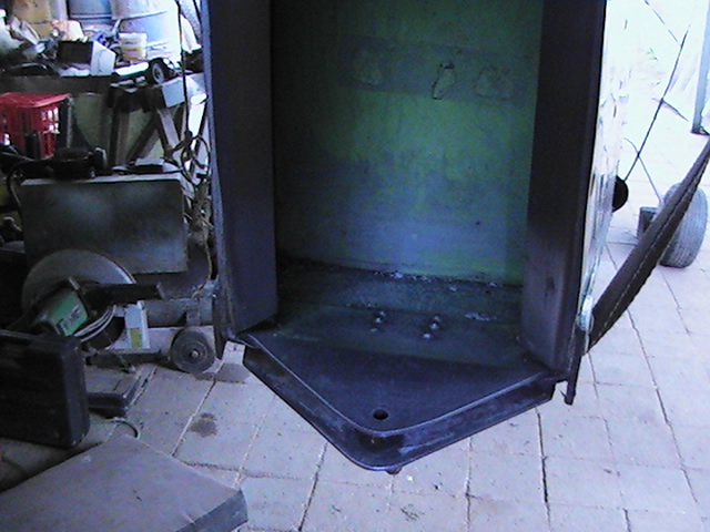

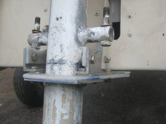

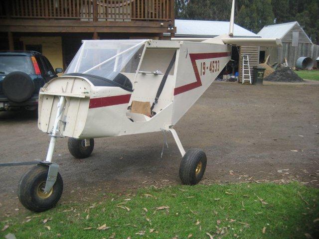

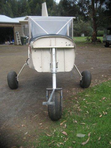

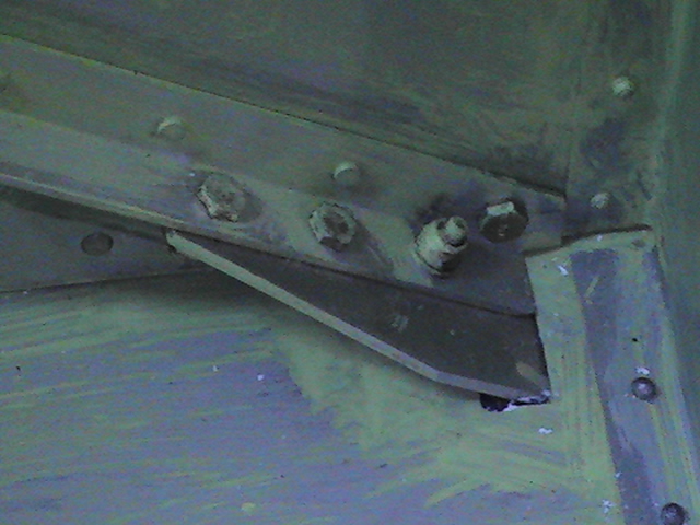

Hi Geoff thought I would take the 701 out of the shed for a airing so I can clean the shed, sick of triping over everything.I finished the bottom bearing I hope. What have you done for a seal around the steering push rods? Mine is an aluminium slide its very noisey mates Savannah is rubber i think .If you need any up dates from my latest plans I can scan and email them to you cheers Phil
Hi Phil the bottom bearing looks good do you have a bearing on top of the nose leg ,the whole air craft is coming along nicely your a bit more advanced that mine .
What stops the top of the nose leg hitting your engine mount tubes ..

What size tyres do you have on .
cheers Geoff.
Hi Geoff my tyres are 8.00 x 6, my top bearing of the nose wheel is bolted up underneath, I need to weld a stop ring on my nose leg which I'll do shortly. Let me know if you find rubber boots that will fit, I might put them on my plane. Will drill a hole in the channel for the bungy cord, an inch lower than the one that was already there, hopefully that will put enough tension on the bungy cord. Cheers Phil.

Hi Geoff the original hole what I had was whats on the plan which is 160 mm from bottom plate and the bungee is part no 1080 when you sqeeze the bungee together and measure inside you should get 12 inches which i have so I have put two new channel doublers on out of heavier metal and going to drill a hole between the bottom 4 rivets and hope it works. I spoke to Alan from Zenith Aus long time ago he had no answers because all my measurements are wright he said get a new bungee made up, its driving me mad will take some more photos tomorrow
Hi Phil
Mine is 160 mm from the plate to the center of the hole and my new bungee is 12 inches not sure why you aren't getting the tension but mine nose leg is off a 750 and is 30mm higher on the bungee attatcment tubes ,mine is real tight l just hope it is not to tight .
cheers Geoff.
Hi Geoff just done another measurement my nose leg is spot on as the plans 135mm from top of leg to centre of bungee posts and 160 from the bottom plate dont no whats going on, very frustrated cheers Phil
Hi Phil how old is the bungee might have stretched, has to be a reason.

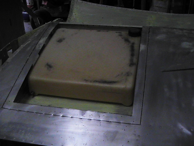

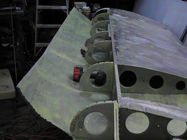

removed all the rivets from the leading ledge skin today to replace the slat brackets and cut a hole in the top skin to fit the fuel tank.

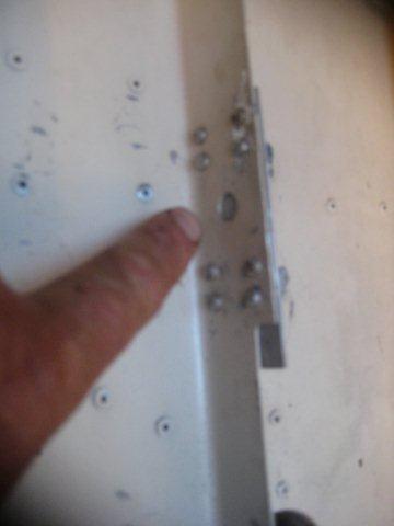

Hi Geoff bungee is brand new from Zenith .Changed ends tonight trying to replace seat stiffner 7f6-5 had to replace it ,but no way is the new one going to go back easy cant see how i can get it back with out cutting it in half.Do you think i could put a sleave to join it cant see how i can do it with out dismantleing heaps.Some happy snaps of your wings with the leading edge off would be great. cheers Phil

why do you have to replace the 7f6-5 have you removed the old one .

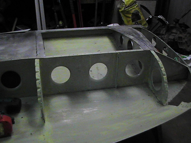

Hi Geoff had to take it out, previous owner had put a kink in it.Made up a sleeve so heading out to the shed see if i can get it in before tea if you look at the Zenith website they have a listing of all the upgrades you mite find something thanks for the pics Cheers Phil
Hi Phil just take the kink out and put a doubler there should work fine ,l will hear from you after tea see how you went.
