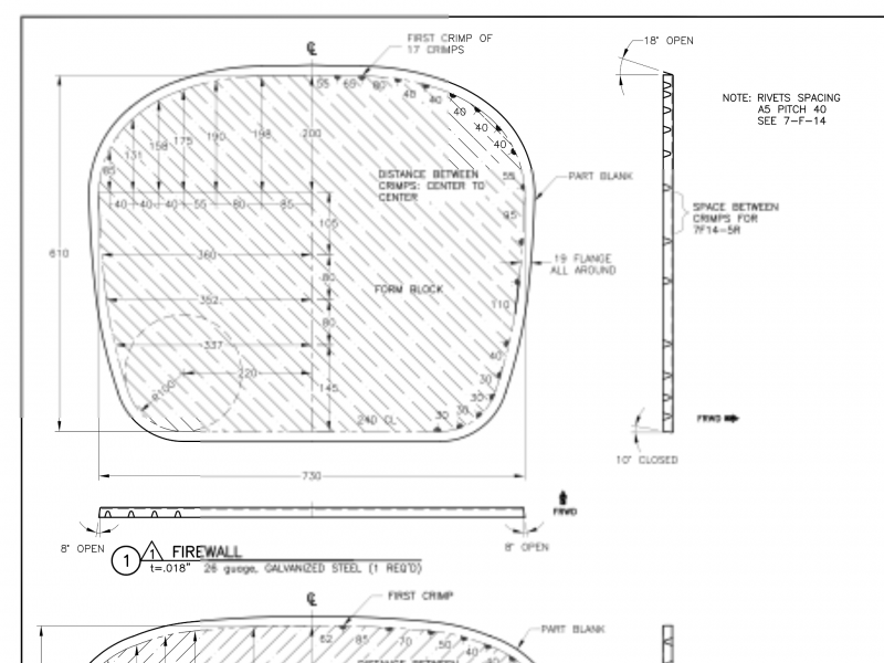

Hi Rick
What Page number is that on your plans ? Went through my two sets of plans old and new cant find that page.Measured my fire wall again with glasses on this time and got 720mm.
cheers Phil

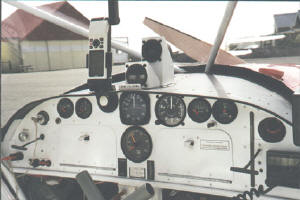

The best handling notes I've seen - although dated - here
CH701 STOL
Classic quote from that site, not particularly a handling issue:
"Glove boxes are more important than silly dials!", insisted my wife.
