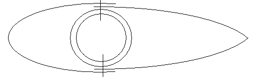

I bought all the round tube for the struts so will probably use them unless another set of Sav ones comes up. Had thought of adding bent 0.016" 6061-T6 front and rear to form an airfoil shape,
but shying away from the idea of riveting to the strut in case it weakens it.
