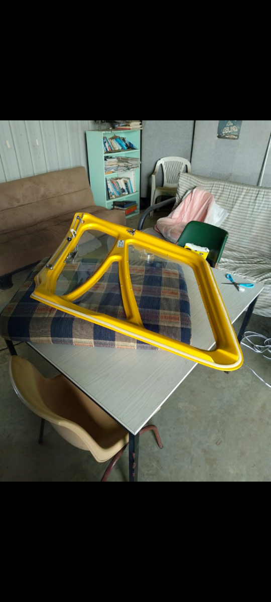

danny_galaga Posted 18 hours ago Posted 18 hours ago I can't remember where the hell I put my thread about stopping co ingress in my plane. But here's the latest. I put light open cell weather strip around the door edges. The doors on the Bushcat are not a brilliant fit so the gap varies a lot. Using 6mm open cell allows for a high tolerance. And it seems to have worked. The amount I can smell is a LOT less. Nev pointed out a lot of planes pull fumes up via the opening near the tail wheel. That would be my next point of attack. But the doors were a lot easier to do 😄 3

danny_galaga Posted 10 hours ago Author Posted 10 hours ago 4 hours ago, skippydiesel said: " I put light open cell weather strip around the door edges" If its the stuff from Bunnings Aerospace, you will be lucky to get much more than a season out of it. Next time get closed cell - far more durable & won't hold moisture and retains it shape better. Lots of suppliers but if close to a "Clark Rubber" they usually have a very good (but pricey) selection. You will need to know the width, depth & how long (they sell by the m). 😈 I deliberately used open cell because the gap varies a lot around the edge of the doors. With closed cell, the doors would be impossible to close. It's about $7 a roll. If I have to replace it once a year it's no big deal. 1 1
