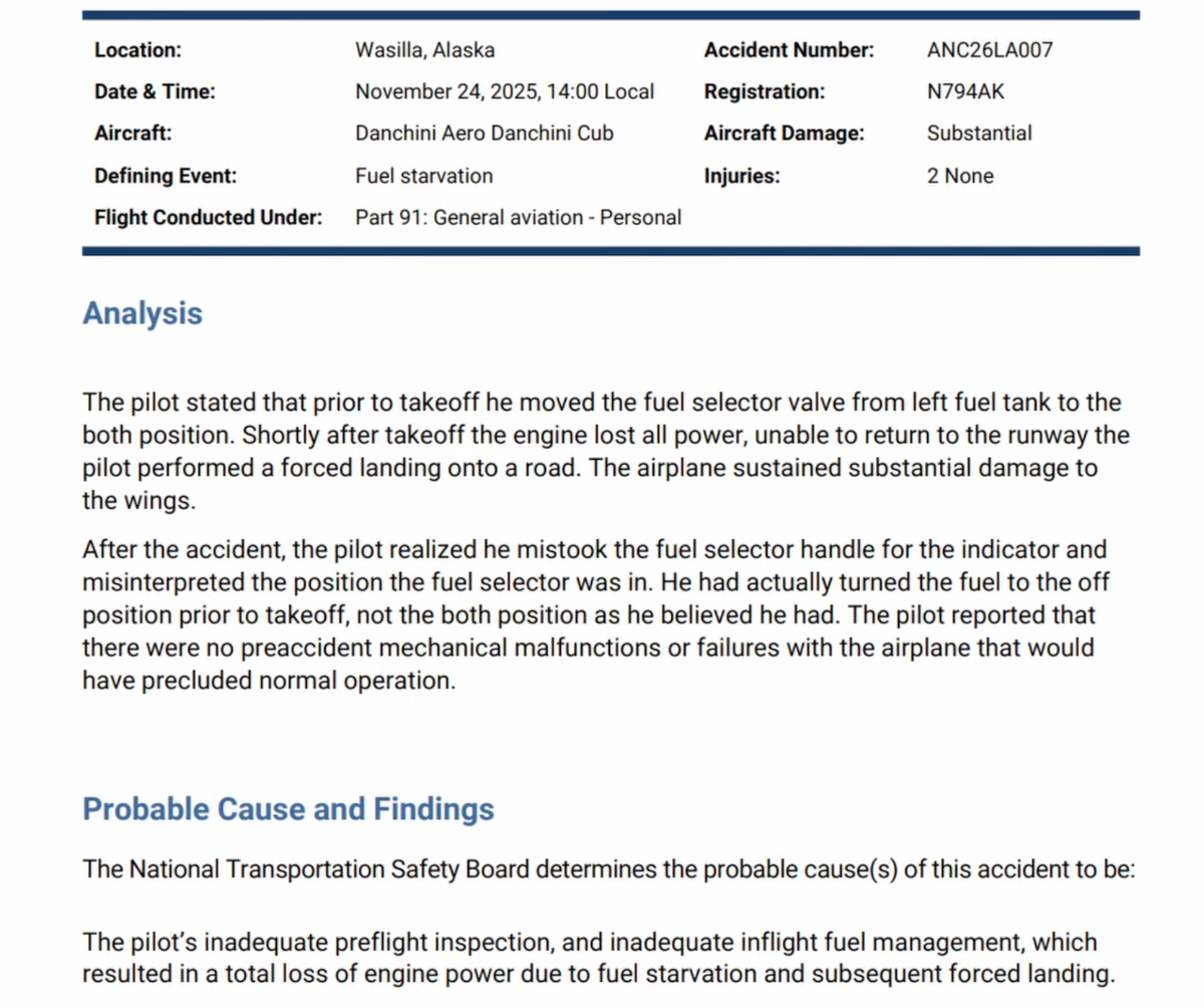

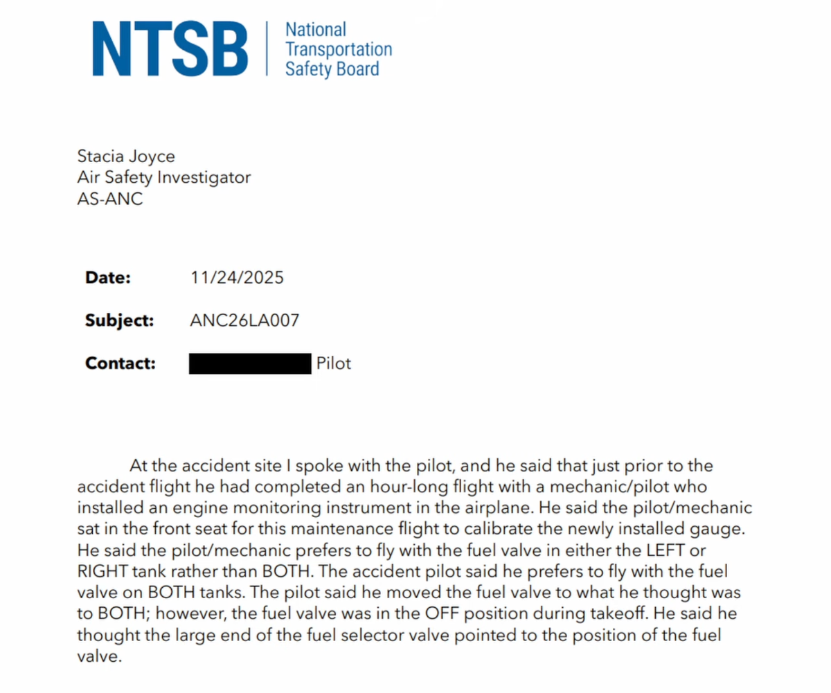

Garfly Posted June 30 Posted June 30 Yet another fuel turned off at take-off event recorded and analysed for our instruction. https://www.youtube.com/watch?v=EjC0WoyDHvA [These 'thumbnails' of key screenshots from the video need clicking to be clear. ]
facthunter Posted July 1 Posted July 1 Not knowing which end is the Indicator has fooled a lot of People. The Pass mark in fuel management is 100% for a good reason.. The wrong selection takes a while to register. A short taxi time is a trap.. IF you DO change it just prior to commencing take off. you are at risk of JUST getting into the Air. Perfectly good aeroplane jeopardised. Selecting ALL with some systems can introduce Air into the System. IF a tank is Low. Nev 1 1
