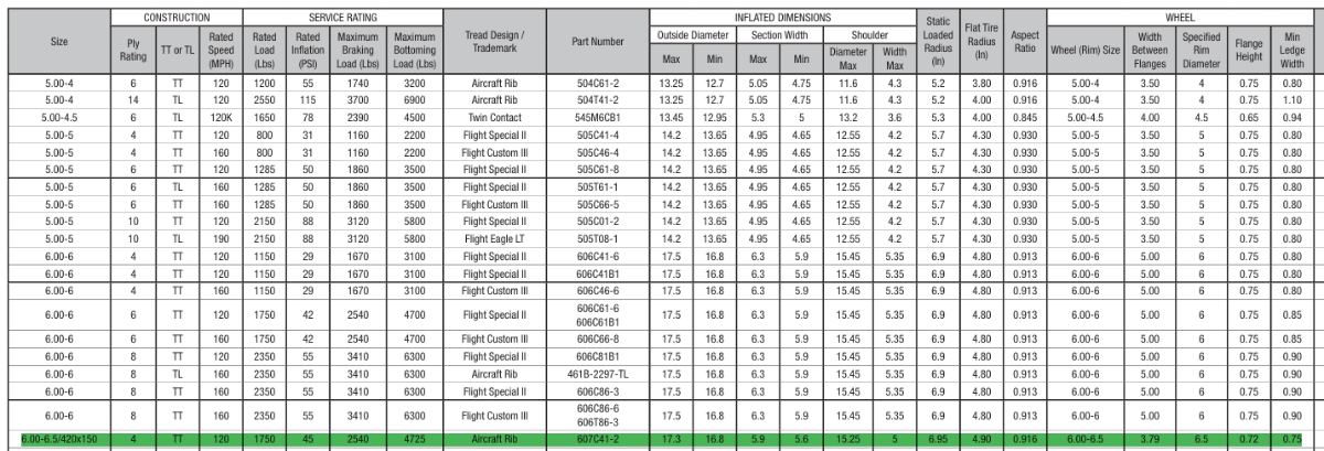

Kia ora. Goodyear tire chart
I think your wheels are 6.5 inch dia - Chipmunk yes
You are probably better off getting new common size wheels and tyres and brakes, depends on what your axles are, they were probably custom made off the plans with minor variations to suit the wheels found at that time. Anything modern probably won't fit your axles. Jodel axles - are welded to the leg?
