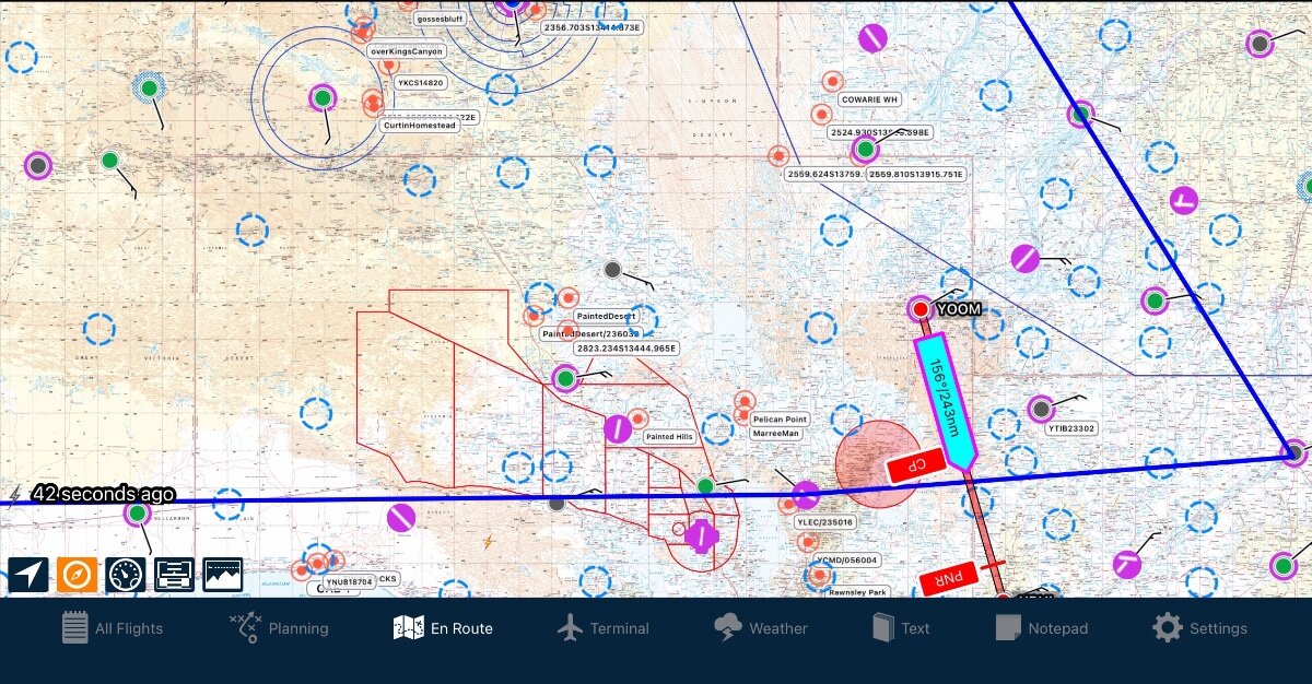

Love to fly Posted 18 hours ago Posted 18 hours ago Avplan has a satellite map, and also terrain. We consider arrying a satellite device like a Zoleo when you are remote essential. It allows 2 way SMS and email communication. Also let's our designated contacts track us. ADSB coverage is good, but not everywhere yet. Also, Moomba is definitely within a DRA. 1
Love to fly Posted 18 hours ago Posted 18 hours ago (edited) AvPlan with blue boundary for DRA Edited 18 hours ago by Love to fly 2

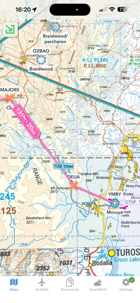

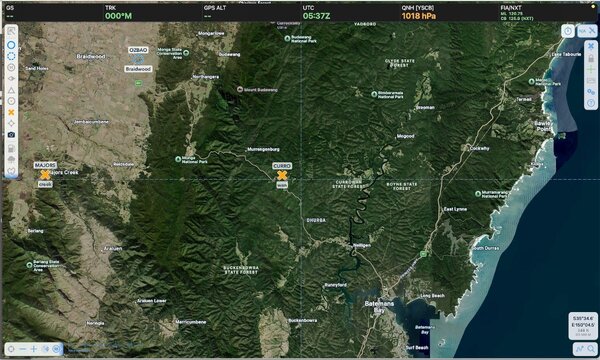

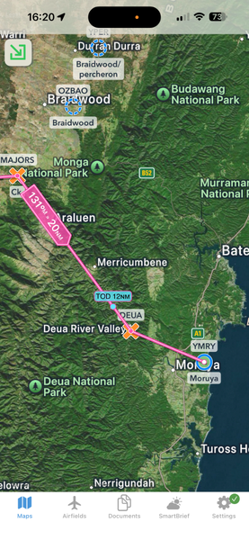

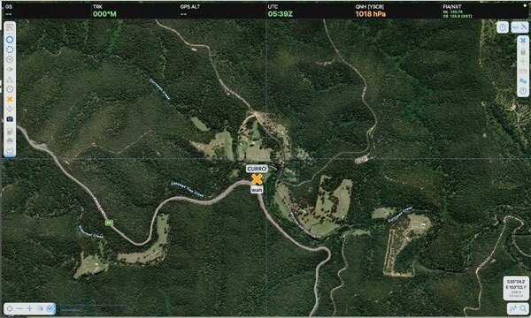

Moneybox Posted 9 hours ago Posted 9 hours ago On 26/2/2026 at 8:33 PM, BurnieM said: As well as Ozrunways having this view I believe Avplan has something similar. Garmin Pilot gives you a satellite photo similar to above but only around an airfield and you can scroll it around. GP does not let you display this as your map layer with flightplan on top. GP gives you Openstreetmaps as a map layer with detailed airfields, airspaces and topo shading (but not heights). GP also gives you a Terrain height database. This is used for flight profiles and also to overlay on a map Red (within 500ft) and yellow (within 1000ft) I generally plan on Openstreetmaps, check my profile for MSA and switch to VFR charts for flight. What EFB do you have ? I’ve got OzRunways premium subscription but I have a lot to learn. These last few days working through Stuart Maddigan’s chapter 10 has taught me a lot.
