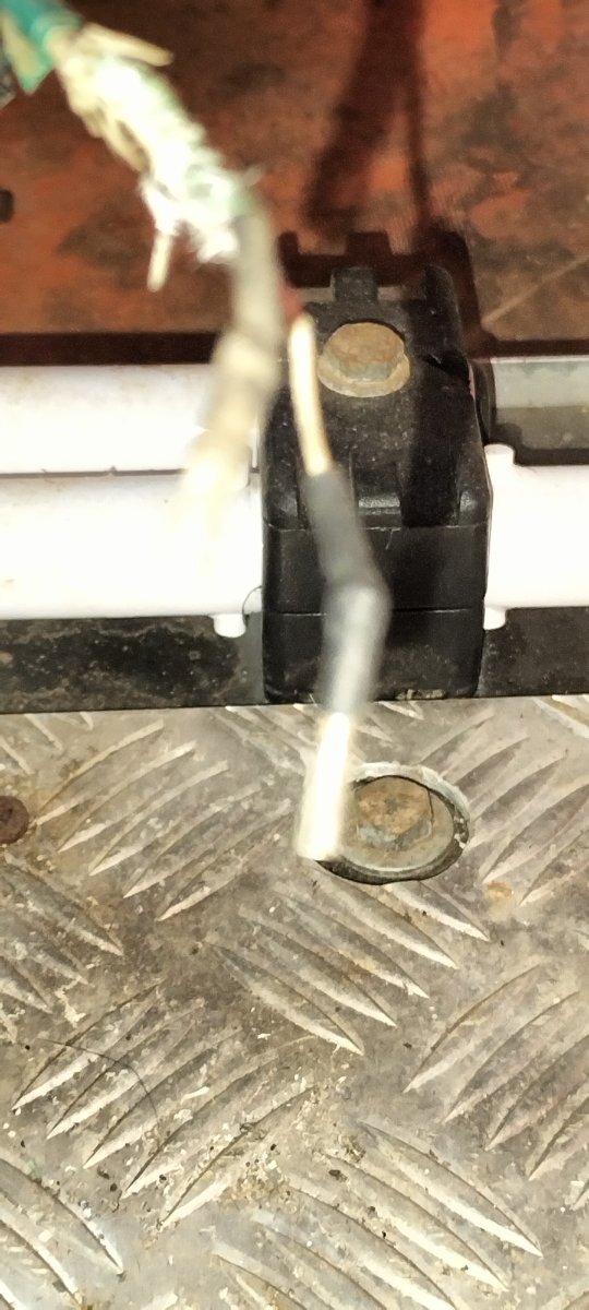

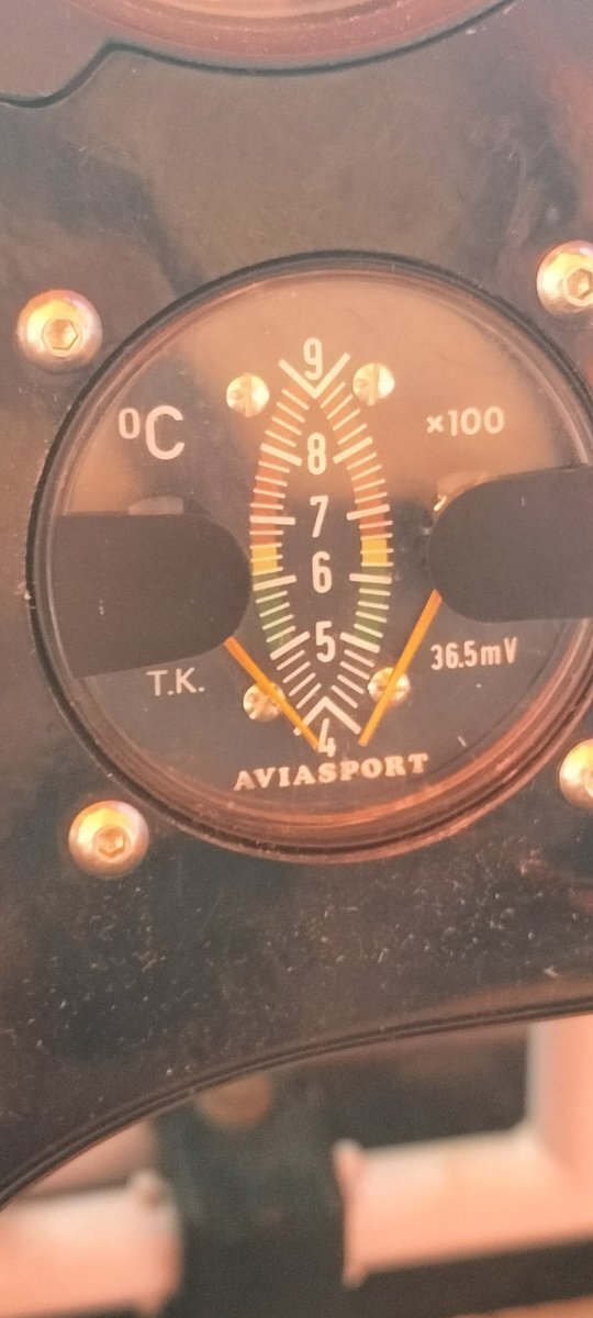

BrendAn Posted January 31 Posted January 31 My egt wiring has 2 broken connectors. These instruments work on millivolts so I think I have to buy new probes because it would be difficult to replace the ends. Am I right or wrong.
onetrack Posted January 31 Posted January 31 (edited) I have never seen just the ends available, they only come complete with wiring. They're more correctly called thermocouples, although they're often described as probes. Use "thermocouple" or "EGT probe" for search terms. https://www.aircraftspruce.com.au/search/search.php Edited January 31 by onetrack 1 1
Thruster88 Posted February 1 Posted February 1 Aircraftspruce australia has them in stock if your manifold has the 8mm boss's welded in it. I have never had much luck with egts lasting in the thruster. Correct jets and a fuel pressure gauge has worked for me over a very long time. 1 2
BrendAn Posted February 1 Author Posted February 1 1 hour ago, onetrack said: I have never seen just the ends available, they only come complete with wiring. They're more correctly called thermocouples, although they're often described as probes. Use "thermocouple" or "EGT probe" for search terms. https://www.aircraftspruce.com.au/search/search.php I know what they are o/t. Just wondered if anyone had replaced the ends on them. I realise I will probably have to get new probes. And yes aircraft spruce are the place to get them. Only 15 minutes from my flat. 1 1
BrendAn Posted February 1 Author Posted February 1 2 minutes ago, Thruster88 said: Aircraftspruce australia has them in stock if your manifold has the 8mm boss's welded in it. I have never had much luck with egts lasting in the thruster. Correct jets and a fuel pressure gauge has worked for me over a very long time. These were working but the wiring kept falling off the back of the gauge. Thought I would crimp them a bit but the ends broke. Very old and brittle. 1 1
