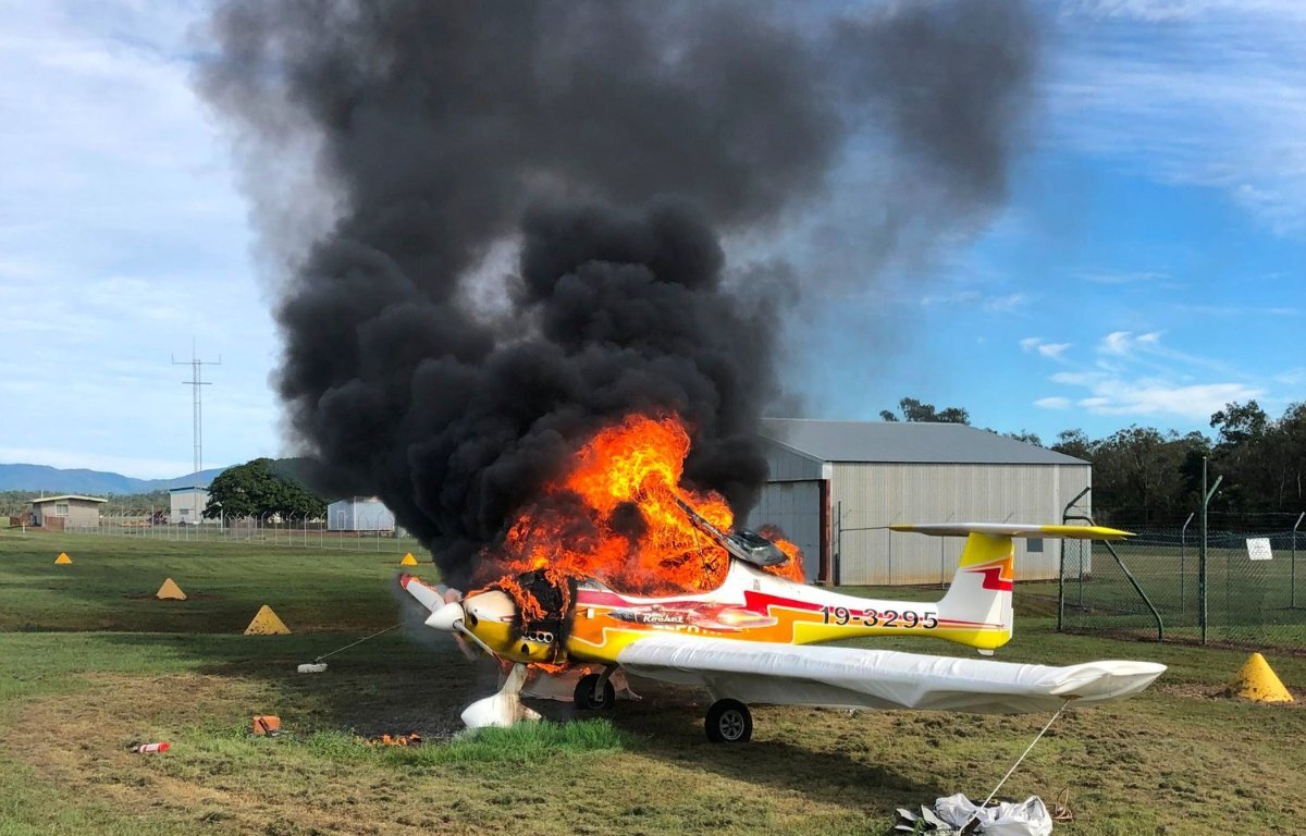

Blueadventures Posted 6 hours ago Posted 6 hours ago (edited) Don't fly while dripping fuel leak under a plane, back fire on start up, small pool of evaporating fuel and light breeze wrong way and you have a fire possibility. Happened at Proserpine to an RAA aircraft a few years back. I don't like the push up steel (get rusty) ones, not uncommon to leak and need replacing. Edited 6 hours ago by Blueadventures 1 1
