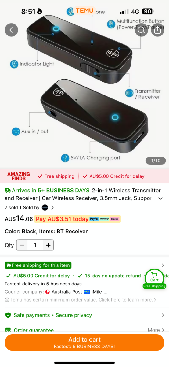

Barrynel Posted December 6, 2025 Posted December 6, 2025 15 hours ago, skippydiesel said: More details please. Photos would be great. What traffic system are you running?😈 I bought a standard Bluetooth transmitter with an av input, i then ran a av cable with one end where i cut the plug off and soldered the two wires into the microair radio plug as it gives you audio in just check the connection diagram, and the other end plugged into the receiver. I pair my I pad with the transmitter after which avtraffic will make announcements over your headsets, the radio will also mute when you receive a radio transmission. Unfortunately you can only connect one devise at a time thru the bluetooth. I also subscribed to avtraffic , but you need to open ozrunways thru avtraffic in order to hear the announcements 1
skippydiesel Posted December 6, 2025 Author Posted December 6, 2025 Barrynel, You are not communicating with "the sharpest tool in the shed" especially when it comes to electronics. So a few questions; "I bought a standard Bluetooth transmitter with an av input,... What is a "standard Bluetooth transmitter with an av input,... ". ? I understand that a Bluetooth devise must receive a signal from?? to act/show data. Is "av" an abbreviation of aviation or something else? How is the device, you seem to have modified, diffrent to the crop of aviation headset Bluetooth adapters, that are currently available? "i then ran a av cable with one end where i cut the plug off and soldered the two wires into the microair radio plug as it gives you audio in" This reads like you have hardwired your Bluetooth into your transceiver?😈
Barrynel Posted December 6, 2025 Posted December 6, 2025 Hi Skippy you can buy an audio cable at any place,the small plug go into the bluetooth unit and the other end gets cut of and the two wires get hard wired (soldered)into the radio plug 1
onetrack Posted December 6, 2025 Posted December 6, 2025 Skippy - "AV cable" refers to an "Audio-Video cable" - a cable capable of carrying audio or video signals. 1
Thruster88 Posted December 6, 2025 Posted December 6, 2025 2 hours ago, skippydiesel said: How is the device, you seem to have modified, diffrent to the crop of aviation headset Bluetooth adapters, that are currently available? "i then ran a av cable with one end where i cut the plug off and soldered the two wires into the microair radio plug as it gives you audio in" This reads like you have hardwired your Bluetooth into your transceiver?😈 Bluetooth device receives wireless audio from iPad or phone or tablet. Bluetooth device then sends audio via wires directly to the headset jacks or it can be wired to intercom/vhf radio that is connected to headset Jack's. Have you ever paired a Bluetooth device to your phone or tablet? 1 1
skippydiesel Posted December 6, 2025 Author Posted December 6, 2025 28 minutes ago, Thruster88 said: Have you ever paired a Bluetooth device to your phone or tablet? Yes. In all my Bluetooth "pairing" to date, ithas been between devises so capable. I am now contemplating empowering my non Bluetooth David Clark headset, with a Bluetooth adapter. My confusion arises from; Barrynel's system which seem to involve hard wiring. The systems I have been looking at are - plug headset in male jack/ female end of Bluetooth adapter - Bluetooth adapter plugs male jack into female panel socket of Comm system. Bobs Your Uncle, we now have a Bluetooth connection (subject to pairing) with iPad running AvTraffic alerts (have Barry's phone number so will call for enlightenment)😈
