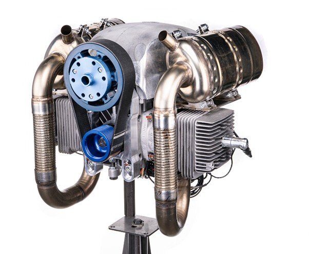

You don't have space to fit the Hirth system?
If not are you looking at pipes only or pipe and muffler?
