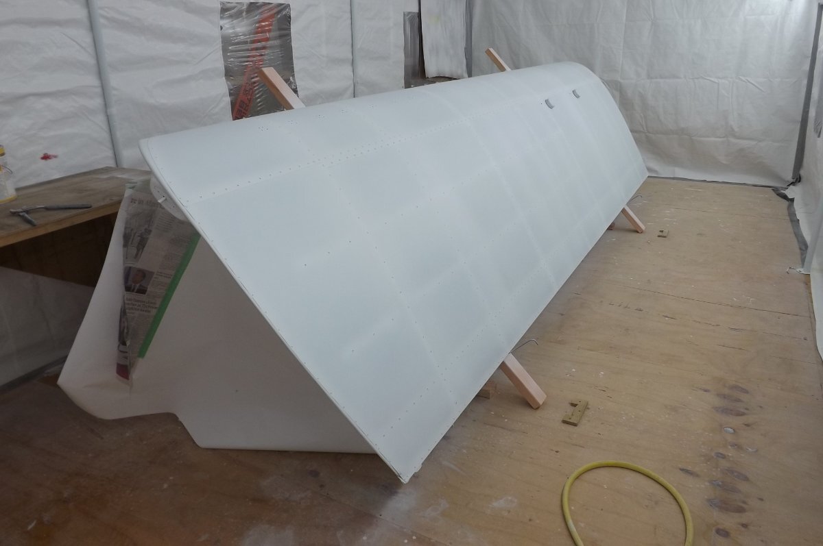

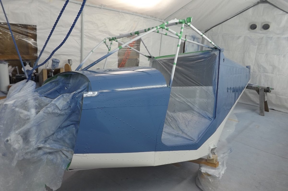

IBob Posted October 28, 2025 Posted October 28, 2025 Hi Marty, I have very limited spray painting experience and set about it with real trepidation. I managed to get a good finish, though I did have to wash off one wing side that went on too dry. My setup was as follows: A Supercheap car parking tent set up inside my workshop, with the bottom edges duct taped to the floor. At the far end, two 150mm domestic extractors (as used in kitchens and bathrooms). These had no ducting, went straight out through the tent and (ply) workshop wall. The pilot who donated these had used them with a long length of ducting and said they were useless like that. I had no trouble, so I think it's worth noting that spiral ducting may greatly reduce airflow over any distance. I painted in winter, so at the near end I had a hole in the tent where I placed an oil filled radiator. I would turn on the fans, which provided a very gentle airflow, turn on the radiator and watch the temp rise in the tent where I had a cheap thermometer. When the temp rose to about 23' I would suit up, turn off the radiator, go in and mix the paint and spray. The temp would continue to rise a bit due to the residual heat in the radiator. For lights I had fluoro strip lights all down one side , with DIY foil reflectors behind them. I thought this would be more than enough in a white tent, but it wasn't. The only way you can see how you are doing is from the reflection of bright light in the surface, and to get that without having to walk round the job and view it at various angles, you need lights on all sides. Simply put, you can't have too much light. I made simple tilting mounts for the wings so that the surface was angled towards me at about 45'. This is a big area to spray, and I found it far easier to work the gun with the job tilted towards me that way. I did not have the confidence to spray both sides , so the wings were each done in two sessions, one side then the other. I partly rotated the fuselage for the same reason, and that was painted in 4 sessions. I found with the colour on the fuse it was really easy to see the finish, compared to the white on the wings etc, where I had to paint then walk round the job squinting at odd angles to get a good reflection. You haven't got much time to be doing this, and the less you move around the less dust you disturb. For all the smaller parts, empennage etc, I also went to some trouble to set them up so I wasn't trying to use the gun at odd angles. 5 2 1

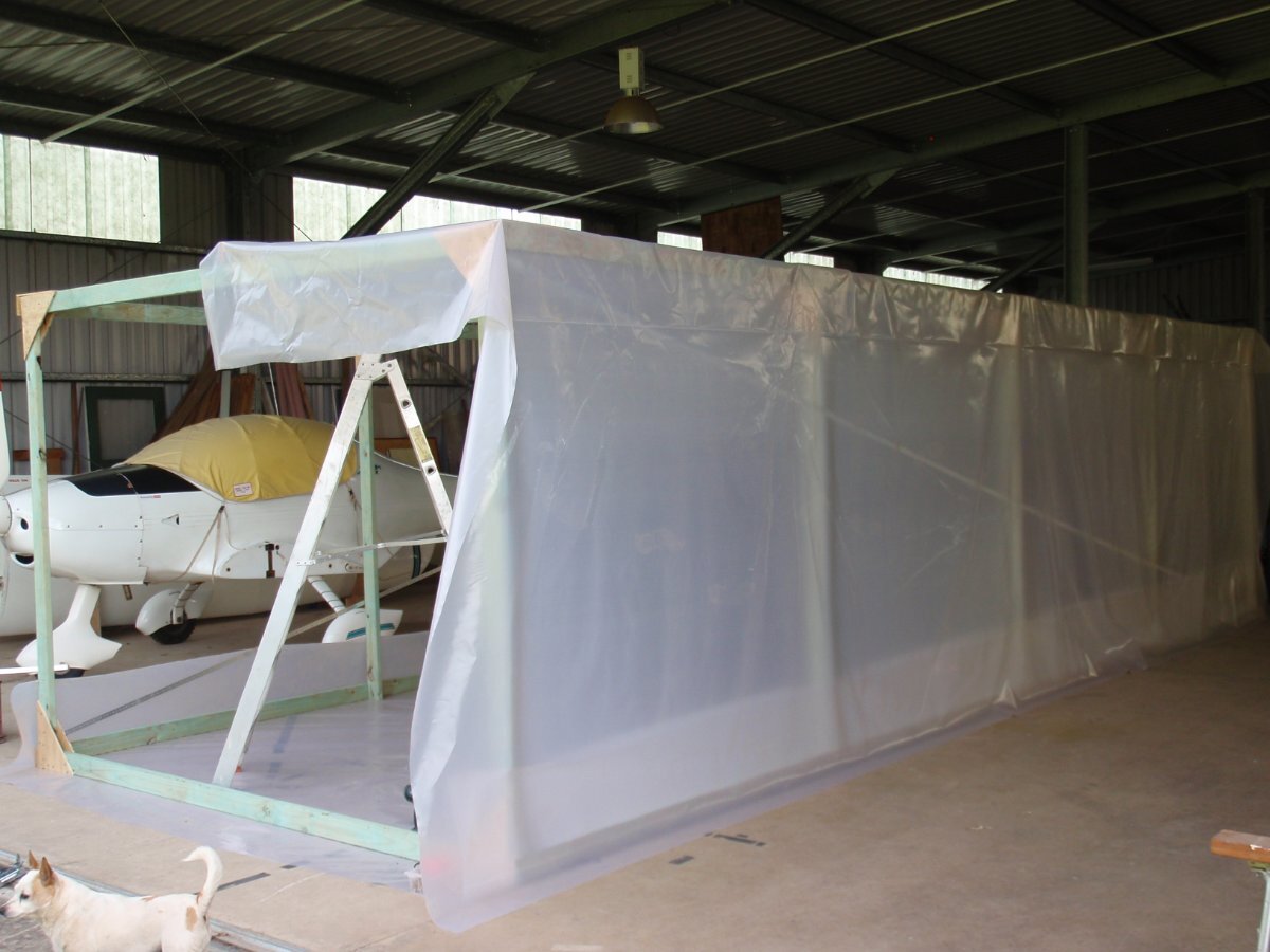

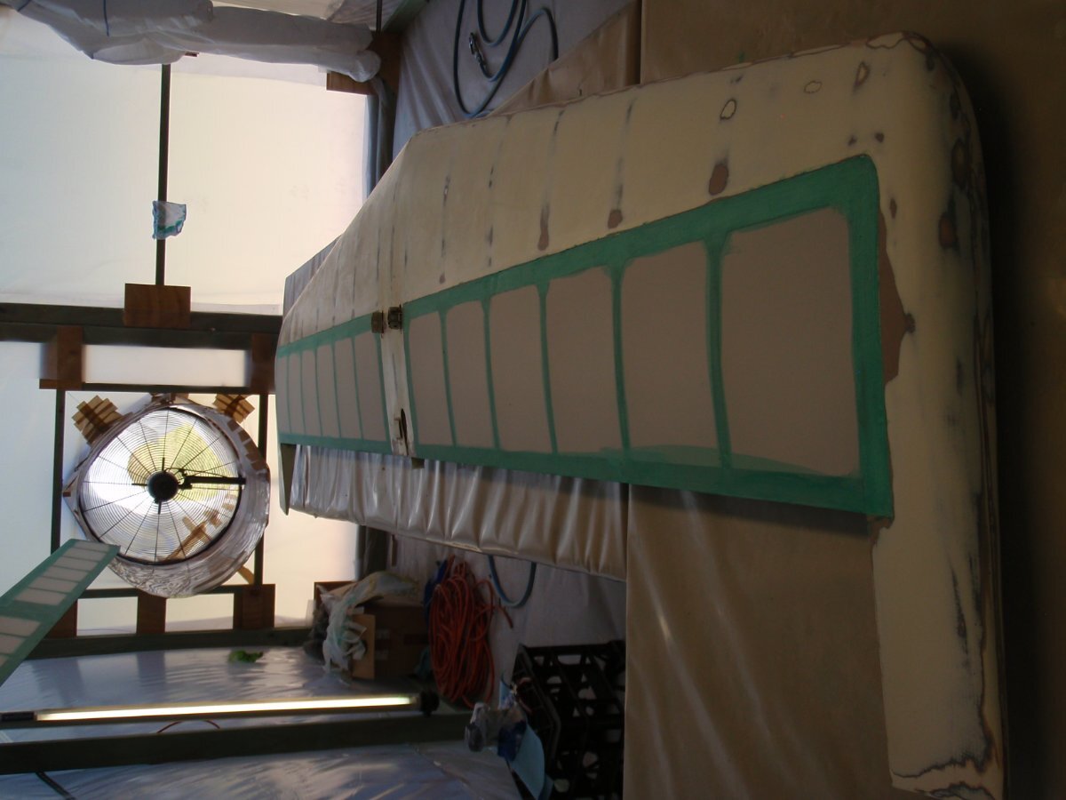

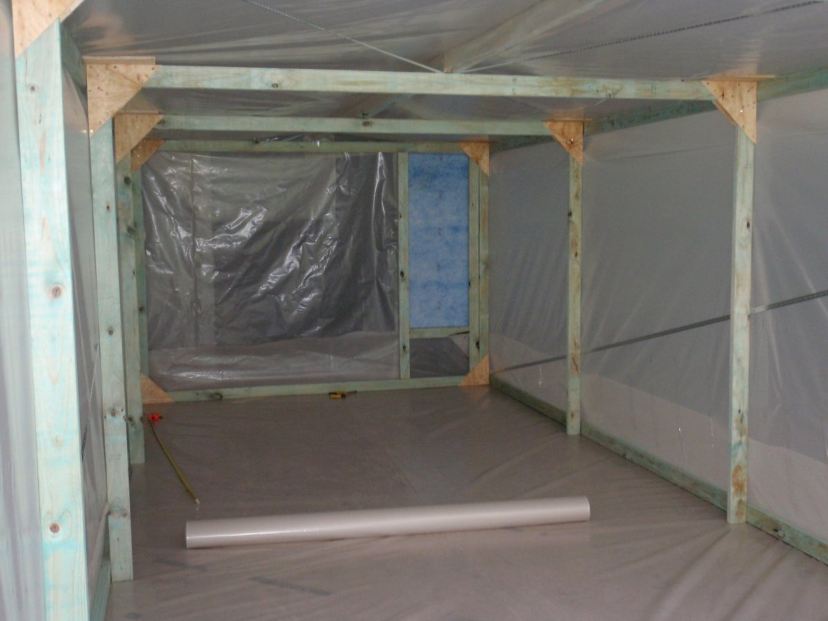

skippydiesel Posted October 29, 2025 Posted October 29, 2025 My spray booth under construction: Cheap timber, builders plastic wrapped, cheap pedestal fan (extracting) at one end and air-conditioning filter (blue stuff) at the other. Preloved window rattler reverse cycle air conditioner in centre to warm booth for paint curing. Doubled the floor plastic to hold water. Pr loved Fluro's hung all around. Whole system driven by 3.5Kva Honda generator (no 240V power) 4

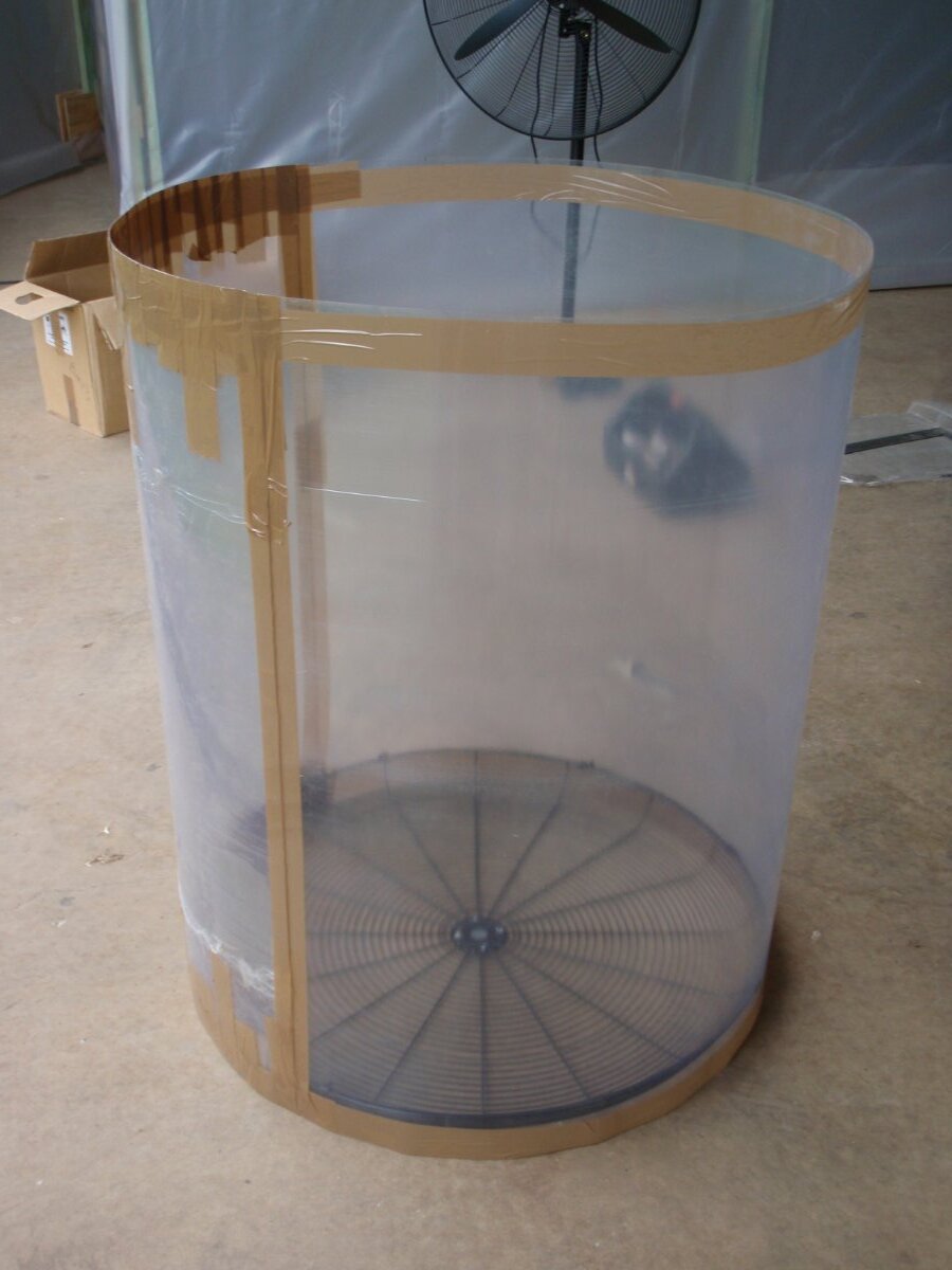

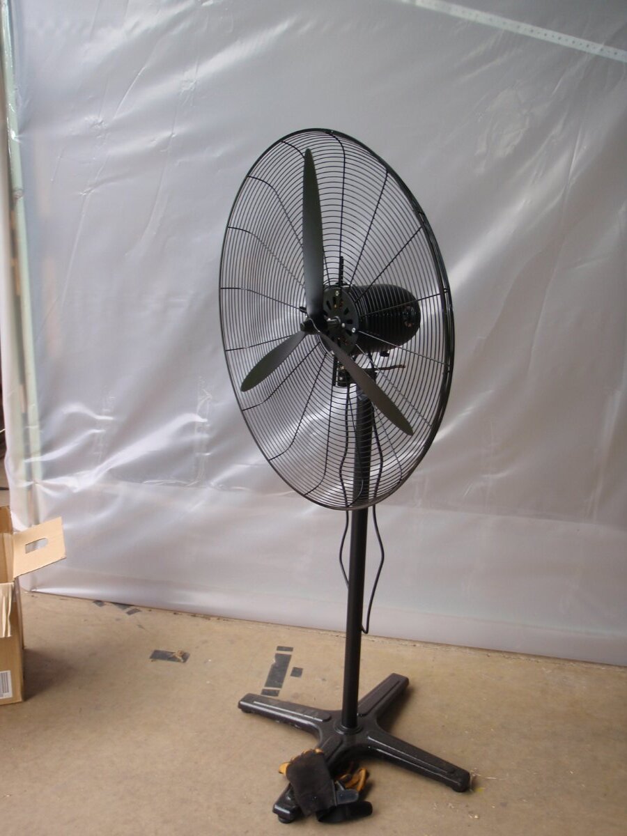

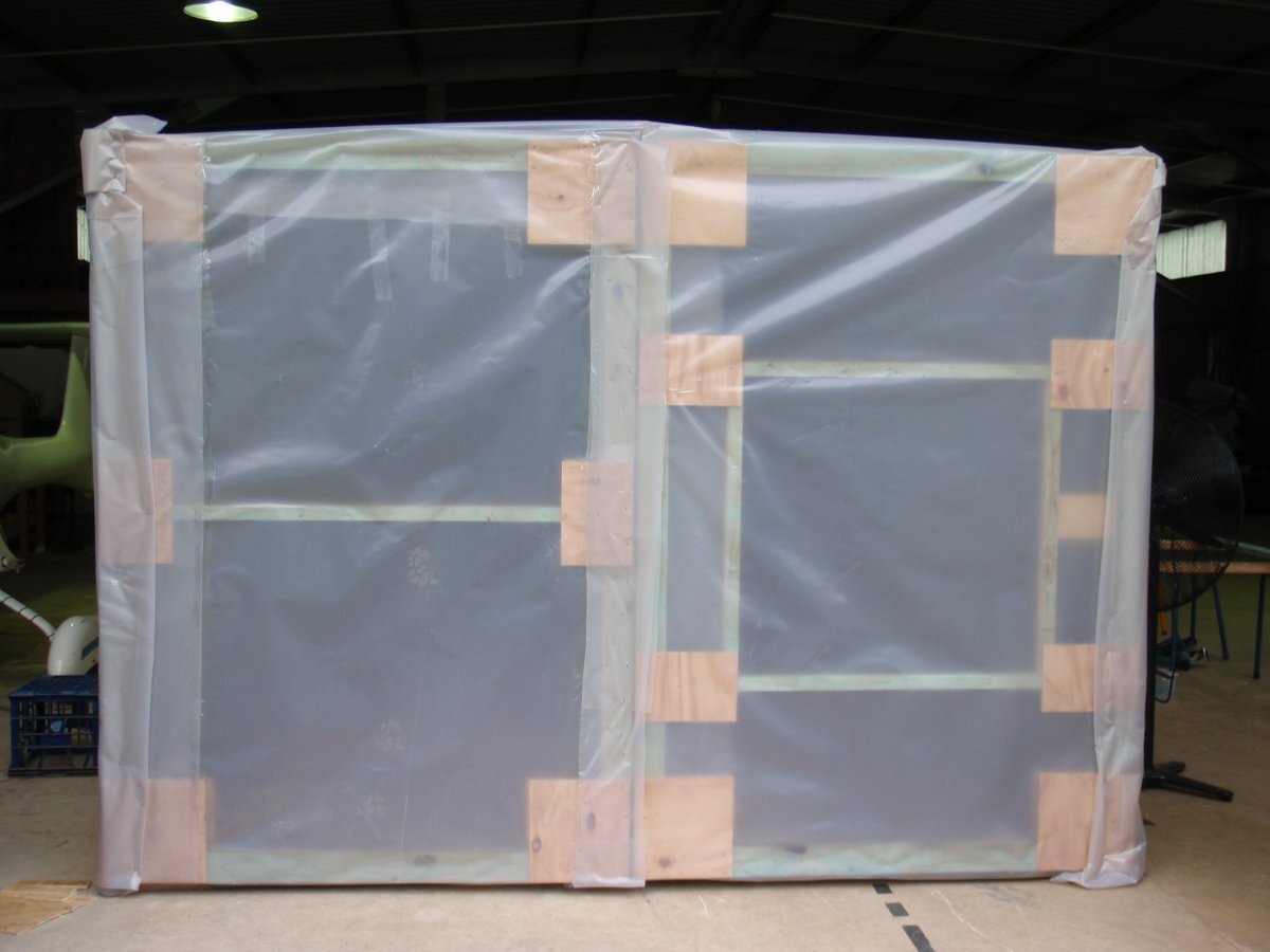

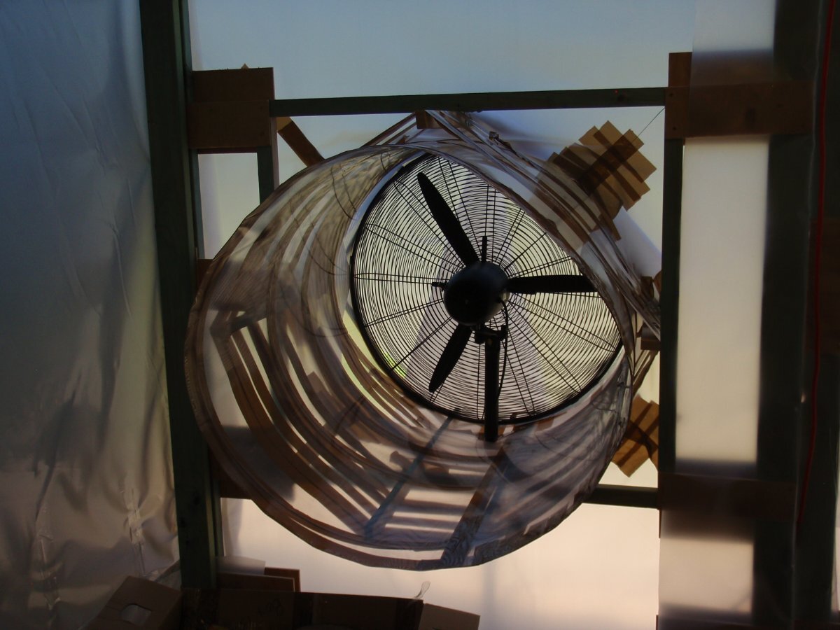

skippydiesel Posted October 29, 2025 Posted October 29, 2025 (edited) Extensive use of packing tape. Double doors for large component entry exit. Fan & cowling went into small square on right hand door. Edited October 29, 2025 by skippydiesel 4 1

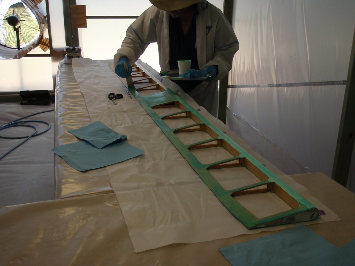

skippydiesel Posted October 29, 2025 Posted October 29, 2025 (edited) Probably should have made it .5 M wider & higher - bit squeezy when fuselage being painted. Used the Stewart System for paint & fabric - worked a treat. Most materials recycled for other projects. 😈 Edited October 29, 2025 by skippydiesel 1
