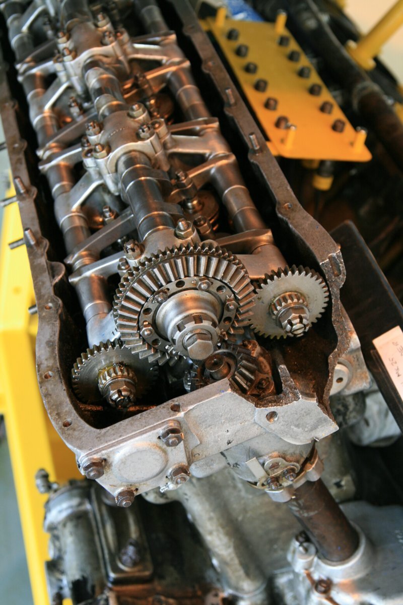

Thruster88 Posted Tuesday at 09:16 AM Posted Tuesday at 09:16 AM Single cam with 3rd order lever rockers. 4 valves per cylinder, one lobe per valve. The rocker pivot shaft rotates? Not sure why. 3 3
tillmanr Posted Tuesday at 09:26 PM Posted Tuesday at 09:26 PM That carries the gear driving the camshaft’s. 1
facthunter Posted yesterday at 04:51 AM Posted yesterday at 04:51 AM . The whole set up is not very impressive, Valves are near Vertical . The shafts each side are for the Rocker Pivots. Apparently the Hydroplane Boys blew up Lot's of them. There's a piece been out of the end of that head casting for a while too. Nev 1
