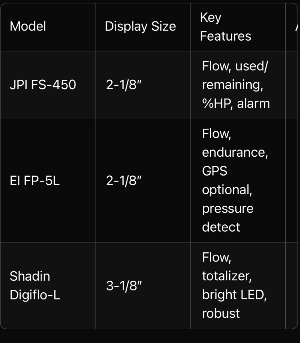

Ollaz Posted September 17, 2025 Posted September 17, 2025 There few Fuel Flow Meterbut will recommend any of this three. - Electronics International FP-5L Fuel Fl -J.P. Instruments Fuel Scan 45 -Electronics International FP-5L Fuel Flow 1 1
