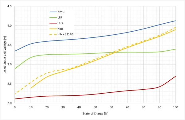

RFguy Posted Monday at 06:03 AM Posted Monday at 06:03 AM there is a new kid on the block, and I am using them commerciallyand if you are going to get a new battery, and going away from lead acid, then I beleive it is worth of contention. I'd much rather have one of these in my plane than any sort of Lithium chemstry lots of good reasons, including, no DG... and is good for cranking current. and they are less likely to go bang, and have a lower temperature during any thermal runaway. The twist is, their voltage range isnt quite as compatible with lead acid like LFP (Lithium Iron Phosphate) . and they weigh a bit more for same effort as lithium. but they're cheap. discharge curve looks like this - (per cell) which means in a lead acid 12V system, say 11V - 14.2V........with four cells in series, you are only going to be able to use about 55% of the total capacity but we dont tend to use capacity in our aircraft anyway. starting and a bit of run time in case of dead alternator. most can crank 8C to 20C, so a small battery can crank well. You still need to shield them from high temps in an engine bay- all batteries should have a shiny (metal) shield around them to reflect the radiated heat away from them this is not a bad treatment... anyway so much so I have changed over the family's battery frigge camping kit to Sodium.... https://www.batterydesign.net/chemistry/sodium-ion-battery/ 3

sfGnome Posted Monday at 09:37 AM Posted Monday at 09:37 AM Interesting trade off. Cheap, good cranking current, but a lot less time to find somewhere to land if your regulator or alternator carks it. Hmmm… So if you wanted to maintain your time to land, you’d need twice the overall capacity, meaning that the lower cost starts to not be so low. Still, interesting. 🤔 1 1 1
