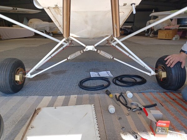

Taking off yesterday (after 2 touch and goes) from a full stop I head a clunk under my seat, immediatly cut throttle and put her back down on the runway (I have 1.4km to use).
Taking off the  covers over the main landing gear I note that the left hand rubbers are pretty much done, so easy, order new ones and replace (and do the 500 hr update while I am there).
My questions is, on the right hand side there is a white spacer that sits above the inboard bolt, about 10mm in height. It is only on the right hand side, the left hand is hard against the floor.
I can't see this spacer in the Jabiru Technical Manual for the J160 airframe.
Reaching out to the brainstrust here, is this supposed to be there? Should there be one of the left hand side as well or should I remove it when I replace the rubbers?
I am going to do a wheel alignment when I finish as I am chewing out the outside of the tyres on the main gear as it is.

You could send images to Jabiru and ask about this, as if you need any other parts they can be sent with the rubbers. Would be a shame if you need two postage’s and await a second delivery. Great that you are getting to understand your aircraft’s build. Let us know what you find out. Cheers.
PS never know may have only had an over length bolt. If so you will need a correct length one.  Just a guess.

I can only suggest that is a  spacer and the stud/bolt is too long. Balance the wheels on level knife edges on a suitable mandrel. Some of those Jabiru wheels have excess Camber. I think that is corrected by a wedge. Jabiru used to have a lot of this stuff on Line.  Nev
I though it was a spacer, however it is on top of the inner part of the leg spacing it down from the bottom of the frame. This would cause the outer part of the leg to move further out, and make the vertical mount for the hub either more vertical, or more camber. It has been suggested that it is for wheel alignment instead of spacers and flocking at the hub side of the leg.

The factory method is to space the hub out with washers to get the camber and toe requried, then flock them into place.
It's a factory (24 rego) aircraft, so I wonder what I will find when I pull it apart.

None of the supplied bolts are long enough, spoke to Jabiru and I was sent 26a and 27a bolts. But I might need 31a, 32a or 33a bolts.
Now I need to take them all out, measure them and ask for the right bolts.
This is a 24, factory built aircraft that even the manufacturer can't supply off the shelf parts for. And I have $120 worth of toolbox fillers that I can't use.
I love my Jabiru, don't get me wrong. But between nothing being 'factory' and the poor paint quality I am beginning to thing I got a last friday of the month plane.
Now I just need another day to head out to the airfield, jack up the plane and take all the bolts back out, measure them, put them back in and wait.

2 previous owners, full(ish) maintenance records. It has not had the 500 hrs bolts done in the 1100(ish) hours it has flown.
The black, rubber bushing on the inboard end were falling apart (hence the clunk that alerted me).
There is a number of things that have me going WTF on this plane, it has a transponder that is not run through the avionics switch, just the main switch, the transponder and radio are sitting in a timber panel that is siliconed, screwed and pop riveted to the panel. The cover of the elevator horn and trim command was held on with machine screws into the threaded inserts, wood screws, plasterboard screws and builders adhesive. I had to cut if off the plane once all the screws were out.
I has been sitting outside on the hardstand on a coastal airport for a few years, it has pumpkin head cover the windows etc are good but anything that is not stainless, non-ferros or composite has a patina on it. I will be doing a full fastener replacement and bolt inspection later this year. We pulled the control surface bolts for the annual earlier this year and they are all good, no sholders etc just discoloured by salt spray.
It's a 2011 factory build 160, with the dual brake calipers. It does need (and I have them) the disk replaced as they are are a pitted nightmare due to the salt exposure, but they still work. I am going to referbish the whole brake, axle, wheel, tyre, spat assembly.

Thanks everyone my L2 removed the sprung legs and re-drilled and reamed new bolt holes at the top centre connection point to bring the wheels back to upright. Ready for test flight just waiting for registration certification..
