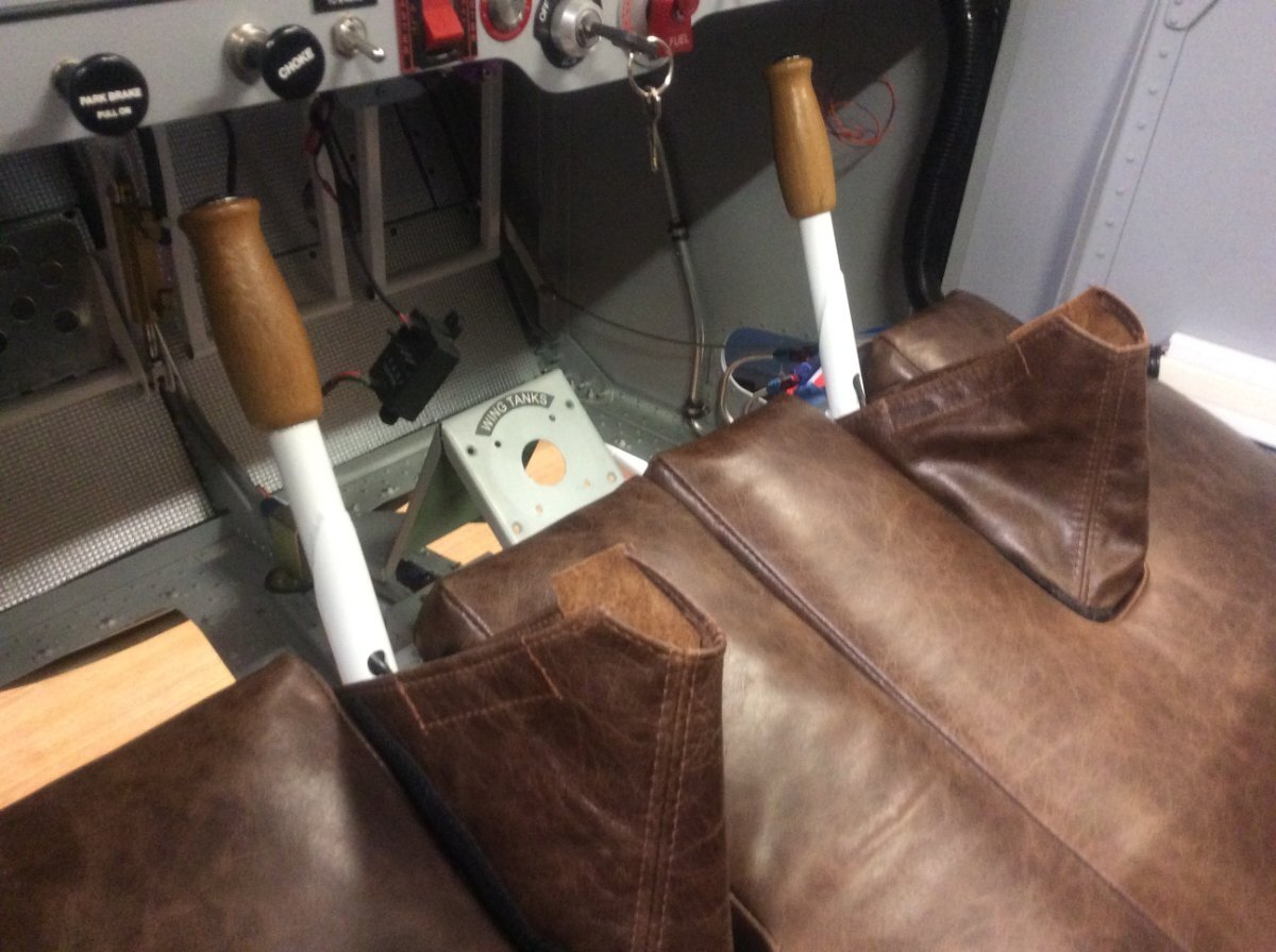

In Cruise, I fly with  the proverbial "two " fingers, about midway down the stick, so that my  arm rests on my knee/thigh. I may add further fingers, as required, in strong turbulence. My hand turned "grips" look good, are comfortable, do give my hand a place to reside in more demanding stages of flight - TO, Climb, descent to Landing.😈
Very nice, what timber did you use?
Sorry, no recollection - possibly yellow box.😈
