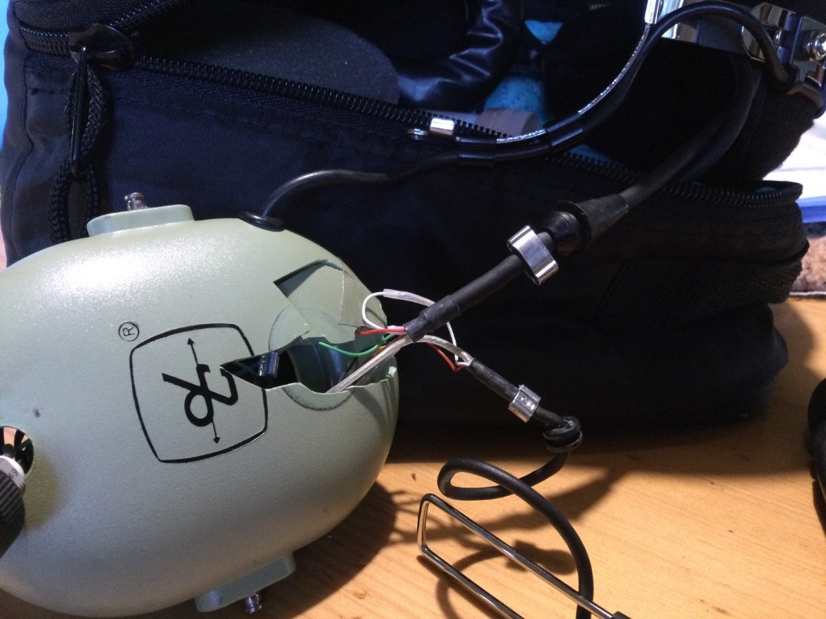

skippydiesel Posted June 1, 2025 Posted June 1, 2025 David Clark HS - Needs new "Dome"/ear cup - ordered. Cant believe how thin/flimsy the cup is where the mike boom is attached - like an egg shell only not so strong. Need to come up with absolutely safe way of removing the silver/metal retainers on wiring (see photo). Suggestions, preferably from those with experince, welcome.😈 1

bushcaddy105 Posted June 1, 2025 Posted June 1, 2025 I have done this by gently squeezing across the crimps with pliers which have curved jaws to slightly open the crimps, enough to insert a very fine blade screwdriver and twist the crimps open. Side cuttters can then cut the band to remove it. Cable ties do an equivalent job when re-assembling. There’s your suggestion!!! 1 1

skippydiesel Posted June 1, 2025 Author Posted June 1, 2025 12 hours ago, bushcaddy105 said: I have done this by gently squeezing across the crimps with pliers which have curved jaws to slightly open the crimps, enough to insert a very fine blade screwdriver and twist the crimps open. Side cuttters can then cut the band to remove it. Cable ties do an equivalent job when re-assembling. There’s your suggestion!!! Thanks Mate - the only one who answered my question😈
skippydiesel Posted June 15, 2025 Author Posted June 15, 2025 Received new DC ear cup/dome Thursday. Had great fun dismantling, reassembling wiring etc. Tested Friday - all good including ANR (noise cancelling). My thanks to Bushcaddy105 - his suggestions have worked very well. 😈
