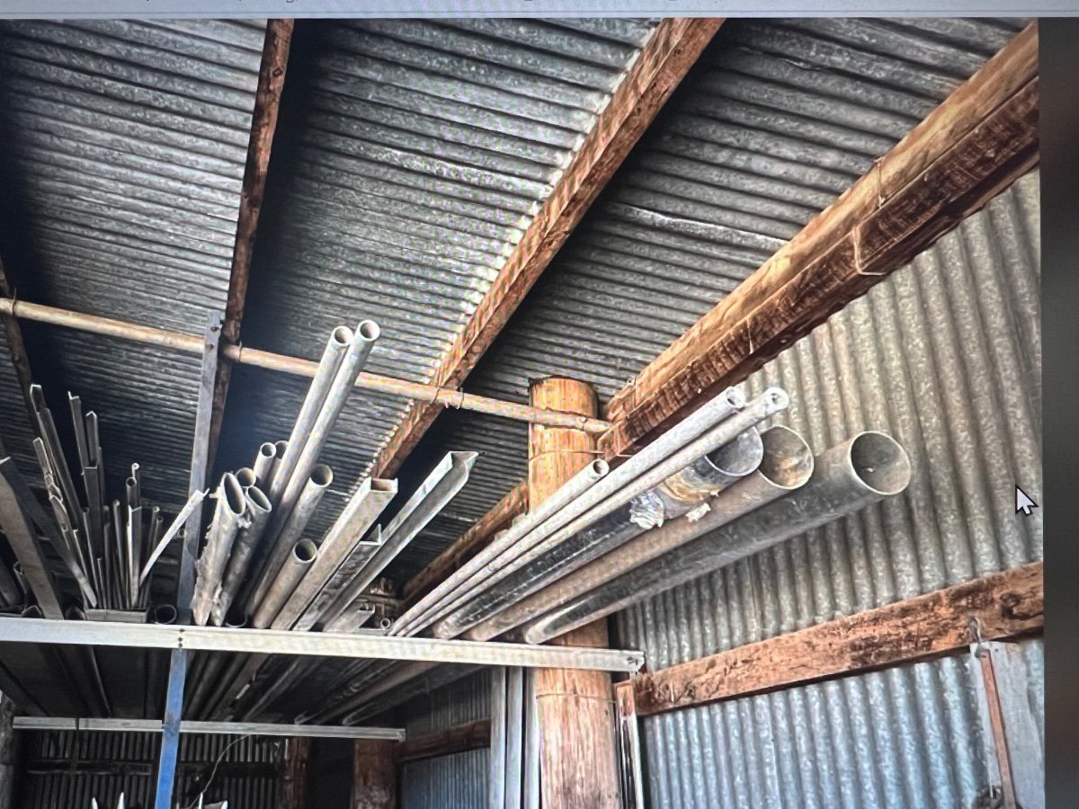

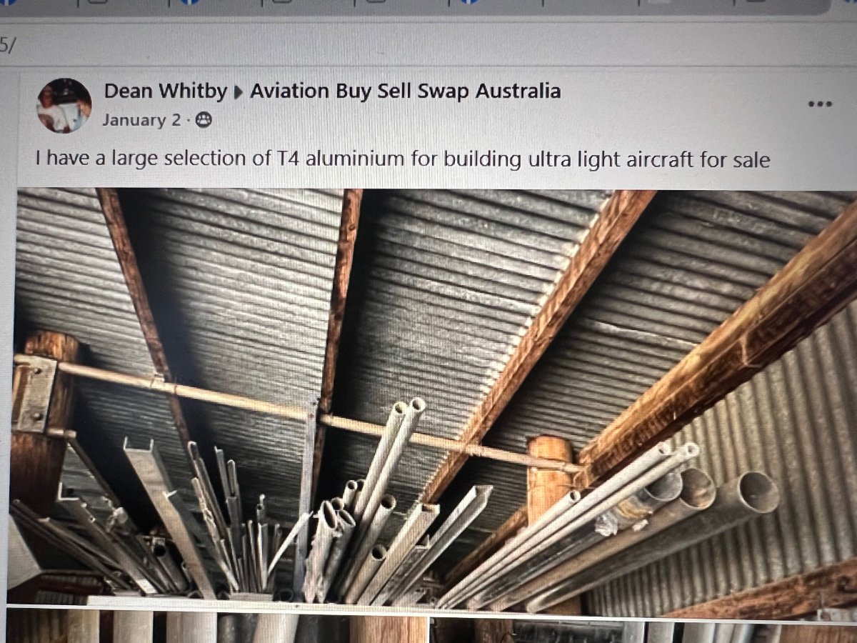

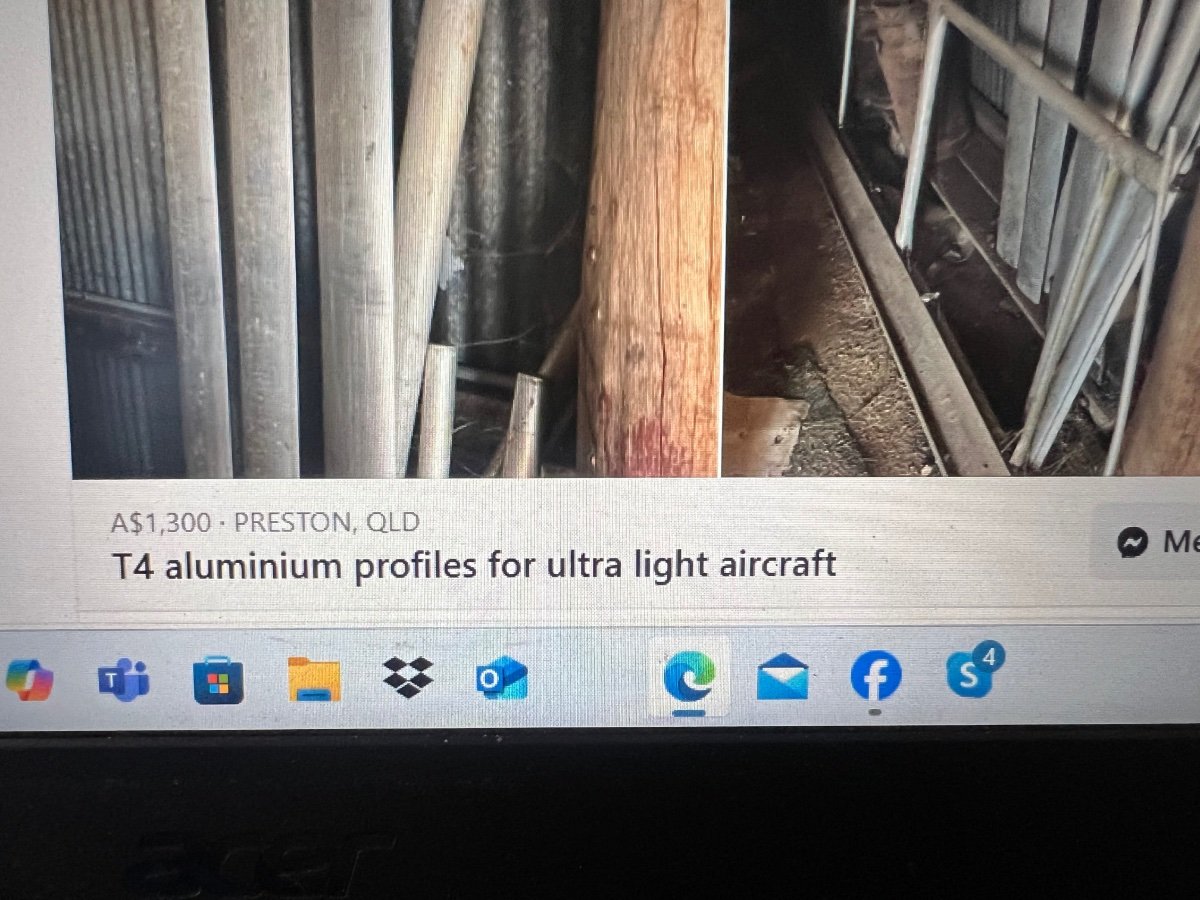

20 hours ago, Blueadventures said:
This guy had tube for sale on 2nd January.
Thanks for the lead!…I’m just trying to join up to that group to chase the contact details, could be lucky and have some 5 inch tube!?
