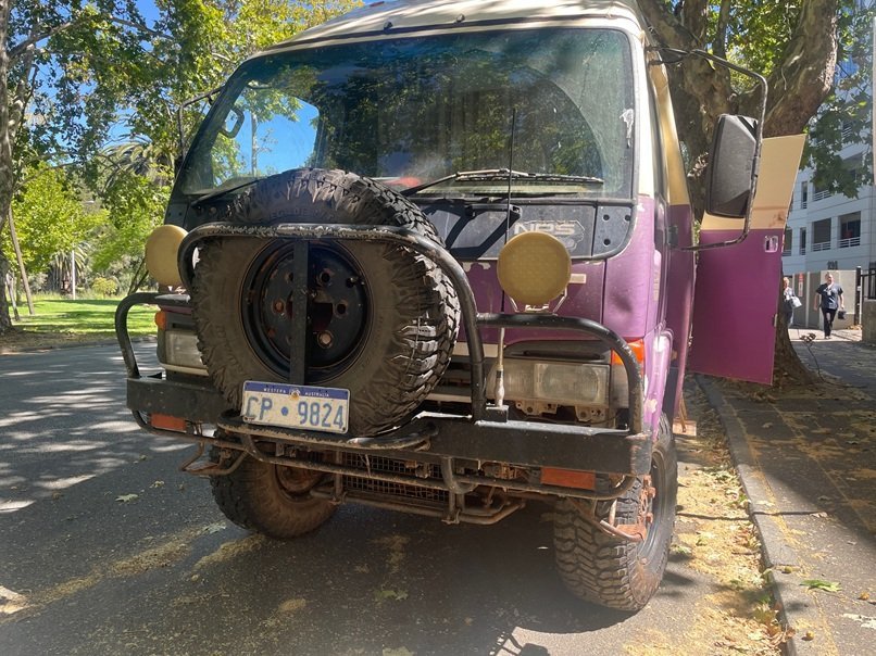

Moneybox Posted February 11 Posted February 11 I'm not even flying yet but I expect to have a lot of trips Cue to Perth and back. My plan is to see if I can become a member of the Northam Aero Club and use that as my southern base. It's 261.9 nautical miles each way and an hours drive to Perth. Yesterday we left Cue at 4:20pm and arrived here in Bindoon at 11:38pm stopping for about half an hour at Paynes Find for a bite to eat. We are still an hour from Perth. If my plan works out I'll have a little Mercedes van with a bed and basic extras parked at Northam for the travel to Perth. I bought the van to travel around the country a few years back. If that works out my van will be available to known visitors dropping in. 5 1
