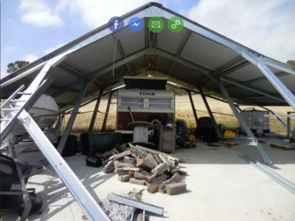

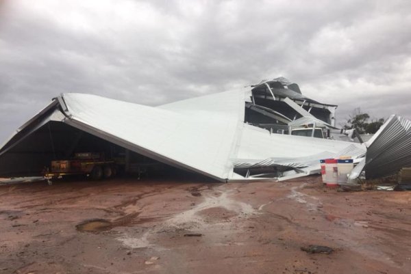

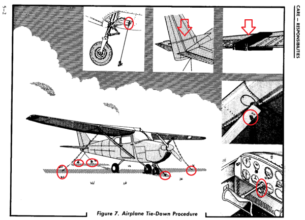

dlegg Posted December 10, 2024 Posted December 10, 2024 4 hours ago, facthunter said: Do you fit Gust locks? . Nev Mandatory or you're in for a nasty surprise 1 1
Bosi72 Posted December 10, 2024 Posted December 10, 2024 This worked for me before got in a hangar.. 2 1
kiwiaviator Posted December 10, 2024 Posted December 10, 2024 This is a very informative publication with some great ideas for 'mooring' your aircraft to mother earth https://www.aviation.govt.nz/assets/publications/gaps/secure-your-aircraft.pdf I had my Jabiru 230 tied down in Newman just up the road from you one winter. I used the Claw tiedown system. In the summer I stored it in a hanger in Geraldton as there was no way I was having it outside in wet season. You should seriously consider some sort of hanger. The container shelters are cyclone rated and cost effective. I would have permanent tie downs as well in them. 3

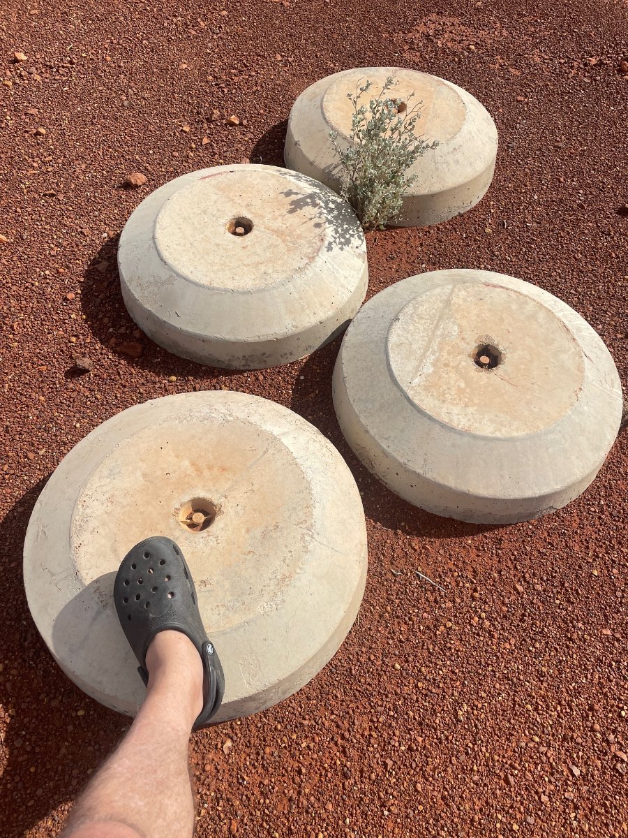

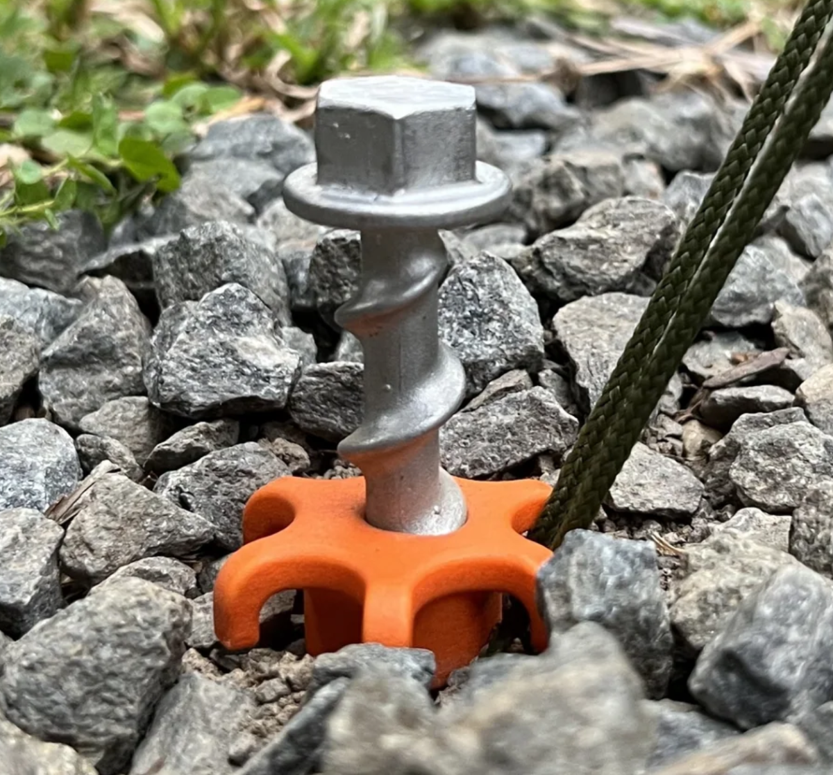

Moneybox Posted December 10, 2024 Author Posted December 10, 2024 Thanks for all the great suggestions. Our shire look after the airport so I had a meeting this morning with the CEO. He said that there are no anchorage points out there but suggested I take a look at the concrete blocks lying off to the side. I have to look into who owns them. I have the hooks somewhere to fit onto these anchor points so they might do the job for now. I don't think I can drive star pickets in but I do have a thumper if I need to use it. I like the look of the Ground Grabber bolts but the Hilti ones might be just as good in this ground. You never know what it's like until you actually try to drive something in. I often peg ground to claim the lease so I carry wooden and steel stakes. Sometimes I can't get a steel stake in the ground but then 50m away a stake needs to be driven deep just to remain standing. Same thing when its wet. I've been parked overnight during the rain and woke up to find the tyres a few inches down. Other ground remains rock hard. 2
Moneybox Posted December 10, 2024 Author Posted December 10, 2024 https://peggypeg.com.au/products/peg-stop-heavy-duty-screw-peg-20-cm-p-s-hd-pack-of-4?variant=42099294011587&country=AU¤cy=AUD&utm_medium=product_sync&utm_source=google&utm_content=sag_organic&utm_campaign=sag_organic&adv_go_camid=18405330892&adv_go_groupid=&adv_go_adid=&adv_go_keyword=&adv_go_matchtype=&adv_go_proid=shopify_AU_7408015835331_42099294011587&gad_source=1&gclid=CjwKCAiA6t-6BhA3EiwAltRFGBQJVKYC_q72zkMJt9SRS0r7wCFrFshLJ7_RE4Wbbtkmxe6OOuDd4BoCDe8QAvD_BwE I like the way these type of things can be removed if necessary. Four of these are $55 but they are only 200mm long and that might not be enough in soft ground?
