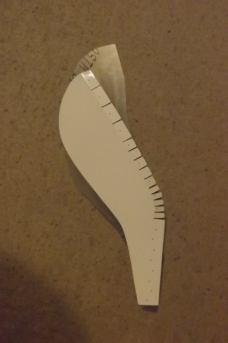

Bryan, now I think back: the pilot who test flew my Savannah taped over a small hole where the root fairings meets the wing skin LE. The fairings are non-standard, I wanted them to turn in more towards the screen and give me a wider field of vision. So that edge of the fairing (which tucks in behind the wing skin) has a series of cuts in it, resulting in small holes when they were fitted, one on each side out in the airflow enough to make noise.
That tape is still there: two round silver dots of it.
