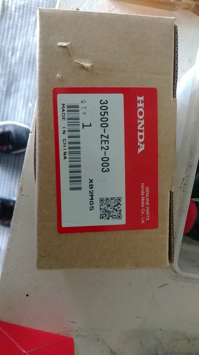

kgwilson Posted August 29, 2024 Posted August 29, 2024 Jabiru Gen 3 uses Honda transistorised coils. They are not pulse magnetos in the traditional sense so you can't hand prop a Jabiru engine as they require 300RPM to activate. Jabiru has these in stock. I replaced both coils on My gen 3 when I found the originals which were Honda copies began misfiring at different times. This manifested in me thinking I had a crook plug or HT lead. With the correct coils the engine runs very sweetly. See photo of the correct part attached. I tried to source these elsewhere but with freight etc it was cheaper from Jabiru. Note these are for the 3300 6 cylinder engine but I think the coils are the same for the 2200. 2

RFguy Posted September 10, 2024 Posted September 10, 2024 HONDA part number 30500-Z1C-023 Go onto jab-camit groups.io forum for more information here https://jabcamit.groups.io/g/main/search?p=recentpostdate/sticky,,R ignition coil failure,20,2,0,105990390
kgwilson Posted September 10, 2024 Posted September 10, 2024 That is a different part No to the one supplied by Jabiru. Once I installed the second coil, Honda part No 30500-ZE2-003 my engine has run better than it ever did before
RFguy Posted September 10, 2024 Posted September 10, 2024 there are some differences and compatibilities between certain types of 'suppressor leads"
kgwilson Posted September 10, 2024 Posted September 10, 2024 The Jabiru supplied coil has the exact length of copper strand lead and connector to the distributor cap. I noticed that some others have a length of lead which you need to cut to length and install the end connector and push fit rubber cap. 1
