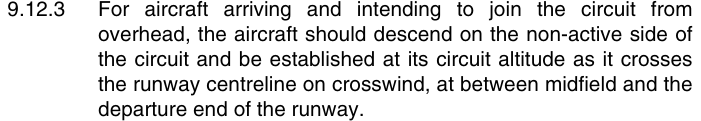

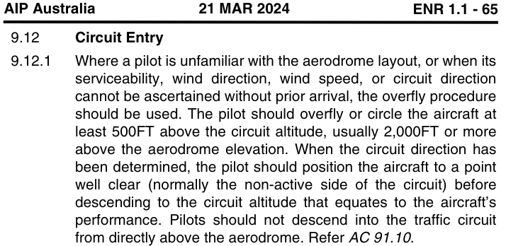

Bosi72 Posted June 21, 2024 Posted June 21, 2024 (edited) AIP ENR 1.1-65 para 9.12.3 "joining overhead" AIP ENR 1.1-57 para 9.1.14 "radio calls" ERSA for specific aerodrome procedure https://www.airservicesaustralia.com/aip/aip.asp?pg=20&vdate=13JUN2024&ver=1 Edited June 21, 2024 by Bosi72

aro Posted June 22, 2024 Posted June 22, 2024 25 minutes ago, facthunter said: a midfield process which includes a descent to circuit height by the time you are on downwind leg. Not in the last 20 years at least... You are supposed to descend on the dead side (or non-active side if you prefer) and be at circuit height before you cross the runway and join the circuit. Descending into traffic on the downwind leg is a no-no. Among other things, it is much easier to see the traffic you are supposed to avoid if you are not above them.
facthunter Posted June 22, 2024 Posted June 22, 2024 Don't agree. How do you get a look at the windsock and the general layout IF you don't have a look from a safe heigh clear of other circuit traffic.?
aro Posted June 22, 2024 Posted June 22, 2024 1 minute ago, facthunter said: How do you get a look at the windsock and the general layout IF you don't have a look from a safe heigh clear of other circuit traffic.? Overfly at 1500 AGL (or 2000 AGL if there might be high speed traffic doing 1500' circuits.) Check the windsock, determine which runway to use. Descend to circuit height on the dead (i.e. non-active) side. Join the circuit at circuit height. This is pretty basic stuff - anyone post area-solo stage should know it. 1

aro Posted June 22, 2024 Posted June 22, 2024 I can think it through, but the rules say different. Here it is straight from AIP: Pilots should not descend into the traffic circuit from directly above the aerodrome... ... the aircraft should descend on the non-active side of the circuit and be established at circuit altitude as it crosses the runway centreline on crosswind 1
facthunter Posted June 22, 2024 Posted June 22, 2024 (edited) It uses the word "Should" Not MUST. Please take note. ALL the points you have brought up I have also Assess the situation Don't just fixate on a few words. as if complying with them is the ONLY way and is always the answer.. An over riding consideration in this game is to conduct your flight in the safest manner possible. THAT'S been the rule for a long time and I can't see it EVER changing. It's fundamental and over rides all others. That's a pretty recent AIP also. 3 months old. I'm not new to these things. I've worked with the AFAP and CASA to write some of them. Nev Edited June 22, 2024 by facthunter 1
