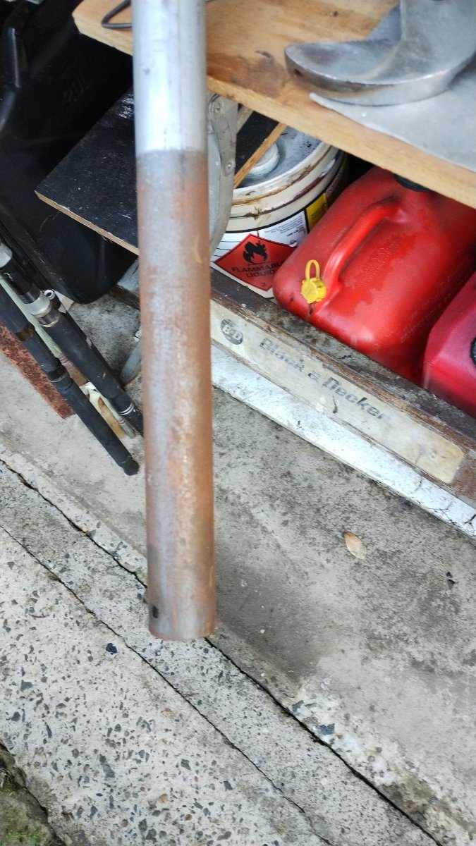

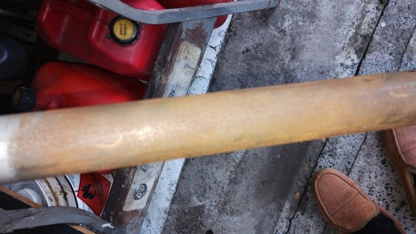

GolfWhiskeyHotel Posted April 9, 2024 Posted April 9, 2024 Working on a Gazelle, replacing the front tyre I pull the tail down and check the front leg. It wobbles a bit . the leg itself (the inner tube) was chromed that's now gone in places, there is up and down "slop" I read about biscuits in the manual , does not say what they are. How are the bearings in the outer leg arranged? Is it just a spring in a tube? Does anyone have a working drawing of the leg? Any help much appreciated. Thanks GWH

Peasant_Pilot Posted April 25, 2024 Posted April 25, 2024 Have you got a photo of the front gear leg? @GolfWhiskeyHotel Cheers Rob 1
spacesailor Posted April 25, 2024 Posted April 25, 2024 Because, those legs do bend easily, and that wear , plus the rusting on that area . Is a known problem . It's only a tiny aircraft , & I suspect the leg could be made just a little stronger. After a few years of having a ' training wheel ' at the front I was intending to change the ' Hummelbird ' to a conventional tail dagger, eliminating the nose wheel problem. spacesailor
