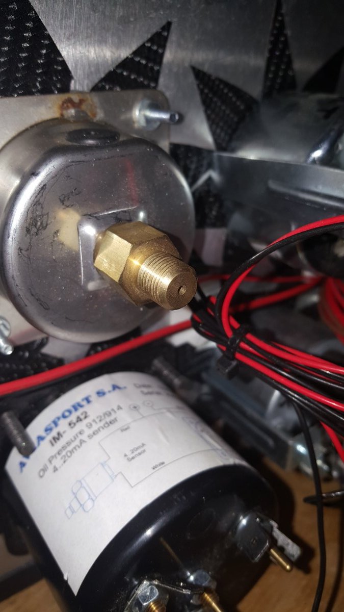

Marty_d Posted July 21, 2023 Author Posted July 21, 2023 A follow up question... A couple of people have said they threaded the inside of a barb and inserted the restrictor jet into it. Given the restrictor jet has a barb itself - is there any reason I can't just tap an M5 hole into the body of the manifold and have the 2 restrictor jets (tank return and fuel pressure gauge) threaded straight on to it? Yes the barbs are very small (around 4mm OD by the looks of it), I'm assuming there's a fuel safe hose of that size available? And an additional question - the back of my fuel pressure gauge looks like this. Can anyone remember what fitting they bought to connect a hose/line to this? Thanks!
IBob Posted July 21, 2023 Posted July 21, 2023 Hi Marty, I can't help with any of that but I can offer this: See that little rubber bung in the top of the fuel pressure gauge? Either remove or open a hole in it before going flying. Because that's what lets in whatever the air pressure is as you proceed. And if you don't let it in, you too will have fuel pressure that appears to diminish as your rise, increase as you sink and/or shift suddenly if the bung should let a little in or out.......) 1 1 1
skippydiesel Posted July 21, 2023 Posted July 21, 2023 1 hour ago, Marty_d said: A follow up question... A couple of people have said they threaded the inside of a barb and inserted the restrictor jet into it. Given the restrictor jet has a barb itself - is there any reason I can't just tap an M5 hole into the body of the manifold and have the 2 restrictor jets (tank return and fuel pressure gauge) threaded straight on to it? Yes the barbs are very small (around 4mm OD by the looks of it), I'm assuming there's a fuel safe hose of that size available? And an additional question - the back of my fuel pressure gauge looks like this. Can anyone remember what fitting they bought to connect a hose/line to this? Thanks! Dont know the back of pump brass fitting diameter /thread but when you find out check out the Aeroiflow catalogue for adapters https://aeroflowperformance.com/ they have a staggering range. As for the return line restrictor jet - it can go in manifold, the barb that you fit to the manifold or the above barb. I would thread the metal component to suit - more secure. Just make sure you select a nice small jetorofice (they all the same external size/& thread)

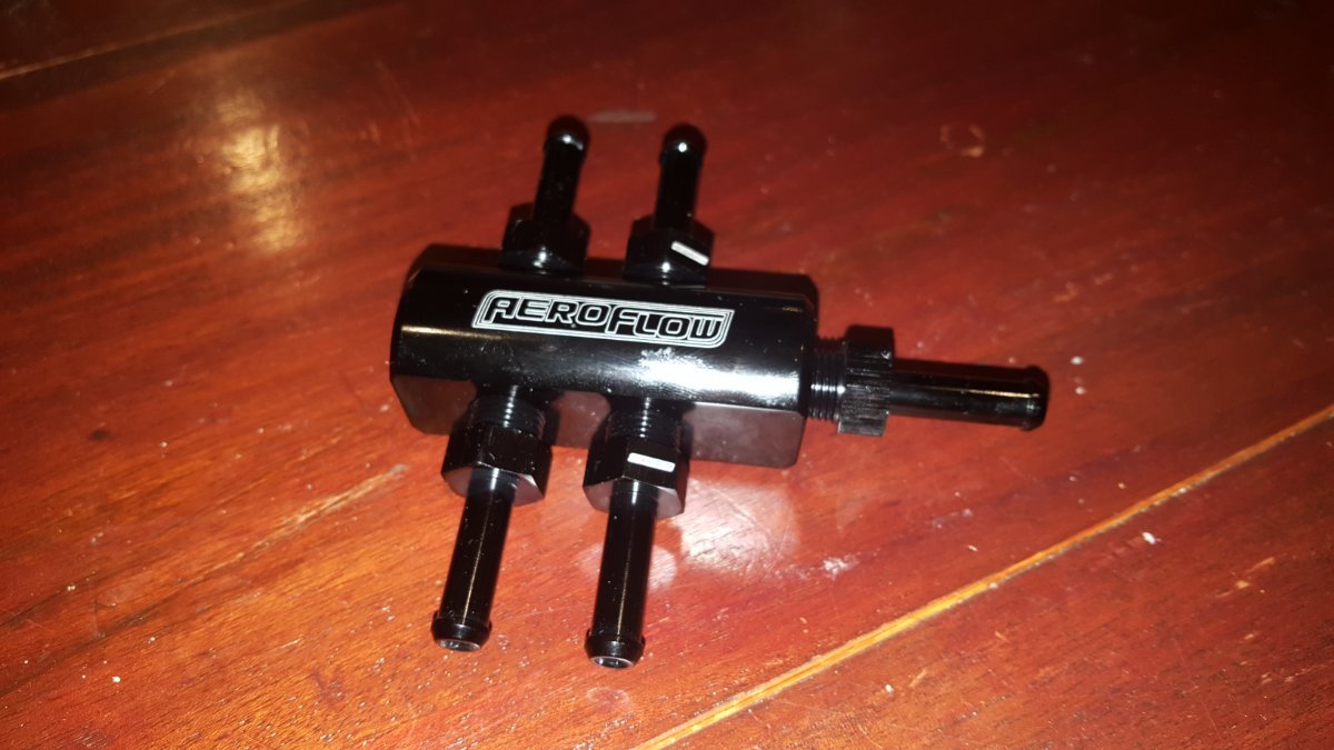

Marty_d Posted August 15, 2023 Author Posted August 15, 2023 I ended up getting an Aeroflow manifold. My attempt at tapping my own was not entirely successful. Also have some Mikuni jets on order for restrictors. 1
skippydiesel Posted August 15, 2023 Posted August 15, 2023 Looks good Marty_d The Airoflow catalogue is truly amazing - you could probably get those hose connections in elbows if it suited your "design" 1
skippydiesel Posted August 18, 2023 Posted August 18, 2023 (edited) Forgot to mention; depending on the ID of your fuel return line & therefore the ID of the push one barb/spigot, you will find that the Mikuni restrictor jet can be screwed in (after tapping) for a nice secure fit. The same can be done to the fuel sensor pressure line, if fitted.For the fuel pressure line, use a very small ID restrictor jet to reduce fuel pump pulse fluctuations. Gates (REPCO) supply fuel hose in ID 3.3 (return line) 4.8, 6.3, 8, 9.5 & larger (which I doubt you would contemplate using). There are three "grades " Return" "Carburettor" & "Fuel Injected" They all meet the Rotax specifications however I tend to favour the Fuel Injected for its slightly better heat resistance and lower vapour permeability. Edited August 18, 2023 by skippydiesel 1 1
