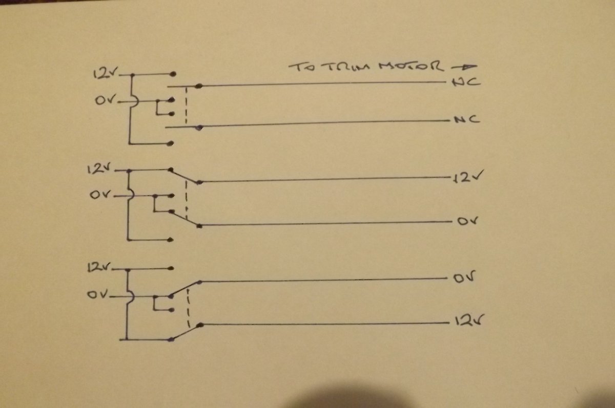

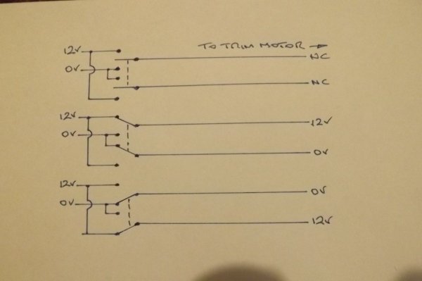

IBob Posted May 19, 2023 Posted May 19, 2023 RHTRudder the basic arrangement in microlights is usually a Double Pole Double Throw (DPDT) switch with 6 terminals. This is the trim switch on the panel. Internally it is two separate switches, mechanically linked (DP). The switches have a central neutral position and, up and down active positions (DT) with spring return to the neutral position. They are wired so that when the switch is up, the two wires going to the trim motor one polarity (eg 12V/0V) and when down that polarity switches (0v/12V). This drives the trim motor in one direction or the other. Here is how they are wired: 1
