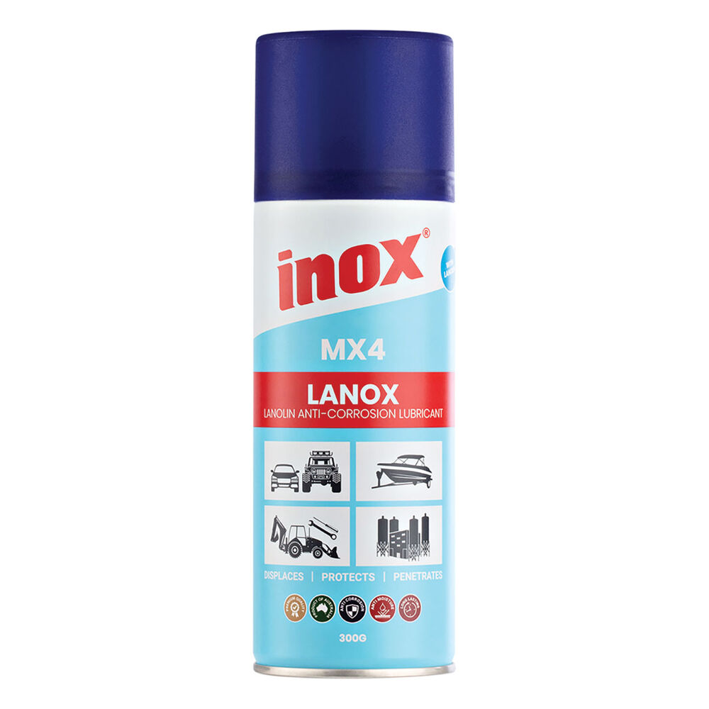

we use this stuff on Jet-ski's to stop the corrosion when sitting
SCA_100171_hi-res.jpg?sw=1000&sh=1000&sm=fit
