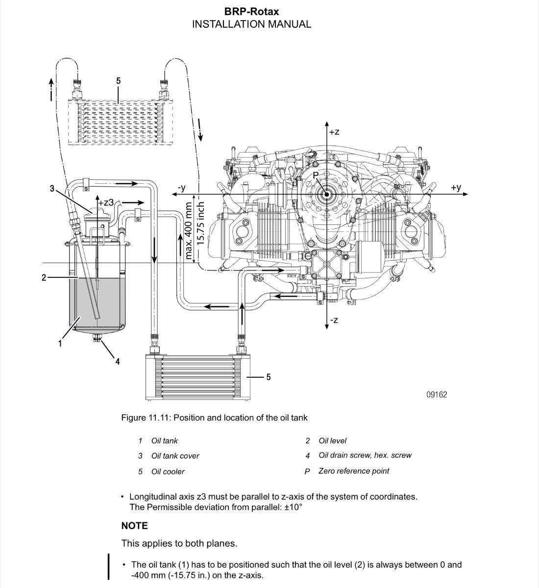

rodgerc Posted April 9, 2023 Posted April 9, 2023 The 912ULS’ oil cooler is on the suction side of the oil pump....Only sees atmospheric pressure. 1 1 2
RFguy Posted April 10, 2023 Posted April 10, 2023 (edited) and note well- there is a strict limit to the pressure drop permitted in the system, (on the suction side)- pretty well dictated by the oil cooler. You'll find oil coolers that are wide in width and short in height (IE long tubes left to right ) will not meet the rotax vaccuum limit requirements. Tall, with lots of short tubes will usually meet the vaccuum limit requirement. SETRAB publish the pressure drop for oil flow at some oil visc spec. Edited April 10, 2023 by RFguy 1
