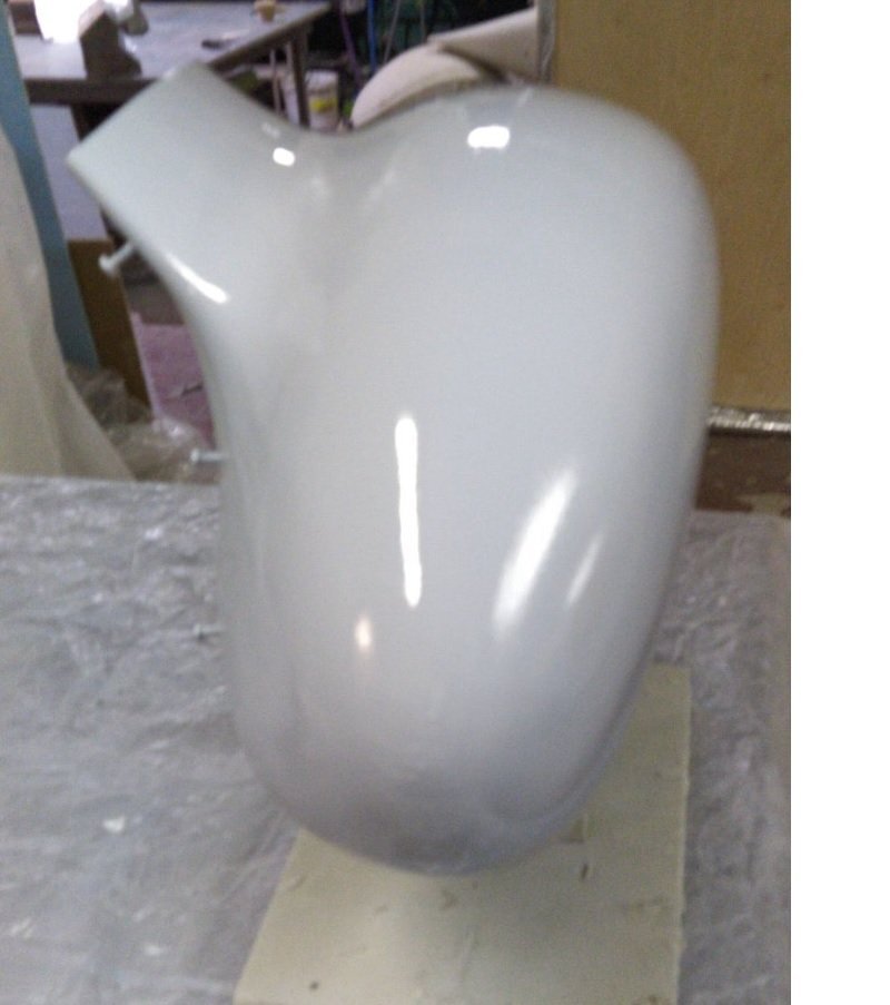

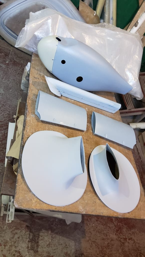

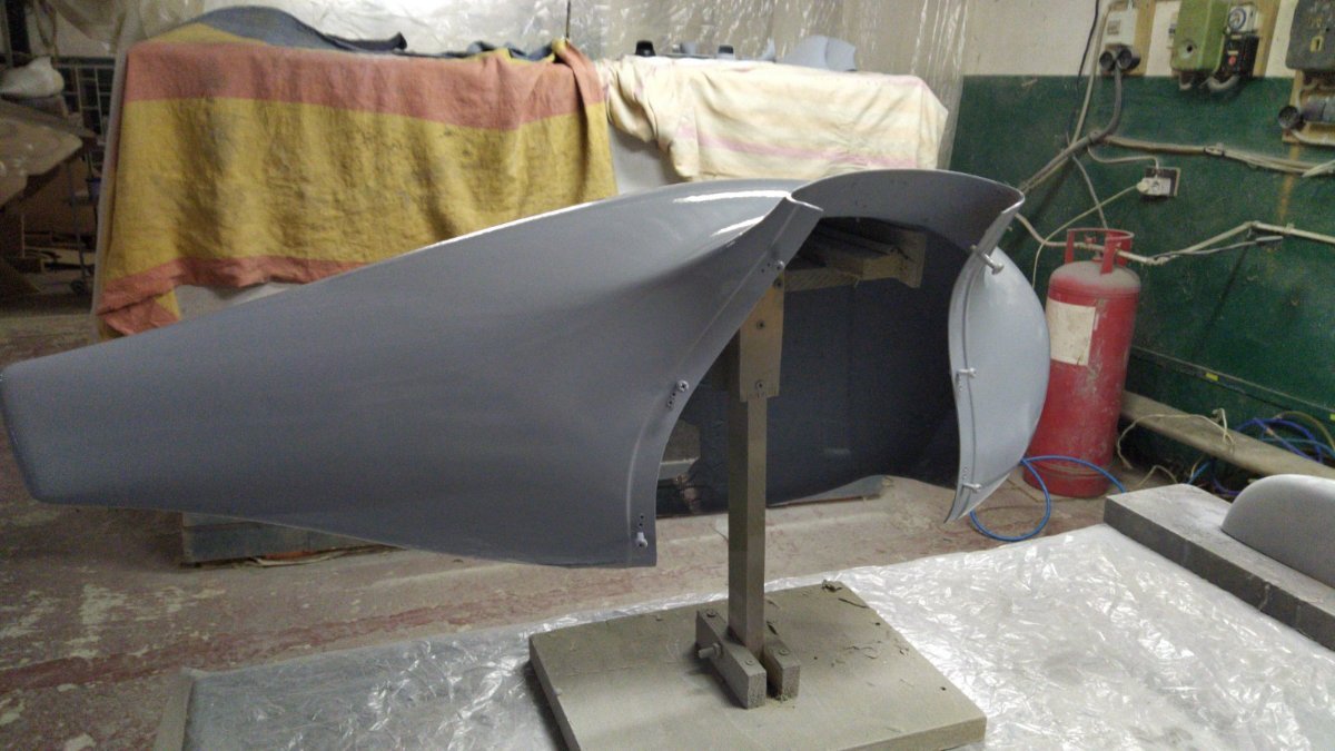

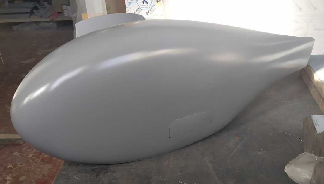

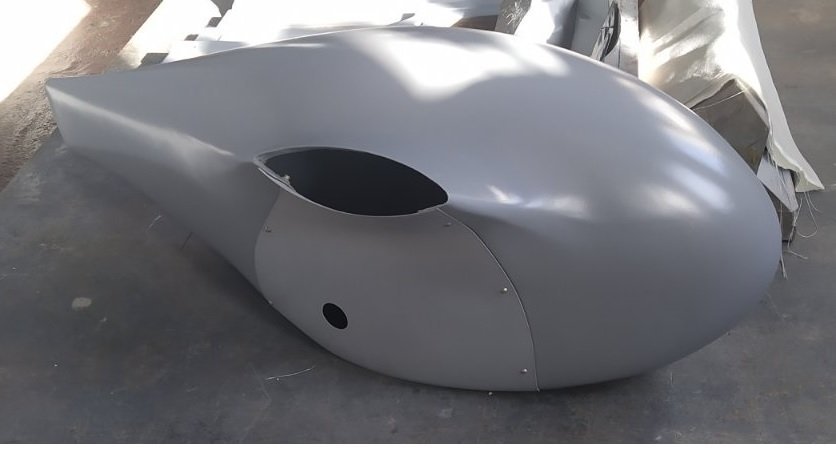

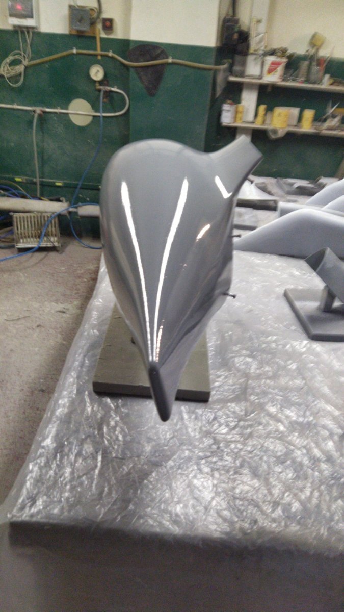

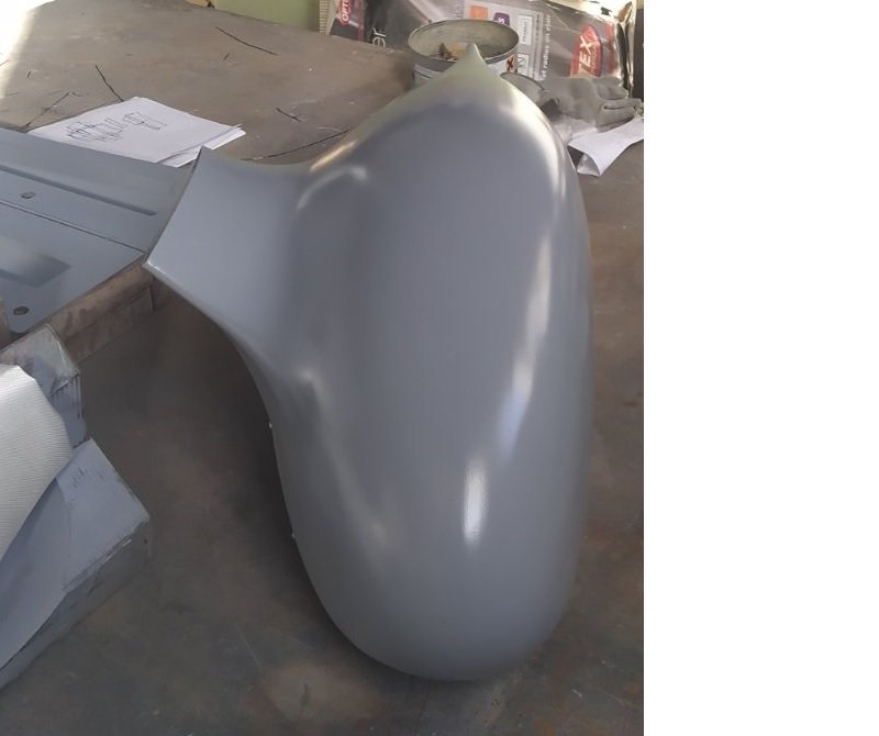

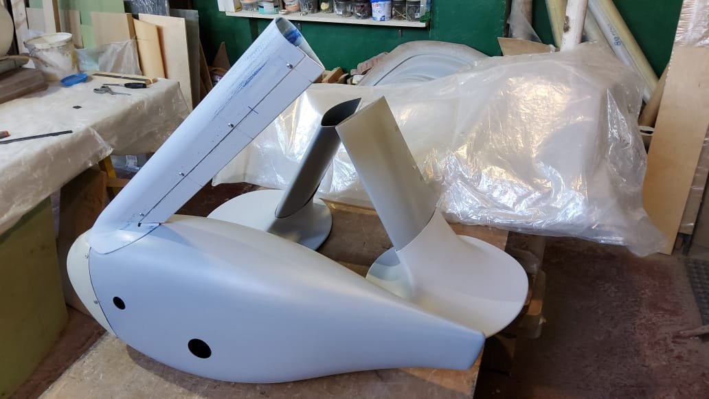

meglin Posted March 30, 2023 Posted March 30, 2023 Which wheel pants are preferable - fiberglass or carbon? We believe that epoxy fiberglass obtained by vacuum molding with heating is the optimal solution. Such fiberglass is durable, light, resistant to ultraviolet and moisture, cheap, has a large life. However, now at the peak of popularity are products of carbon. Indeed, its unit strength is higher, the stiffness is also higher. As for the price, we have to offer carbon products 1.5 times more expensive when it is primed externally. When using decorative carbon with transparent coating, the price increases 2-2.5 times. We think it is too expensive. But fashion dictates its rules, wishing a lot. Maybe we are wrong and do not know something? 1
