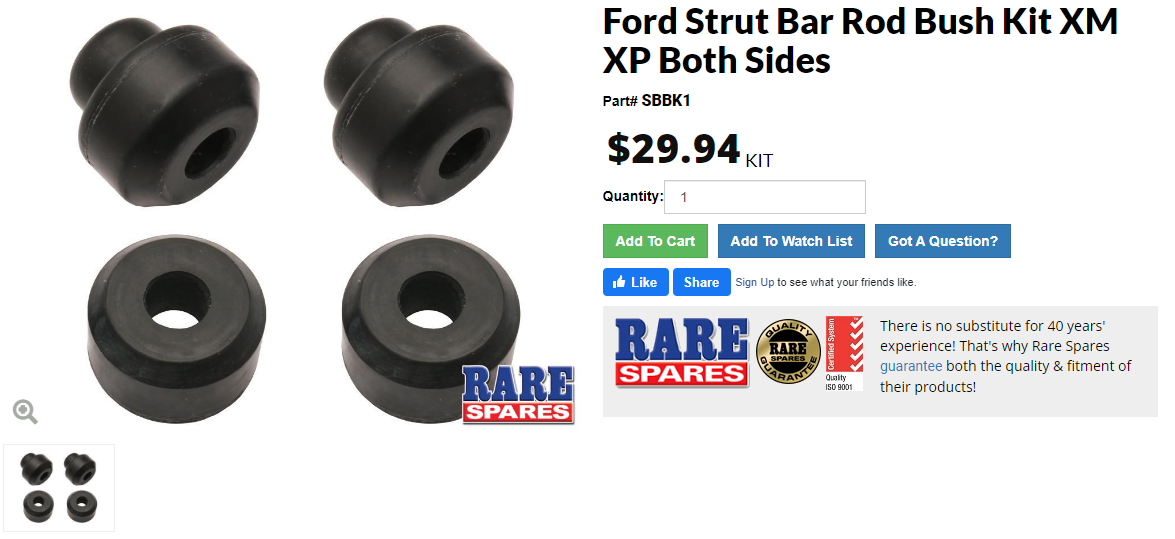

Red Posted June 6, 2024 Posted June 6, 2024 Back to the purpose of this thread..... a year or so ago I found that the engine mount rubbers for the Jab engine were actually an old Aussie car part and as a friend was currently over there I had him get me some, it was far far cheaper than going through the UK dealer for Jab (their prices for most things are beyond a joke) here is the part....... 2 1 1

BrendAn Posted June 6, 2024 Posted June 6, 2024 (edited) 24 minutes ago, Red said: Back to the purpose of this thread..... a year or so ago I found that the engine mount rubbers for the Jab engine were actually an old Aussie car part and as a friend was currently over there I had him get me some, it was far far cheaper than going through the UK dealer for Jab (their prices for most things are beyond a joke) here is the part....... they are good value. buy them over the counter here. early mustang is the same as well. there is a good jabiru alternative supplier list online compiled by someone in the uk. Edited June 6, 2024 by BrendAn 1
