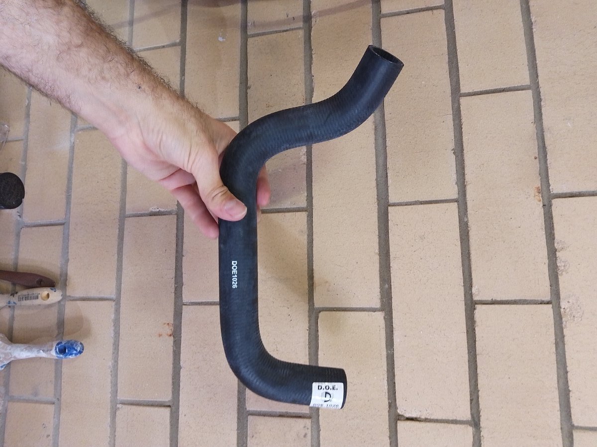

I'm wondering if we are talking at cross purposes here. I thought I was clear. But a picture is worth a thousand words they say. The attached picture is a hose FROM MY KIT. if you google the part number on the label, you get to this car parts supplier
https://www.modernautoparts.co.za
Just to be one thousand per cent sure, you can type in the other part number on the label and you get the same hose. This, I am confident this is where my kit supplier (which is based in South Africa) gets their radiator hose from  and therefore so can i.
Just to be one thousand per cent sure, you can type in the other part number on the label and you get the same hose. This, I am confident this is where my kit supplier gets their radiator hose from  and therefore so can i. IMG_20230312_101754.thumb.jpg.15a49bce384524021f2a617c47ba6458.jpg

Skippys Zephyr for instance used a Gemini radiator hose, and mine it would seem, a Datsun. Mine is not marked Nissan/Datsun so it's safe to assume it's not Nissan/Datsun OEM.

The radiator hose is a bottom radiator hose that belongs to the Nissan 1400 ute ("bakkie"), which was not sold in Australia. It's made by a local South African rubber components supplier.
The engine in the Nissan 1400 ute is the Nissan A14, a 1.4L engine that was fitted to a wide range of vehicles, and forklifts as well. I can't recall what Australian Nissans used this engine, Nissan swapped engines around like I swap my shirts.
It does appear the A14 engine was used in the Nissan Pulsar N10 of the early 1980's, but there's no guarantee the Pulsar uses the same radiator hoses as the S.A. Nissan 1400 ute. Nissan are bastards for constant changes.
My workshop neighbour has a later (1999) Pulsar with the 1.6L engine, and the thermostat housing rotted out on it - but there are no less than three different thermostat housings for this engine! And they all look the same at first glance!

https://www.proautorubberkzn.net/radiatorhoses
And there it is DOE1026. Nissan 1400 lower. I wasn't expecting any further info on my hose since I have a retail supplier source now, but you've gone above and beyond. This seems to be the manufacturer 😊
