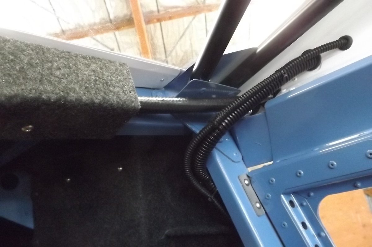

IBob Posted February 28, 2023 Posted February 28, 2023 (edited) The vent pipe from the 6litre collector tank comes across to the LH side and up through the front LH corner of the parcel shelf. From there up inside the LH rear door column, and enters the wing at the rear of the wing root rib. From there into a fitting high in the side of the LH inboard tank. The two corrugated pipes in the pic are this breather pipe, and the electrics for the wingtip strobe, which both come up the door column. (The fuel supply lines have all been carried over to the RH side of the cockpit to a valve block, allowing individual tank selection, as per Mark Kyle's build. If you have the long range tanks, this is a very good system, for all sorts of reasons.) Edited February 28, 2023 by IBob
