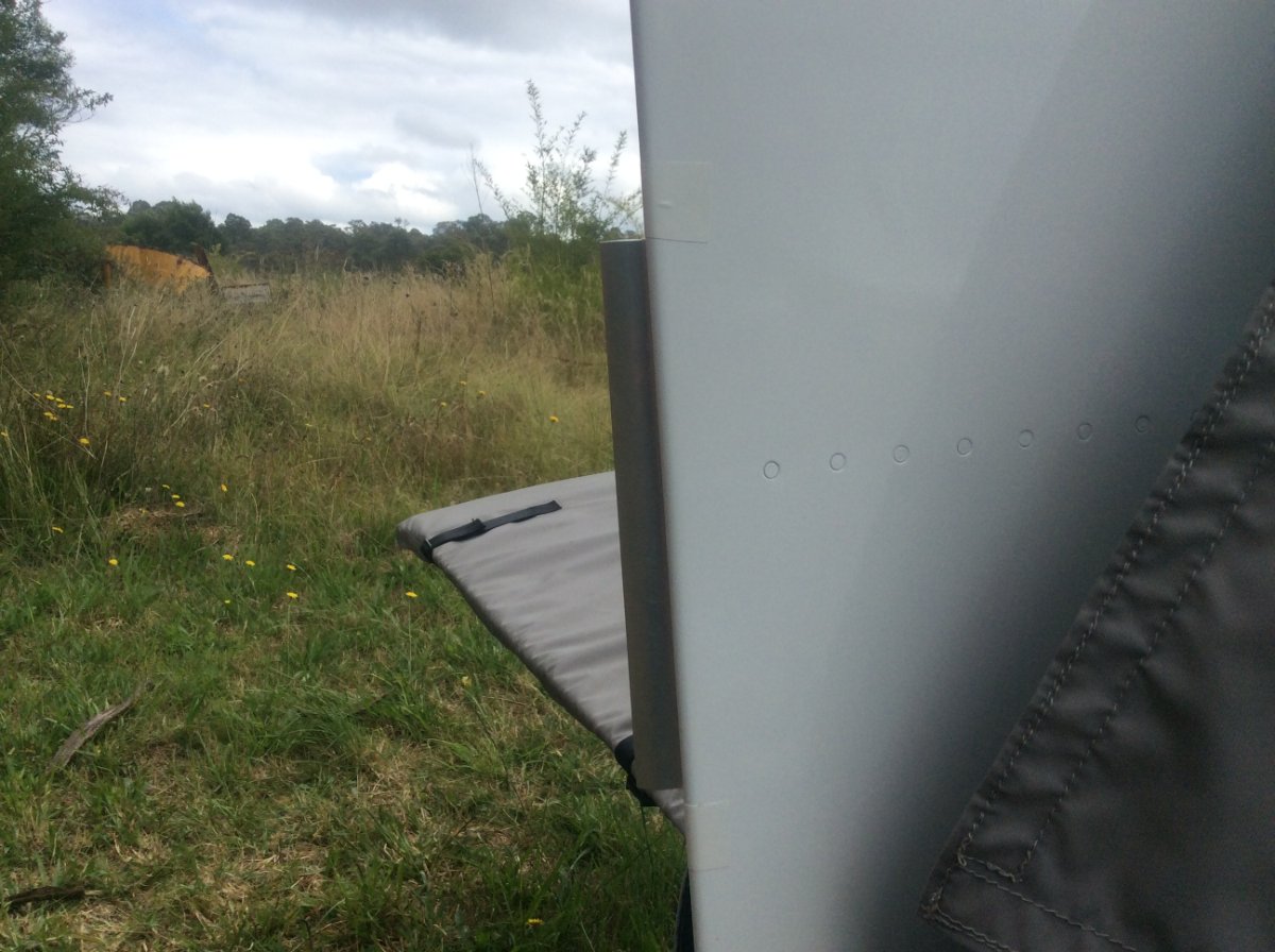

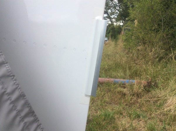

skippydiesel Posted January 14, 2023 Author Posted January 14, 2023 This aircraft is in its early test flying stage - my son & I are slowly working through all its (mainly) small "teething" problems.  Changing the engine alignment, is no small fix and I am not even sure that it is possible without a major rebuild.  The aircraft, a Sonex Legacy (A), has been meticulously built according to Mr Monnet's plans - there has been some builder "customisation" but engine alignment was not one of them.  The need for right rudder, in cruise, is quite slight/subtle with the "ball" almost aligning without it - a small helper trim tab may be all that is needed.  I have temporarily fixed (double sided tape) a small aluminium extrusion, to the rudder trailing edge , at the mid point - the next test flight will give me some idea of its effectiveness or not.
Kiwi Posted January 14, 2023 Posted January 14, 2023 (edited) Get some of the 6mm door molding trim about 75mm long and stick it in the thrust line at the trailing edge on the side you are pushing the rudder. If to much try a shorter piece,  not enough make it longer. Edited January 14, 2023 by Kiwi 1

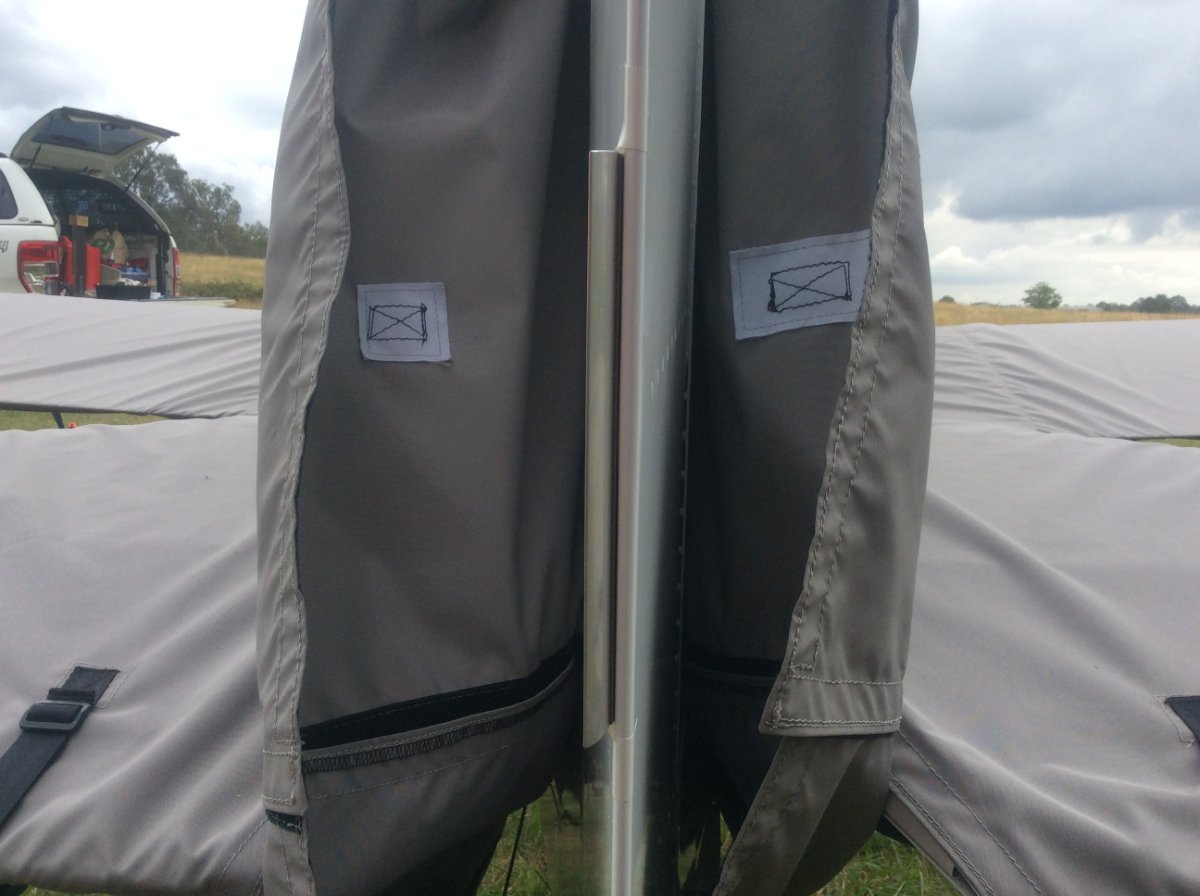

skippydiesel Posted January 14, 2023 Author Posted January 14, 2023 (edited) 19 minutes ago, Kiwi said: Get some of the 6mm door molding trim about 75mm long and stick it in the thrust line on the side you are pushing the rudder. If to much try a shorter piece,  not enough make it longer. Neat idea!  Might be a bit heavy if a long 40mm strip is required.  The aluminium molding/extrusion I have already stuck (double sided tape & white gap tape )in place but not tested, is curve ( . I toyed with he idea of fixing it convex out (as per your door molding) but opted in the end to try concave out . Its 200x30x1.5mm, secured at the mid point on the rudder trailing edge. Edited January 14, 2023 by skippydiesel 1

skippydiesel Posted January 17, 2023 Author Posted January 17, 2023 Test report - Trim worked a little too well. Have removed it , cut in 1/2. Will re fit and try again. 2 1
skippydiesel Posted January 18, 2023 Author Posted January 18, 2023 Mk2 works well BUT as you experienced builder/pilots will know, an adjustment to one control surface will impact on another; Now have a left wing drop - did have the left flap up as far as it would go, to correct an earlier right wing drop. Have now turned left wing flap down by 1/2 turn of control rod end. Hope to test fly, in the cool of the early morning, tomorrow. 1 1
