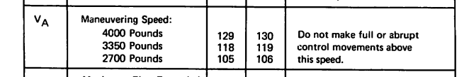

RFguy Posted March 27, 2023 Posted March 27, 2023 (edited) C210 crash : Well, the weather radar/ time/ location of crash has good correlation. Not sure why the pilot did not fly around the storm, if indeed that was the cause. Always slow down to Vmaneuvering in turbulence ! It might be slower than you think if the aircraft is low in weight compared to max weight. According to the (pressurized) P210N POH : (and same in a T(urbo)210N) empty weight abotu 2200, so 210 litres, 2 pax and some luggage and tie downs etc probably 2950 lbs - IE around 111 kts Edited March 27, 2023 by RFguy 1

Old Koreelah Posted March 28, 2023 Posted March 28, 2023 8 hours ago, RFguy said: According to the (pressurized) P210N POH : (and same in a T(urbo)210N) That doesn’t make sense; surely with higher weights, you’d need to reduce the speed in bumpy air?
RFguy Posted March 28, 2023 Posted March 28, 2023 (edited) No. google "FAA definition of Va". FAA defines this as : the airspeed at which the airplane, subject to a sudden control input , or , gust will stall rather than exceeding the design structural limitation / maximum load limit. And more weight on board means higher stall speeds (as usual) . If you fly faster, the wing can produce more lift. IE for Va = 80 kts.....you are flying along at 70 kts and yank the column back to maximum AoA. below Va, the wings dont fall off. you are flying along at 100 kts, and yank the column back to maximum AoA , the wings produce a sh1t ton more lift (2.04x precisely) , you exceed the structural limitation of the aircraft, the wings fall off. The relationship with flying in turb is that you are hit by a gust at some angle which emulates a higher AoA and hence instantaneous lift. bad. See section on Dynamic Gust Loads in https://www.faa.gov/documentLibrary/media/Advisory_Circular/AC_25_341-1.pdf Edited March 28, 2023 by RFguy 1
Old Koreelah Posted March 28, 2023 Posted March 28, 2023 I see, they’re talking about the speed at which your wing no longer lifts, not the speed at which you risk structural damage.
RFguy Posted March 28, 2023 Posted March 28, 2023 (edited) not quite , It is the speed beyond where the the lift produced can damage the aircraft. example: your aircraft is 1250 lbs, and rated for 2G. and.. that the maximum lift AoA is 25 degrees. and it produces 2500 lbs of lift at 56 kts at 25 deg AoA. now, say you are flying along at 5 deg AoA at 56 kts, and the wing is producing 1250 lbs = IE same as your weight, S&L flight. then you yank the control stick back and produce 25 deg of AoA, -- now yoru airspeed is still 56 knots, and now the wing is producing 2500lbs, which is 2x the 1250 lbs weight, - and thus 2G of force - this is the maximum you can tolerate. if you yank the stick back and push the aircraft through the maximum lift AoA, and BEYOND , then the wing goes down the other side of the lift curve in a stall. no bother. So, you survived, the wings didnt fall off . But if you'd been flying S&L at 80 kts, and you yank the control stick back to produce 25 deg AoA, now the wing produces ( 80/56 )squared = 2.04 x as much lift as at 56 kts, now you have 5000 lbs of lift, or 4G. your wings fall off. for a GUST and TURBULANCE - and this is what I didnt first explain - this is for a fictional gust of , if the aircraft gets belted up by a gust, or the pilot applies some control input in resposne, IE hit by a gust causing the aircraft attitude to change its AoA - the aircraft goes from flying S&L to perhaps being steeply pitched up, high AOA- then below Va, this will result in lift being below the maximum that the airframe can tolerate. If it gets hit by a gust etc and the aircraft gets pushed HIGHER than its maximum lift AoA, no bother- the wing will stall - IE beyond the maximum angle on the lift curve - IE putting an upper bound on the lift produced. The same limit can occur if the wind gust vector is such that it produces a high AoA. Like, a gust from under forward of your nose. See section on Dynamic Gust Loads in https://www.faa.gov/documentLibrary/media/Advisory_Circular/AC_25_341-1.pdf Edited March 28, 2023 by RFguy

aro Posted March 28, 2023 Posted March 28, 2023 4 hours ago, Old Koreelah said: That doesn’t make sense; surely with higher weights, you’d need to reduce the speed in bumpy air? If your aircraft has a MTOW of 1000 kg and max load factor of 4g it means the the wings can produce 4000kg of lift. If you stall at 100 knots at 1000kg and 4g, it means that at that speed you can't overstress the wings. However, at 800kg, 100 knots still gives you up to 4000kg of lift, but that is 4000/800 = 5g. The wing still sees 4000kg and is OK, but other parts of the aircraft see the higher loads e.g. seats, baggage compartment floor load limits are based on the same 4g limit and might be damaged. The G load applies to the whole aircraft, not just the wings. 1 1 1
