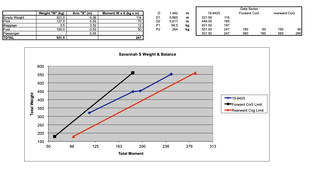

With Mabel being a S model and the battery behind the pilot I wont know until I get it finished but I have put the battery frame in that position but I do no expect the battery to be there. I think mine will be in the front  near the firewall inside the cabin. The reason is Mabel has 20 thou side skins not 16 thou  so it will be heavier in the rear a little bit and its a long moment. I will set it up exactly the same. I will do the W&B and see where it comes to on the chart and most likely set it up to do the same tail on the ground test. I am pretty sure this is the W&B  that I did after I shifted the battery..its close to the tail heavy side
1560059311_ScreenShot2022-06-06at9_51_26pm.thumb.png.9d656c97fd43889c1b62af9d4d633398.png

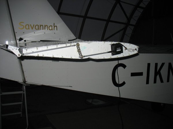

Bob: my trim indicator is a single lighted bar that moves up and down a 10-step “ladder”. I set it so that in cruise, the middle “rung” (sometimes both segments 4 and 5 ) are lit up. I had already changed the offset servo connections to “straight-on“ clevis connections to the push/pull trim control rods on both sides of the horizontal elevator. It required a small repositioning of the servo – see picture (full nose down position shown in attachment).
Keeping in mind the indicator displays the servo ram position and not the actual trim tab position, here’s how I set the indicator:
·       I adjusted for cruise trim in flight then landed without making any more trim changes;
·       I secured the stick in a centered position and measured the trim tab deflection;
·       I pressed the trim rocker switch to move the indicator to the center position, then adjusted the push/pull rod lengths on both sides to achieve the previously measured trim deflection.
Having shared all this, I believe this procedure would actually worsen your situation. Currently, in cruise configuration, you still have 7 “segments” of nose-up trim available. Were you to “center” the indicator to your cruise  configuration you would reduce the “available” nose up trim segments to 5 and consequently require even more backpressure with flaperons engaged.

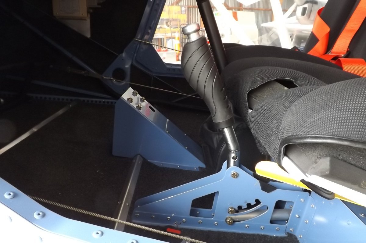

     Like Bob, I have Mark Kyle’s flap lever bracket installed. The original required the lever to be awkwardly pulled into the pilot’s crotch for full flaperons. During a test flight just after completion, my plane suffered a hard landing when the lever “released” during the landing flare (according to the pilot.) I suspect the awkwardness of the original lever contributed to a failure to fully lock in place.  Broke my heart and cost lots in terms of time and money for repairs.   I try not to look at those photos.
I found with full flaperons  (even with Mark’s 4-position bracket) I was uncomfortable with reduced rudder / elevator authority. Perhaps with experience and practice I will grow into that configuration, but for the time being, I’m happy with longer strips and 45 – 50 mph touchdowns.
Hi Mark, and thank you for your detailed input. This is all really good info.

Also, I initially had trouble with the full flaps lever position, as you mention: the angle was all wrong, and setting and releasing it was clumsy and difficult. In the upshot, I designed an angled lever that works very well. It is simple, but needs to be fabricated quite precisely. I was fortunate to have a very capable fitter do the required cutting and welding of the outer tube.

Bob has my flap bracket which you can see in his last picture...the full flap position is exactly the same for flap angle as the original. The geometry I made it so that it has the same travel but its all at th different angle. Then of course I the extra position. The first stage of flap with my bracket is about 1/3 of the full range and the second stage is about 2/3 of the range.
I found I use the first position for pretty much everything. The second position was for when I wanted shorter landings and pretty much never used the original full flap position as it was too aggressive especially if it was a bit windy. At full flap when its windy the Sav tends to waffle quite a bit as Don says so the repositioning really makes a difference on landings
