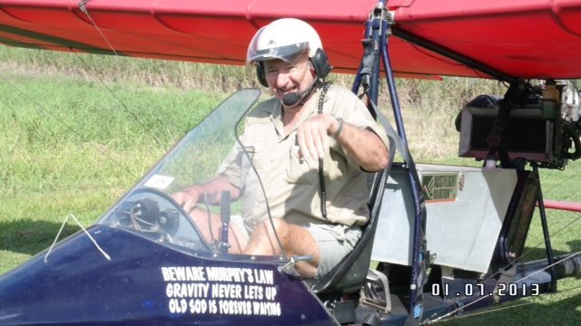

farri Posted February 16, 2022 Posted February 16, 2022 On 07/02/2022 at 6:17 PM, phlegm said: Hi all, Thinking about taking the plunge into aircraft ownership, but not sure how practical it would be given my size. I'm about 6'2" and 105kg, but could probably lose a bit of weight if I need to for the right aircraft. Would I fit in a Drifter or Thruster? Cheers. Hi phlegm, This is Ron Biondi! he`s probably a bit bigger than you and his aircraft was the 95-10 registered version of the Drifter... Ron began flying his Drifter around 1982 right up until retiring from flying a couple of years ago at 90 years of age. Keep in mind that when thinking about the Drifter, there are several different versions. Franco, Ps, I took the photo! Ron would come to see me, land on the strip then Taxi up to the house. 2
