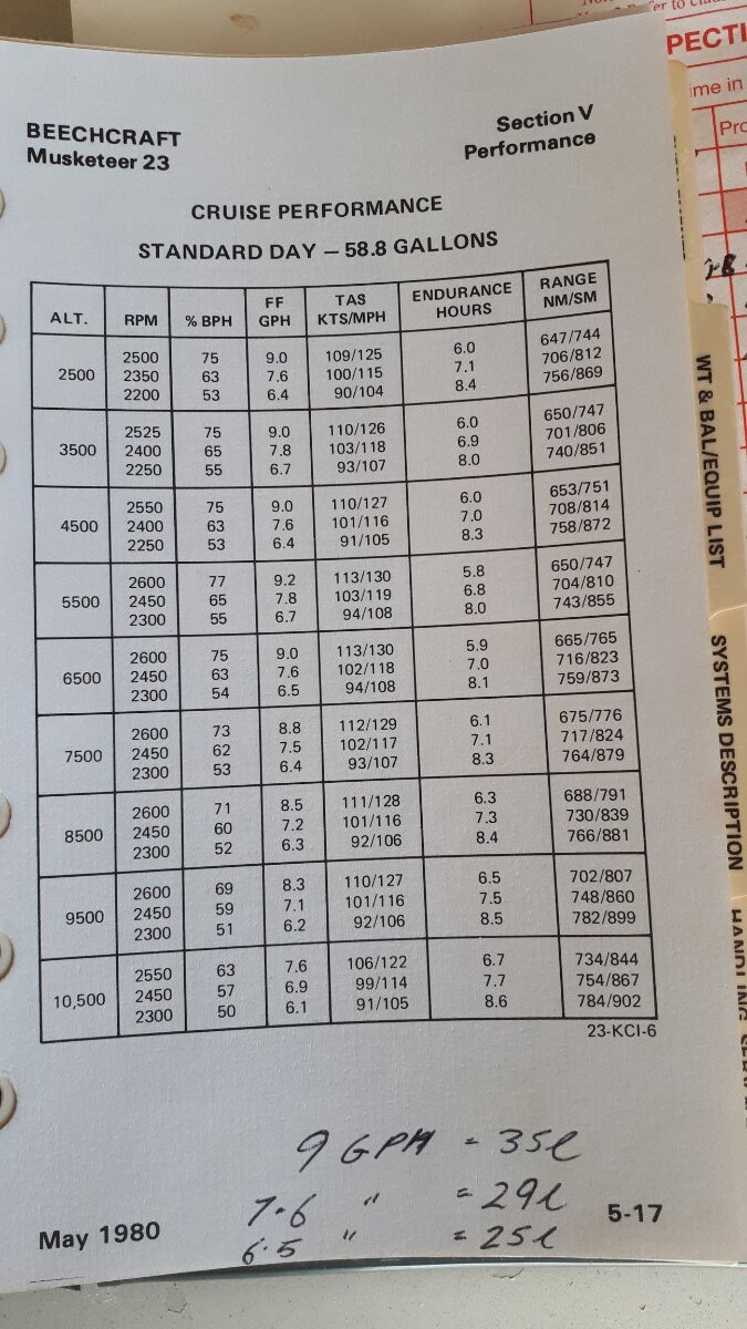

you also have to remember that for most aircraft powered by a Rotax 6500 feet is the ideal altitude for performance. Once you go above this than the power from the engine drops off and the propeller loses some efficiency due to the  thin air. There was an EAA seminar online about exactly this. I will see if I can find the details
ALL normally aspirated Pistons lose power with higher altitude. MP Manifold pressure is LOWER and if the mixture is right the fuel flow will be lower also. Prop drag at the same revs is lower too because the air is less dense. and the IAS will be below TAS by  a bigger margin. The cruising pitch attitude will be more nose up the higher you go.  Somewhere in there will be the best L/D figure for your plane for range.  ie where you get best Ground NM/ LITRE  of fuel. Wind velocity will come into that also. Nev
This performance charts shows how increasing altitude affects,  propeller rpm required for a given % of power, range at a given power setting,  true airspeed, fuel flow required for a given power setting.
This aircraft runs about half the rpm of the geared 912 but the % changes would be very similar because they fly in the same air. Fixed pitch prop.
There is a slight gain in efficiency and maximum range with altitude. Speed has the greatest effect.

Thruster 88. If we said 5500 rpm @ 2000' was 75% power then 5500rpm @ 6500 would be 67% power. Fuel flow of 20lph @2000 should reduce to 18.4lph @ 6500. I agree the carburetor is running richer with altitude negating the normal small gain in efficiency that a mixture control aircraft will achieve.
