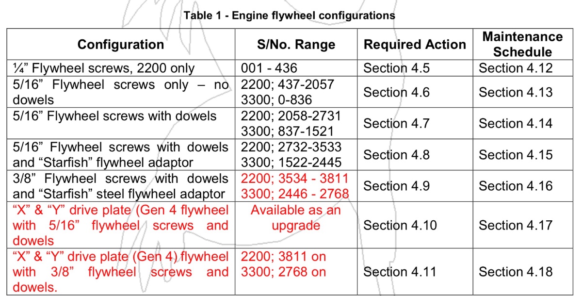

RFguy Posted September 13, 2021 Posted September 13, 2021 (edited) I have a good softstart kit sorted. and simple . but its using a part I only had one off and more are 6-10 weeks away, I will buy more. BRUCE- BTW the engine in my aircraft a 2010 J230D, was replaced in 2013 with the new last gen3 I have now (that I also rebuilt) you know why they had to replace it - in the field, flying, the flywheel fell of in flight...... they landed on a road (they were flying along) out western QLD without issue. Edited September 13, 2021 by RFguy 1
facthunter Posted September 14, 2021 Posted September 14, 2021 It would have made considerable noise and probably vibration before that happened. Always investigate anything unusual. Engines never fix themselves. I've heard flywheels loose on cars and you can't miss it admitted they are heavier and more of a clunk With the prop on one end and a flywheel on the other it's not an ideal set up .Nev
