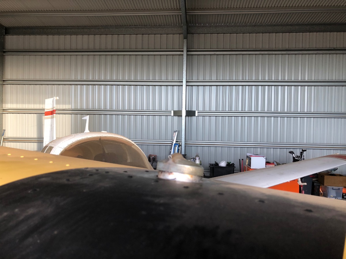

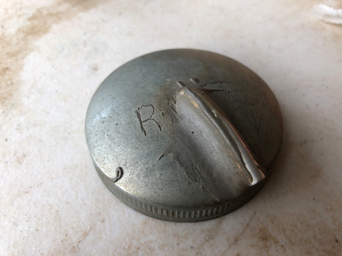

NT5224 Posted July 28, 2021 Posted July 28, 2021 Ladies and gents of the brains trust. Seeking some insight Many aircraft that don't actively pump fuel to the motor have vented fuel tanks to ensure air pressure is on the side of gravity in ensuring a smooth fuel flow. My fuel caps have a little forward facing tube bent through 90 degrees. I'm guessing that by facing them into the direction of airflow the intent is to prevent rain dropping in but more importantly to force air in and actively pressurise the fuel tanks to improve fuel flow. I run my electric fuel pump on take-off and landings and at full power but tend to switch it off in cruise. What would happen if I replaced my forward facing vent fuel caps with regular vented caps (just a hole in the top)? Is there much difference? Has anybody else tried this? Just curious in case I need to change caps or carry spares... Cheers Alan

NT5224 Posted July 29, 2021 Author Posted July 29, 2021 Thanks for the discussion folks but no clear response to my question. Switching from forward facing air vents to just open top ones, will that effect my fuel flow? Cheers Alan
onetrack Posted July 29, 2021 Posted July 29, 2021 Alan, having open top tank vents at right angles to the airflow, would just create a venturi effect at flying air speeds, and suck fuel out of the tanks - and it would also create a vacuum in the tanks.
Markdun Posted July 29, 2021 Posted July 29, 2021 Alan, no it won’t, unless you have gravity feed, ie. no mech pump.
skippydiesel Posted July 29, 2021 Posted July 29, 2021 2 hours ago, NT5224 said: Thanks for the discussion folks but no clear response to my question. Switching from forward facing air vents to just open top ones, will that effect my fuel flow? Cheers Alan Probably not BUT as I said erlier you can have a positive pressure in your tank without exposing your system to the possibility of water egress. Just plumb your breather (s) into a high pressure area (underside of your fuselage/wing/wherever. 1
NT5224 Posted July 29, 2021 Author Posted July 29, 2021 OK, so reading comments above that's a 'yes', a 'no' and a 'maybe'. Plenty to work with. 🤣 But One Tracks point about the Venturi effect makes sense. Does that mean that all aircraft with upward vented fuel caps have mechanical fuel pumps? I'll take from this that with my gravity fuel system I need to stick with forward facing vents which pressurise my tanks and boost fuel flow... Thanks fellas! Alan 1
