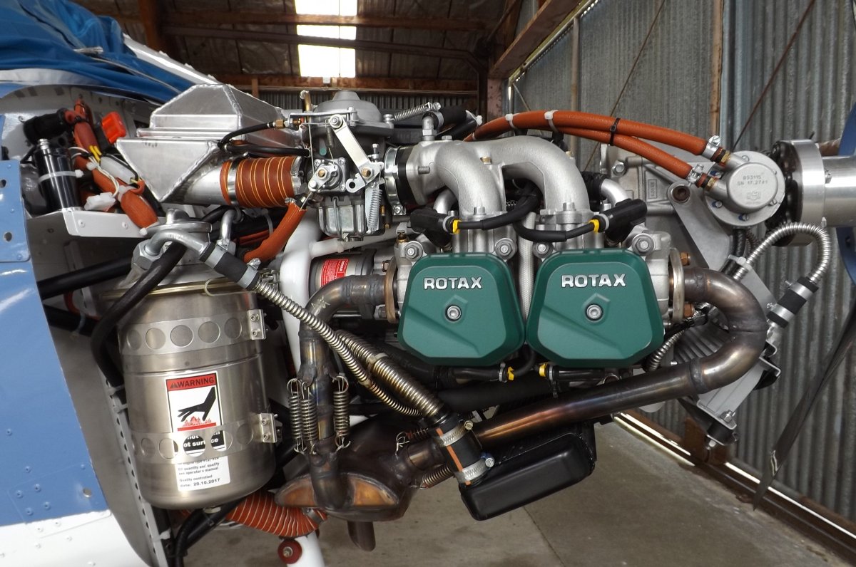

skippydiesel Posted May 25, 2021 Posted May 25, 2021 (edited) Just guessing but you may have a damaged high tension (HT) lead. By securing the lead(s) in place with the home made "square" grommet you may have reduced/eliminated arcing at a break. Just a thought! Edited May 25, 2021 by skippydiesel
IBob Posted May 25, 2021 Author Posted May 25, 2021 That's certainly a possibility, Skippy. Unfortunately, since what I was trying to locate (radio interference cause) was something quite different to what I now have (smoother 'mag' check at 3000RPM) I wasn't focused on the latter. So I can't be absolutely sure now, but it seemed to me that rough running occurred with either 'mag'. Had it been notably one 'mag', I'd have gone looking for the cause.

IBob Posted May 25, 2021 Author Posted May 25, 2021 (edited) Interesting idea, RFguy, that's for sure. My 912 has run faultlessly since new, so I'm not actually looking for any sort of ignition problems. I'm just a bit surprised, now I'm focused on it, that there is nothing much to prevent the leads to the lower plugs from making contact with the metal of the cylinder heads. As you can see here, they are threaded through some sort of (heatproof?) white sheathing that just floats between the heads. All I did (at this stage) was pull off all the plug caps....and they were all tight.....put them back on, make and fit a couple of square grommets to hold the lower leads centred where they go down between the cylinders, and replace/adjust some cable ties on both upper and lower leads to try and ensure no contact with engine metal. (These are older pics, so not shown here). Edited May 25, 2021 by IBob

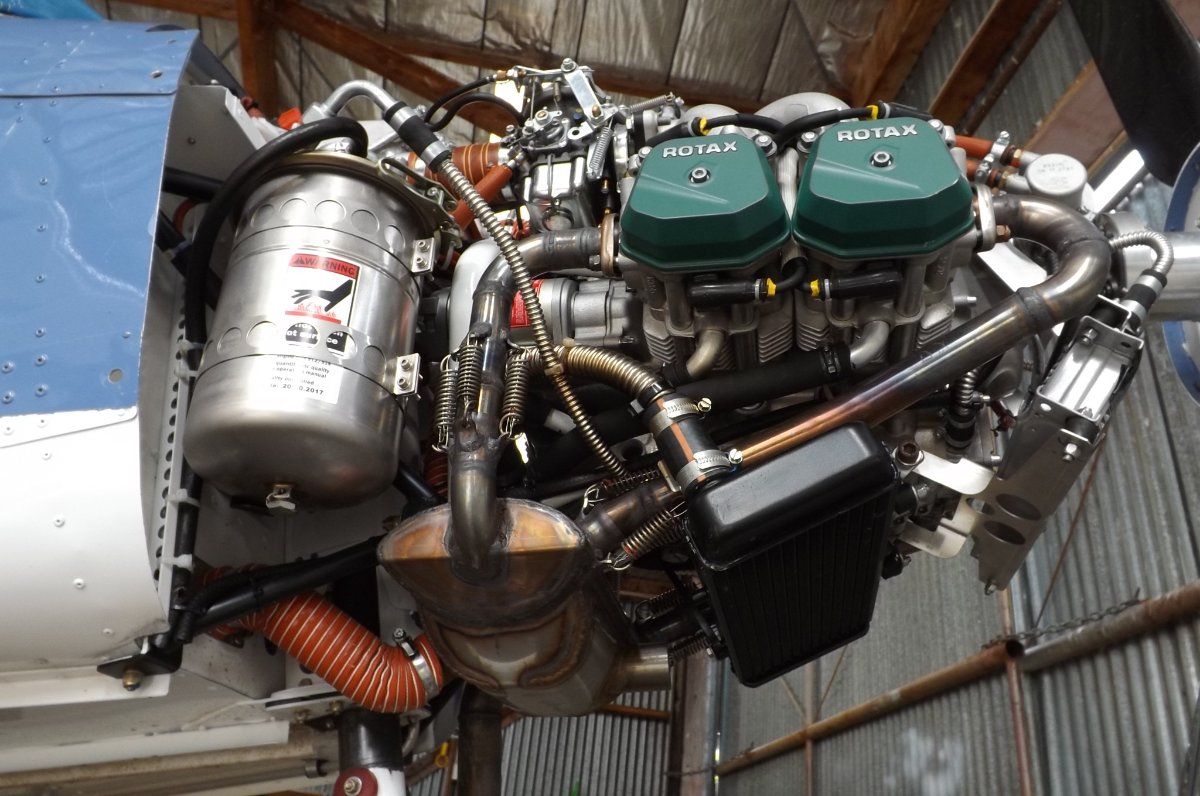

skippydiesel Posted May 25, 2021 Posted May 25, 2021 IBob - congratulations on what looks to be a very nice/clean set up. Questions: Its a bit hard to see but why such a big oil cooler? It looks like you have used some form of "corrugated" metal hose for part of the radiator cooling system - please give your rational ? product name? supplier? Whats with the cut down muffler ?
IBob Posted May 25, 2021 Author Posted May 25, 2021 Skippy, what you see there is (or was) all standard ICP Savannah issue. The lower black radiator is coolant. The upper silver radiator is oil. Both these radiators hold the temps within specs within the ICP cowl design. I do blank off part of the oil radiator in winter, but all the radiator is required in summer. The metal hose also came with the kit. It's used for oil, coolant and parts of the fuel system. I know there is some debate about it, but I figured if it was failing in use we'd have heard about it. The downside (as used here) is that it requires a short piece of 'rubber' hose and two hose clips to terminate it. The upside is that it is very compact and can be hand formed into quite tight bends without any flattening or collapsing. At the engine, it allowed a very compact installation, especially for the larger 'hoses': I had heard the cowls were a tight fit, but this wasn't the case at all. The muffler is also ICP. It's compact and does the job, but various others have suggested it is a poor design, potentially reducing engine power. Also the muffler and downpipes don't fit together as neatly as they might, and a very competent LAME who took a look at it here made some scathing comments about the setup. I believe ICP may be working on a new design.
IBob Posted May 25, 2021 Author Posted May 25, 2021 As for the installation, I went through a heap of cable ties, running and rerunning stuff until I was happy with how it all sits. It took a while. A lot of where to run the various bits, and just how to secure them at various points against vibration and chafing, came from studying pics provided by the (Australian) agent who supplied the kit. I found these invaluable in all sorts of ways as the build proceeded. I would encourage anyone building to source as many pics as they can to reference this sort of thing. In my case, I had an old laptop in the workshop, allowing me to view the agent's pics, also access pics on the site and other places.
skippydiesel Posted May 25, 2021 Posted May 25, 2021 Thanks for all that IBob. For the same engine (Rotax 912 ULS) I find it quite intriguing that there are so many variations on installation/fit out eg your oil cooler looks to be almost three times the size of the one fitted to my aircraft. Yours is in a forward position directly in the air blast from the prop. Mine is mounted low on the firewall/engine bulkhead, in the exit airflow from the cowling - works perfectly. Your coolant radiator looks to be the same size as mine but is mounted at an extreme angle to what I would imagine the air flow (in /out) to be.
