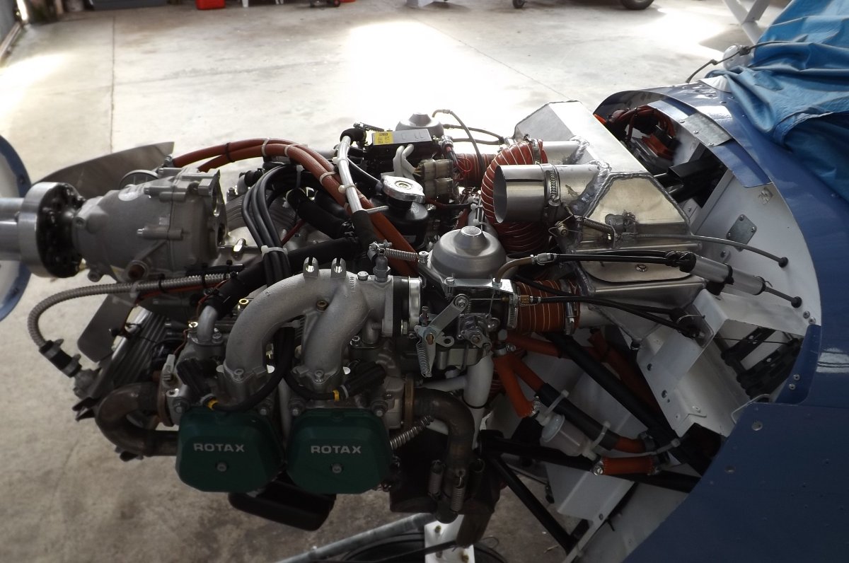

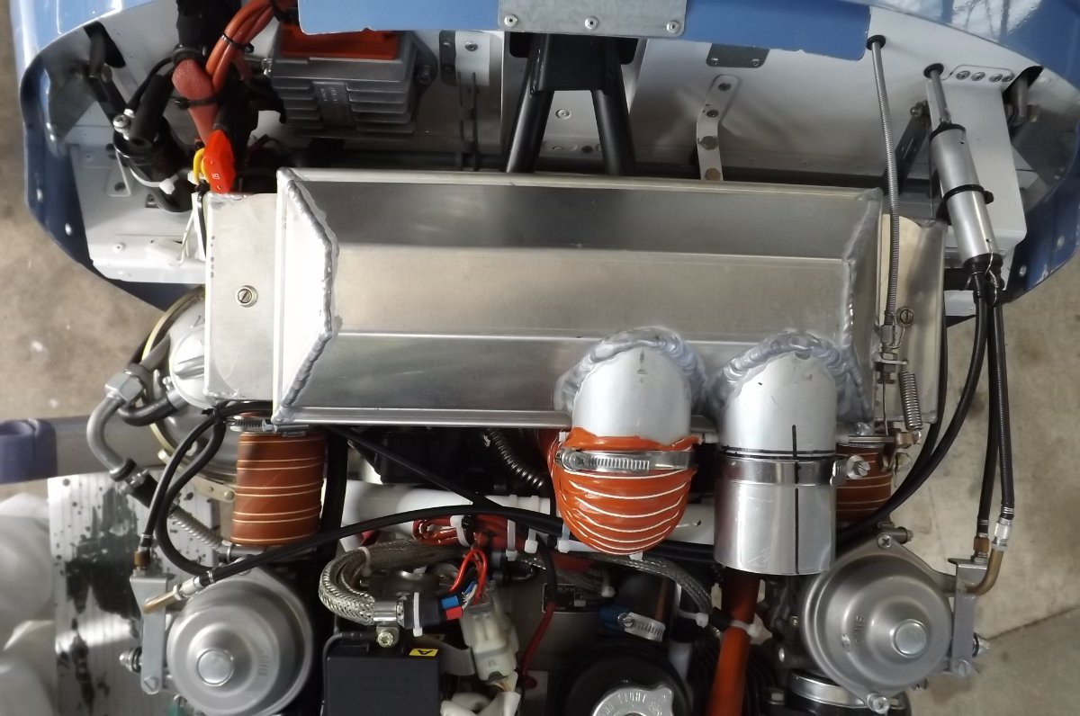

IBob Posted March 11, 2021 Posted March 11, 2021 As a side comment here, the Savannah, which has an air box with temperature probe, has a NACA scoop in the cowl top for cold air. This works fine in normal flight, but not so much in a hard climb, where I was seeing rising airbox temperatures indicating that air was being drawn from under the cowl via the 30mm gap between cowl scoop and airbox inlet. I was able to correct this with a simple aluminium extension clamped to the airbox inlet (while still leaving a small gap to drain rainwater while parked). 1 1

skippydiesel Posted March 11, 2021 Author Posted March 11, 2021 2 hours ago, IBob said: As a side comment here, the Savannah, which has an air box with temperature probe, has a NACA scoop in the cowl top for cold air. This works fine in normal flight, but not so much in a hard climb, where I was seeing rising airbox temperatures indicating that air was being drawn from under the cowl via the 30mm gap between cowl scoop and airbox inlet. I was able to correct this with a simple aluminium extension clamped to the airbox inlet (while still leaving a small gap to drain rainwater while parked). Nice set up ! - Do you have carbie heat ? Can we see some more photos - from each side, cowl on showing air scoop/inlet - inside of cowl to see air delivery set up
IBob Posted March 11, 2021 Posted March 11, 2021 30 minutes ago, skippydiesel said: Nice set up ! - Do you have carbie heat ? Can we see some more photos - from each side, cowl on showing air scoop/inlet - inside of cowl to see air delivery set up Hi Skippy, yes the Savannah has carbie heat (or more accurately, warm air to the carbs). The rectangular aluminium box you see there is the air box, with air filter. The inlet tube to the right aligns with the NACA scoop in the cowl, and as you can see in the second pic, I have extended it by attaching a sheet aluminium tube with a hose clip. The inlet tube to the left, with the scat tube attached in the second pic, is the warm air, collected from behind the engine muffler. These two inlet tubes have butterfly valves in them, 90deg out on the same pivot, so when one is open the other is closed. You can see them in the first pic. It works fine, with a little attention paid initially to the moving parts to get positive valve action. It doesn't deliver super hot air and the collection point below does need positioning to maximise that. Also the temp sensor in the airbox has some thermal mass and is quite slow to respond, which is fine once you get used to it: you get warm air straight away (provided the muffler is hot) but it doesn't show up immediately on the temp gauge. I don't notice a big difference in engine power with and without. I don't have any pics looking down on the cowl. You can just make out the NACA scoop on the top of the unpainted cowl in the first pic here. The second pic shows a side view of the insides.
