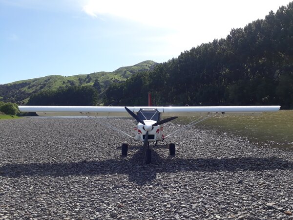

fallowdeer Posted February 1, 2021 Posted February 1, 2021 Hi there. I’ve put 700hrs on my VG. It carries a factory data plate with 560kg MTOW, 312 empty with larger tyres. Mark is right, can’t be upgraded to 600. Very capable strip aircraft, at lighter weights (I call light less than 450kg) happily get into a few strips/gravel bars that have a total usable length of 120m, some one way with no go around, but I wouldn’t want to try getting out at 560kg. Peter 1
