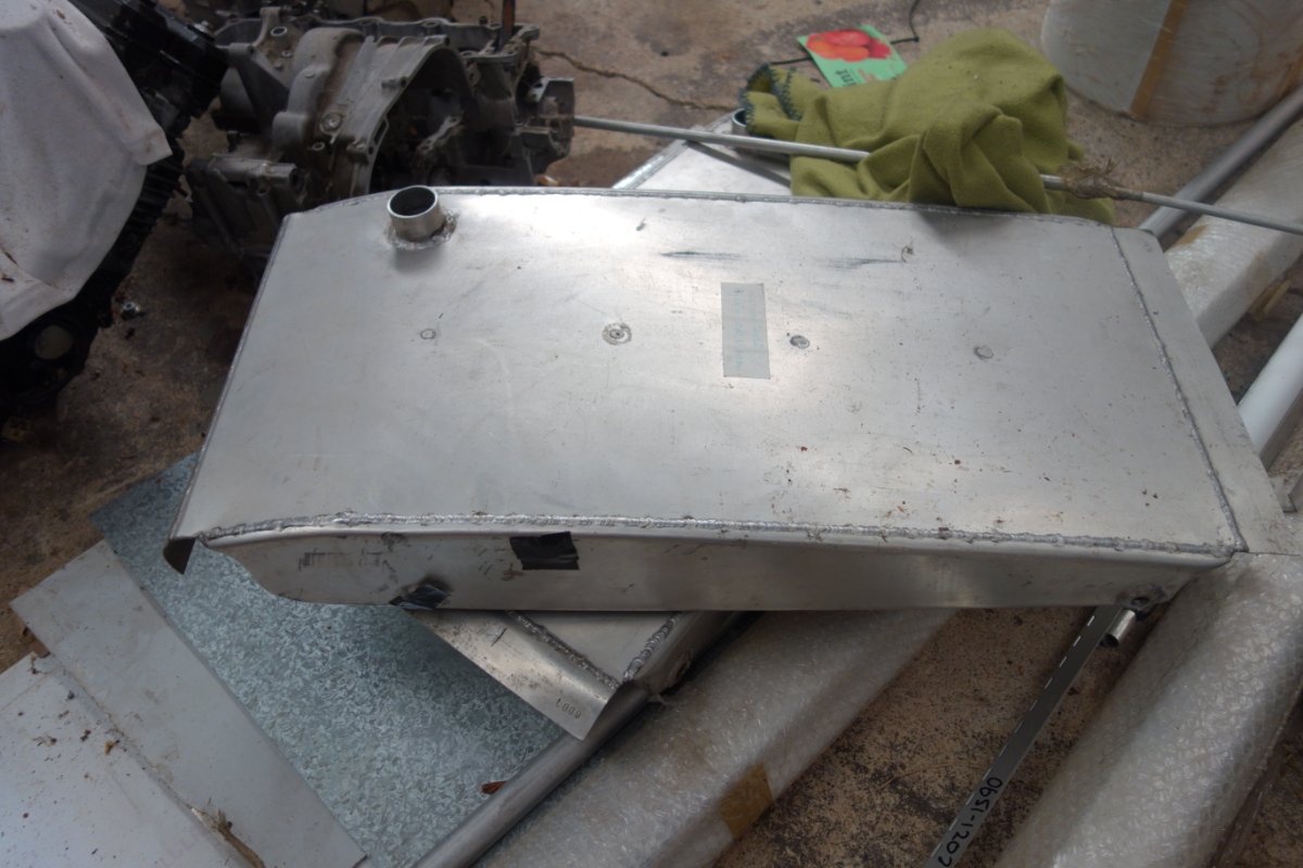

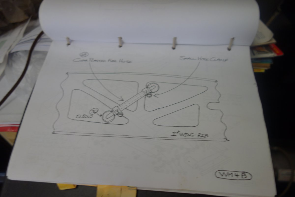

Hi, Mine came with premade tanks and looking at the wing root side, they have bosses welded in for the sight glass.  Sketch SM7 shows the sight glass.

Yes my kit is a 4 as well.  It's 20 years old!  I'm missing a fair bit of the wings, but I'm working on the parts.   The tanks are fabricated from aluminium, and the caps have the breather.  I wouldn't face them any way other than forward.  Faced rearward they would create a vacuum.  A filter may cause more problems than it solves.  I would leave them as is.

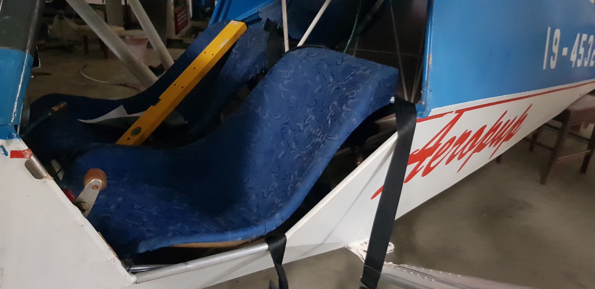

Thanks for the info and pics. Will track down a local Aeropup and have a look but at first glance the Aeropup seats do not match the drawings in the Supa Pup builders manual.
