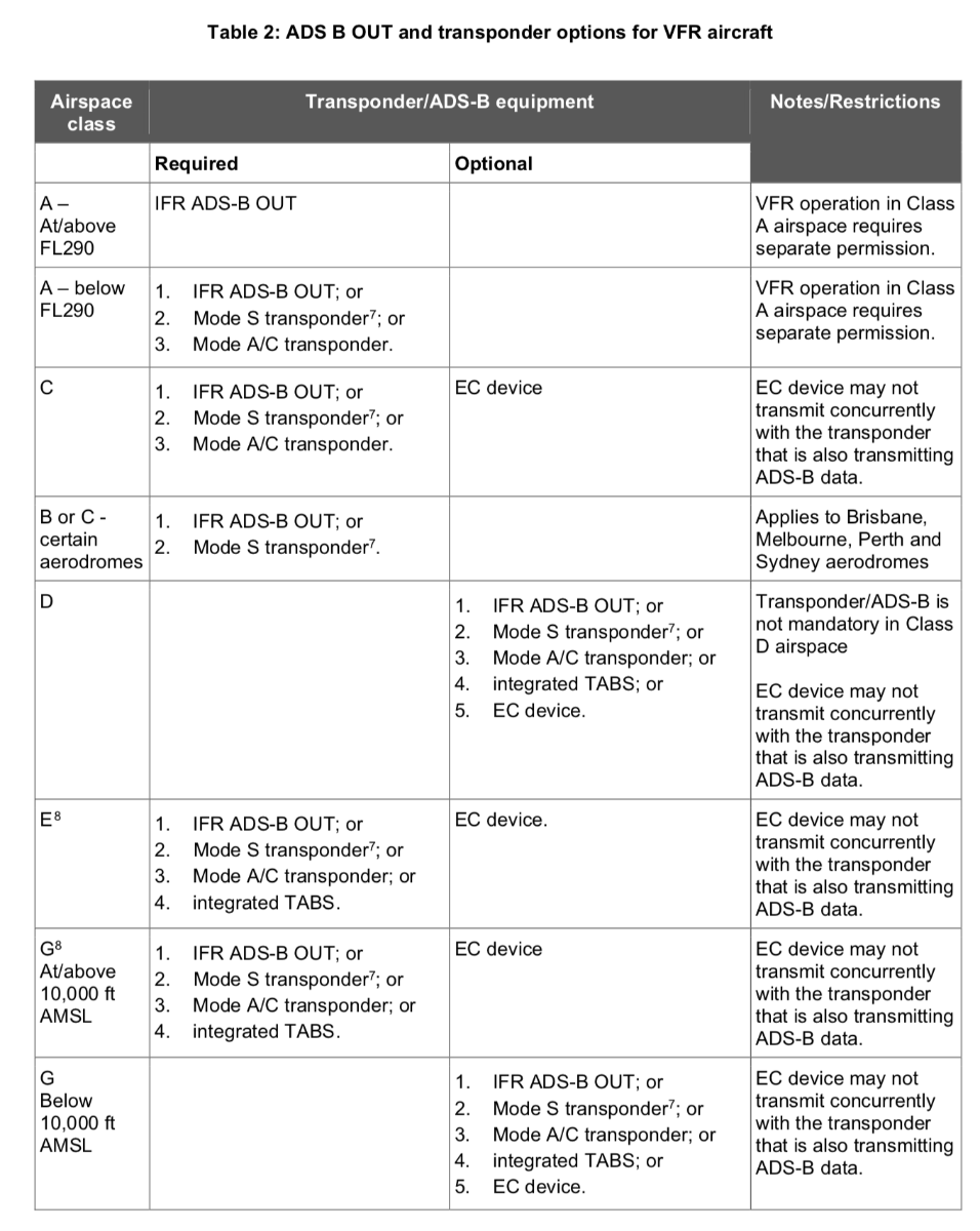

Garfly Posted January 22, 2021 Posted January 22, 2021 (edited) CASA ADVISORY CIRCULAR AC 91-23 v1.0 ADS-B for enhancing situational awareness 5.3 VFR aircraft – a rule of thumb 5.3.1 For aircraft operated to the VFR, a general rule of thumb is that a Mode A/C or Mode S transponder is required for operations in Class C airspace, Class E airspace and above 10 000 ft AMSL in Class G airspace. 5.4 VFR aircraft – in more detail 5.4.1 Table 2 provides more detail about ADS-B OUT and transponder requirements for each airspace class as well as the optional capabilities for using ADS-B OUT equipment to enhance situational awareness (or 'BE SEEN') electronic conspicuity. 5.4.2 Owners and operators of VFR aircraft should be mindful that lower cost, lower performance ADS-B OUT equipment (e.g. EC device and integrated TABS device) is primarily intended for air-to-air situational awareness in non-controlled airspace. Apart from an integrated TABS device able to substitute for a transponder in Class E & G airspace, lower cost options are not intended to overcome any existing requirement to carry a transponder, in any class of airspace. advisory-circular-91-23-ads-b-enhancing-situational-awareness.pdf Edited January 22, 2021 by Garfly 1
horsefeathers Posted January 22, 2021 Posted January 22, 2021 (edited) Sky Echo is optional in class E, but it is required to have ; 1. IFR ADS-B OUT; or 2. Mode S transponder7; or 3. Mode A/C transponder; or 4. integrated TABS. So it seems RAA without a transponder is limited to 1500 ft Edited January 22, 2021 by horsefeathers 1
Garfly Posted January 22, 2021 Posted January 22, 2021 5 minutes ago, horsefeathers said: Garfly, does this table supersede the Conditions of Use letter from Sky Echo? If so, am i am correct in assuming that using Sky Echo will allow RAA access to the lowered E class airspace altitude? Yes, I believe so. (Or, in CASA's terms the former's simply 'more detailed' than the latter'. 😉 It seems now clear that CASA had their reasons for cooperating with device manufacturers to facilitate all this. But a down side for the professional industry is that if all recreational aircraft start transmitting their ADSB data then the airwaves are going to get cluttered. This would be less of a problem in Oz, of course, than in the UK or the US. Anyway all this has been well covered in previous threads on this site. (Luckily we have, among us, some avionics geeks who have the low-down.) But now, suddenly, it seems we all need to pay attention. 1
Garfly Posted January 22, 2021 Posted January 22, 2021 12 minutes ago, horsefeathers said: Sky Echo is optional in class E, but it is required to have ; 1. IFR ADS-B OUT; or 2. Mode S transponder7; or 3. Mode A/C transponder; or 4. integrated TABS. So it seems RAA without a transponder is limited to 1500 ft I believe that you are misreading the table. To me, it means that in Class E one of those four things is required. I understand that SkyEcho is an Integrated Tabs. Anyway, you can just go by the plain language statement: "Apart from an integrated TABS device able to substitute for a transponder in Class E & G airspace,"
horsefeathers Posted January 22, 2021 Posted January 22, 2021 Well, I hope to be corrected, but I have always understood that the SkyEcho is only an EC device. 1

Garfly Posted January 22, 2021 Posted January 22, 2021 14 minutes ago, horsefeathers said: Well, I hope to be corrected, but I have always understood that the SkyEcho is only an EC device. Well, Mark Kyle put us all at rest on this subject last year, right. I take it that the SkyEcho is indeed an EC device but an Integrated TABS type.
