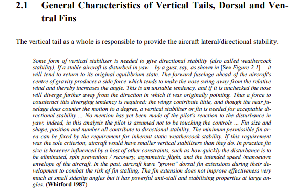

old man emu Posted January 12, 2021 Author Posted January 12, 2021 Wouldn't small tails make lessen the aircraft's stability around the yawing axis, which would give better maneuverability is combat? Here's a quote from this research paper: https://www.fzt.haw-hamburg.de/pers/Scholz/Aero/AERO_TN_TailSizing_13-04-15.pdf 1
kasper Posted January 12, 2021 Posted January 12, 2021 3 minutes ago, old man emu said: Wouldn't small tails make lessen the aircraft's stability around the yawing axis, which would give better maneuverability is combat? Beat me to it. Civil aircraft after WWII had to be - to get past certification - benign in handling. This meant that 1. design stability increased (larger fixed area of control surfaces) 2. control authority decreased (smaller deflections and/or smaller control surfaces) 3. cointrol force through cockpit controls had required force gradients (more deflection = more force required) All of that leads to larger tails and arguably boring aircraft (try flying a Pitts when you are only used to a cessna 172 ...) All of this design requirements feeds into other aspects of modern flying - you cannot use full deflection on controls over your ref speed or you risk tearing the aircraft apart - you have over a drink discussions (or forum chat) on the perils of former military pilots flying civil aircraft where in an emergency they may revert to trained behaviours of full deflection which is possible and trained for in miltary but can tear your plane apart in civil flight

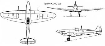

old man emu Posted January 12, 2021 Author Posted January 12, 2021 Compare fin sizes: WWII training aircraft WWll fighter 1
APenNameAndThatA Posted January 12, 2021 Posted January 12, 2021 3 hours ago, old man emu said: Wouldn't small tails make lessen the aircraft's stability around the yawing axis, which would give better maneuverability is combat? Here's a quote from this research paper: https://www.fzt.haw-hamburg.de/pers/Scholz/Aero/AERO_TN_TailSizing_13-04-15.pdf In the case of the tail, decreased stability would not help in maneuverability. It would decease ability to maintain co-ordinated flight with rapid turns. When maneuvering aircraft vigorously, rudder input is *increased*, so you need an effective rudder. It would not make adverse roll and Dutch roll worse. It would make the aircraft less stable, which would make it less useful as a gun platform. This issue is different with dihedral, where stability acts against the ability to roll the aircraft. 1 1
